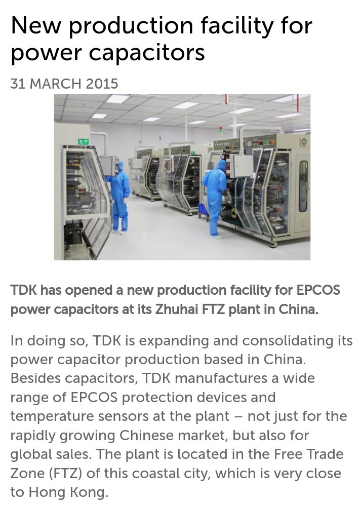

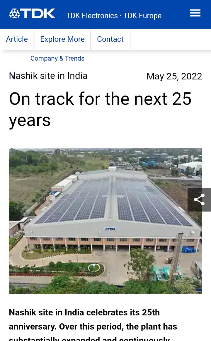

TDK/EPCOS factories in China and India, two of 20 or so they have in the region:

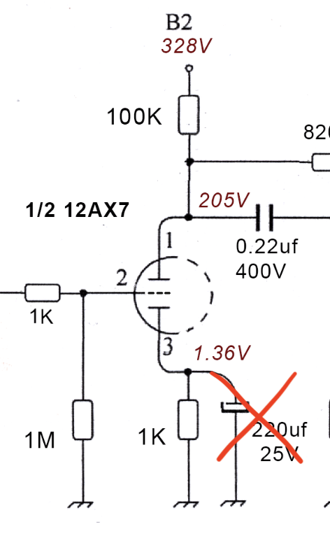

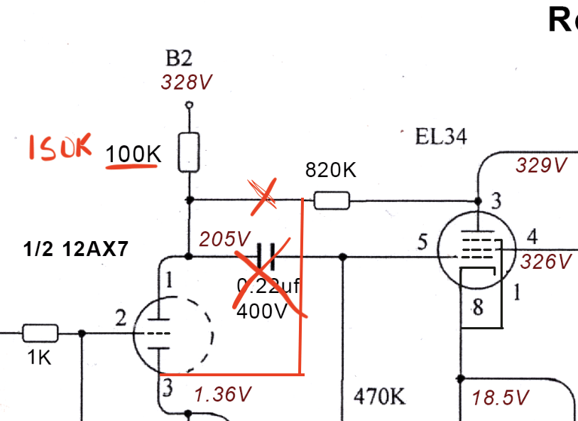

@Chris Hornbeck , just to make sure, you are saying is to do smt like this?If I were to attempt a simple mod of the design, I'd remove the driver stage's cathode bypass cap, and probably increase the anode load resistor to 150K or so, but a more effective change would need for feedback application to be moved from the driving valve's anode to its cathode. Not trivial because DC conditions change (current from the feedback resistor significantly effects driver bias) and also not as well focused (existing feedback path puts it at exactly the best place, around the output valve).

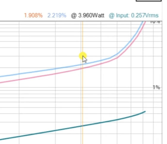

Distortion messures (performed by Stephe) where really good as it is now, lower than 2% at 4W:

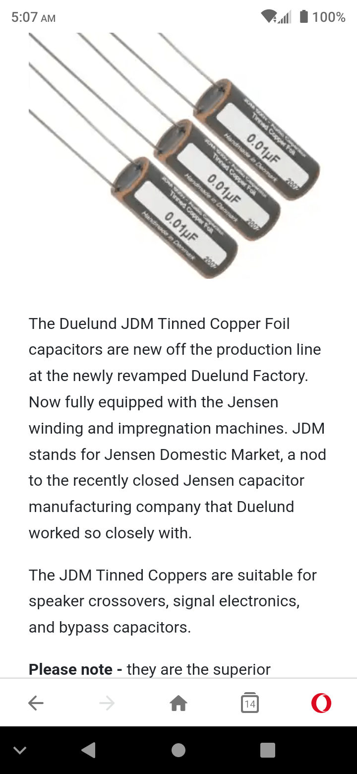

****. I actually bought a JDM 0.1uf Pure Copper (not Tinned) to bypass the coupling cap. It was "cheap" enough to give it a try...I wouldn't, given the end results, but hey, what do I know? 🙄

I do need to add to my last comments that I also bought a Jantzen Superior Z 0.1uf 1200V (they don't come at 630 or 400V) for bypassing the output bypass cap. I read somewhere that it's a must (literally) to bypass the output bypass electrolytics (also got the ELNA's ROA Cerafine for replacing actuals) with some Polyxxx ones.and Stop Compulsing! It's bad for your health.

Sorry @Chris Hornbeck . On my previous schematic picture I crossed out the coupling cap by mistake 🤦♂️, but I got what you meant. Removing this bypass cap:

That 220uF is upping the gain for you above the very low bass.this bypass cap
It's harmless to try the sound without it.
To replace, use a lowESR replacement of a reasonable (branded) make, and bypass with a film cap, from 56n to 1000nF should be fine, it really just has to act as a low impedance AC path.

Shunt feedback around the output stage has become popular because it's applied at the exact best location, and is fairly forgiving in the normal small quantities, but isn't ideal because it must penalize the driving stage (by heavy loading) to benefit the output stage. Tradeoffs.
Bringing the feedback further back, to the driver's cathode, removes the loading penalty and keeps the advantage of lowered source impedance to the OPT and the resulting transformer performance advantages (both distortion and frequency response) of the shunt (I refuse to call it "Schade" - it's not his fault) feedback, voltage sensing negative feedback at the primary, for lower transformer distortion and better frequency response (less effect of both lumped leakage inductance and lumped winding capacitances).
But! We can't just move the feedback resistor to the cathode - it conducts DC and so changes the driving valve's bias. Resistor values need to be juggled to get everything optimum. Not rocket surgery, but definitely a thing.

I'm guessing here is that the pictures I posted show the correct thing, but I'd have to play around with values for the feedback resistor. It was mentioned that 820k was maybe to high, smt around the 400's?
