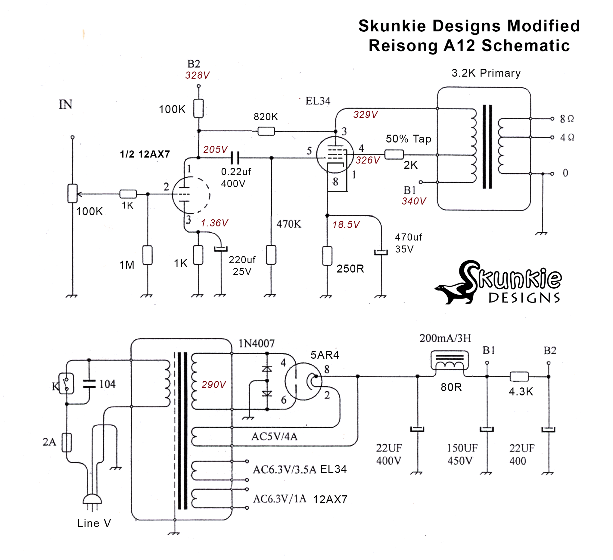

In the Real World: a coupling cap has a very simple job: to block DC and let Audio through.
Typically sized to have almost zero impedance compared to load, within the Audio band, (say they come from a 100k plate and go into a 1M grid) so no Audio voltage drop across, almost undetectable current through them, WHAT bad (or good) can they do to Audio?
They will CERTAINLY not improve a bad amp, that would be pure Magic or suggestion.
Nobody said the problem with your amp comes from a bad coupling capacitor, the most unlikely component.

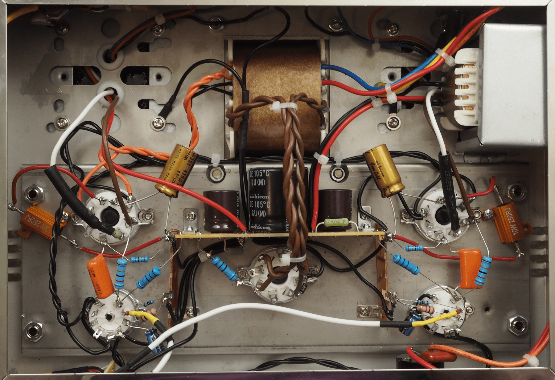

@baudouin0 the schematics are these (after doing Skunkie's mods). Attaching a photo as well. The orange coupling caps are the ones that I'm asking about. Both cathode bypass caps already decided to go with AN Kaisei for driver stage and Elna Cerafine for output.
Stephe has already done a great job bettering the sound, but I want to upgrade some components as they are all factory/low quality ones I have in there. But any further consideration would be appreciated.
