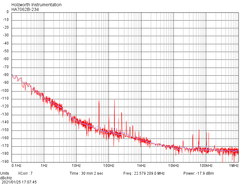

Regarding phase noise in dac clocks, here is a plot from one of my clocks in use today:
