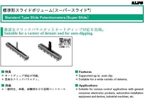

Cheap fader?
Where do you see that?

lohk said:Cheap fader?
this pot looks like that on picture below. This is a low budget ALPS pot very often installed in small budget audio consoles.
In 2000€ amp I expect something better (like this one: http://www.pennyandgiles.com/docGallery/76.PDF or similar)

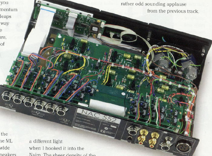

I remember reading Stereophile review of $6,000 Nagra preamp and it was mentioned that cheap plastic pot was used because it sounded good.
Also, GBP12,000 Naim preamp seem to sport cheap Alps (motorized) pots. All those internal wiring doesn't look that great either😉

I'm not so sure about the quality of the stuff inside...but I'm darn sure if I were to do it using the same box...I would've done it P2P...plus it looks neater too...
The solder joints look terrible. Assuming normal PCB, they look like done by an absolute beginner, using worst soldering iron. It is hard to believe that they can not do better. However, this is apparently the case with any 47Lab amp (if I am allowed to, regardless of the official denial, speak about the pictures that appeared two years ago like they show the gut of the real GainCard). So, what can be the reason? Is that board normal? Maybe the copper is thicker than usually?
