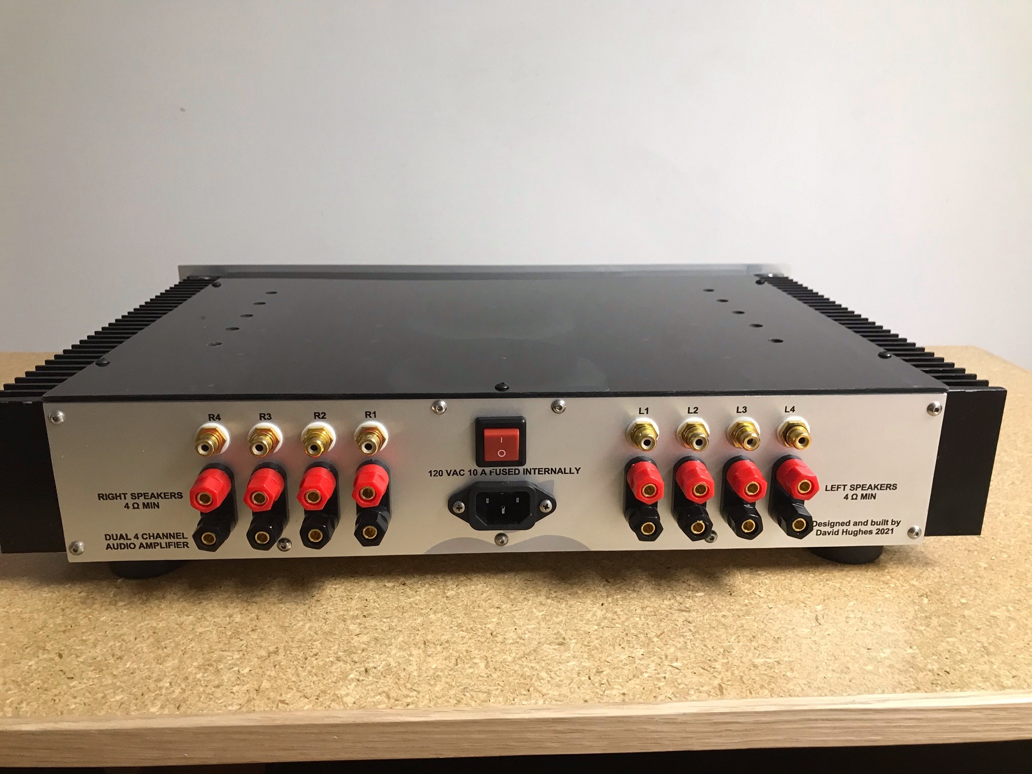

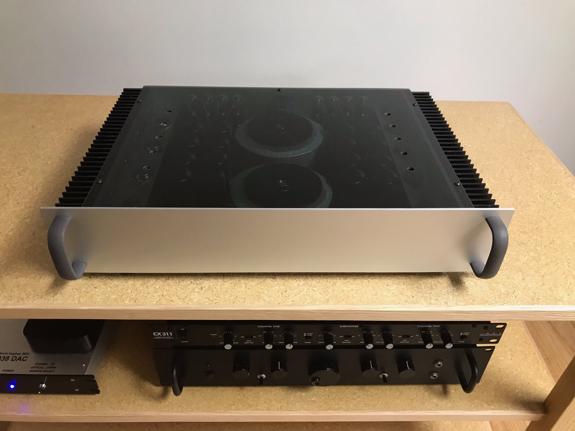

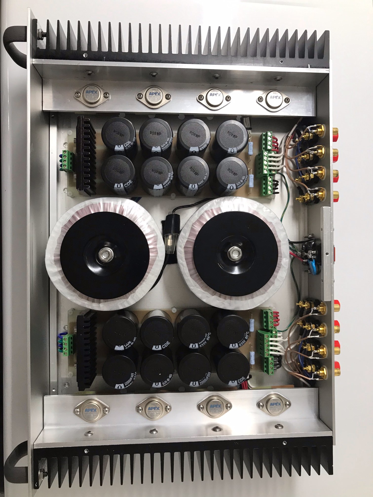

I build my own chassis so I prefer external heat sinks because they become the structural sides, as the OP mentioned in his first post. This really simplifies the construction and thermally functions very well. Here's a few photos of a recent 8 ch amp project with a standard 19", 2 RU sized chassis. The front, rear and base plate are 1/8" aluminum salvaged from an old Mac G5 computer case. Top is smoked lexan. Materials were cut on a regular table saw including the heat sinks. Beyond that, drilling and tapping is all that's needed. Currently working on amp #3 using the same style since it's easy, looks OK and works well.
