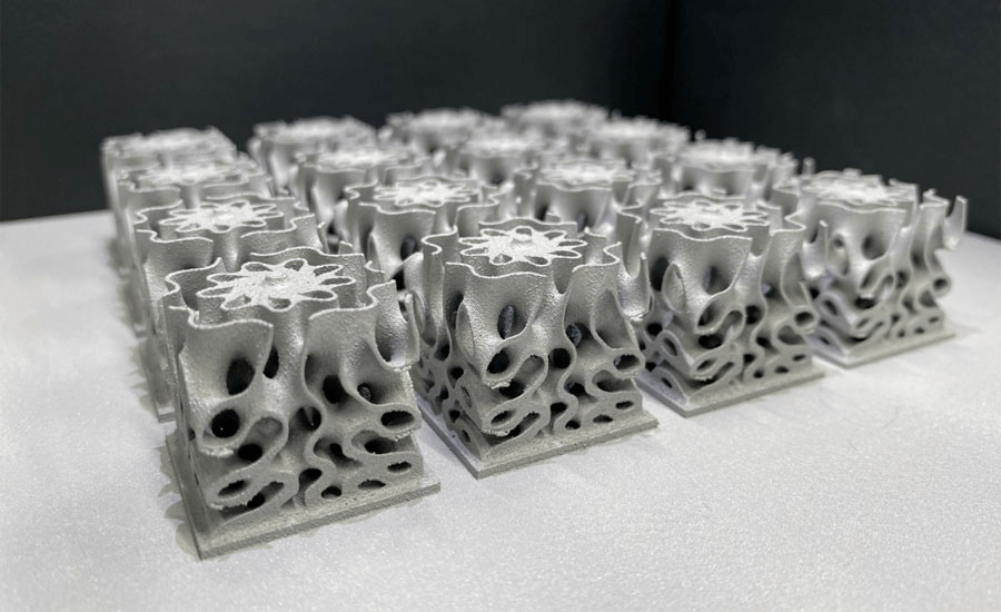

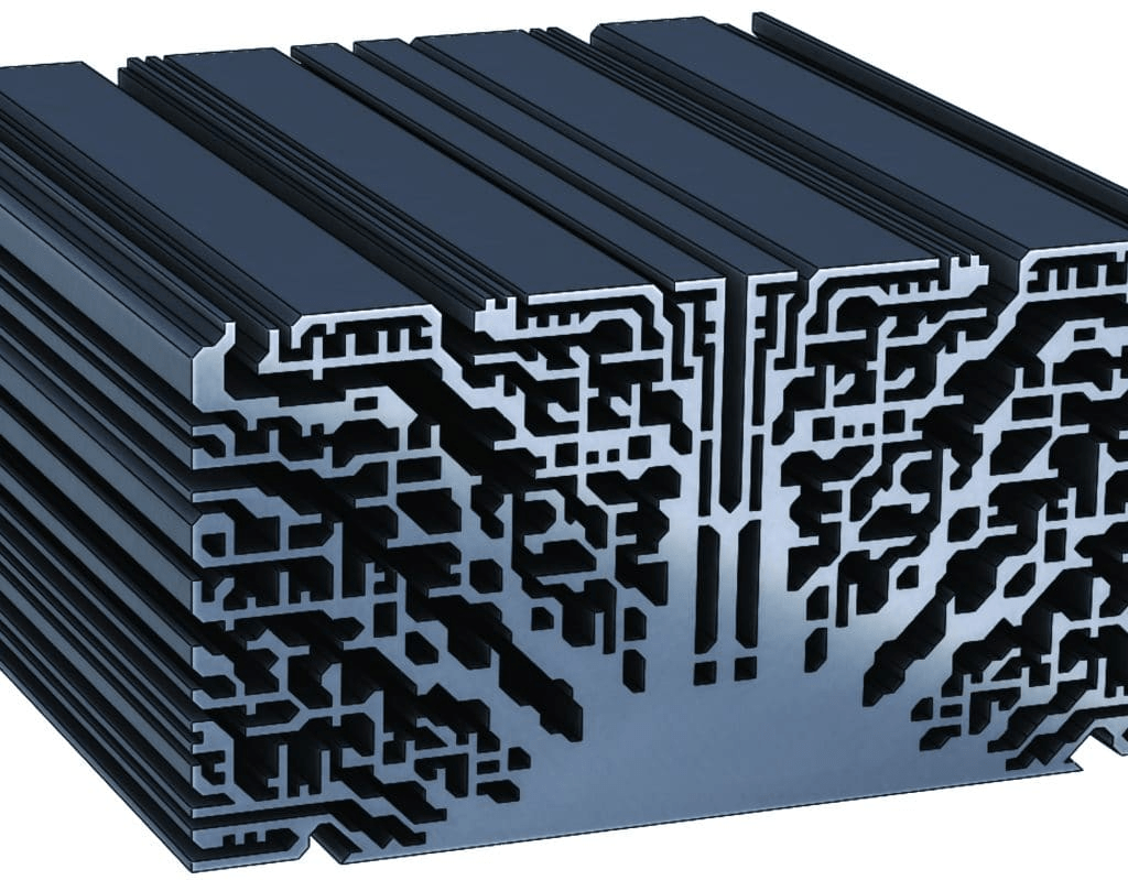

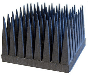

Some of the heatsinks pictured above (e.g. post 33) are not going to do well. Air has a tendency to move between fins or surfaces but only when the spacing is large enough. Otherwise there is mostly justy stagnant air except around the outside edges, which defeats the purpose of having a lot of fin area. The good old vertical fin with 1-2cm fin spacing works best. This assumes there is no fan driving the air, in which case you can get away with smaller fin-fin spacing but it has to be above some minimum value.
hence why i've opened the discussion to convection direction.
and sorry to say some of the pictured heatsinks are the epitome of new understanding and efficiency.
numerical and experimental study on orientationhttps://open.library.ubc.ca › download › pdfto Bruce Gillingham...could you please provide a direct link to the paper your referring to, so far i've been unable to find it.
I don't think the air in the middle of the heat sink such as in #34 and #35 could remain stagnant. Any stagnant air in the center would continue to heat up, and therefore become lighter than any surrounding air (including that around the outer fins/pins/cones). It will therefore rise (within a gravity field), creating a lower pressure (partial vacuum, if you will) area beneath it, which will draw in surrounding air to equalize that pressure (advection). Air is a very low viscosity material. Hard to stop it from moving when subjected to pressure gradients. Now, I am not arguing that a heat sink with fins configured to allow free low-drag vertical flow of air across their surfaces is not superior, but in some designs the constraints may preclude using an ideal heat sink configuration.Otherwise there is mostly justy stagnant air except around the outside edges, which defeats the purpose of having a lot of fin area.
The fractal-inspired one in #33 presumably was designed to be mounted with the channels oriented vertically. Assuming it is, I doubt the viscosity of air is high enough to prevent it from flowing through it in its attempt to equalize any heat-induced pressure gradients, but I'm not knowledgeable enough to provide an engineering analysis to support that.
