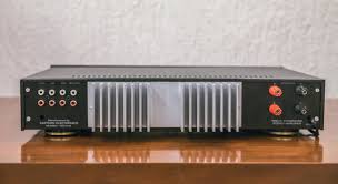

I think commercial Amplifier sellers are not allowed to run touchable parts above 50 (?) degrees. So they have to be big and - probably most important - expensive.

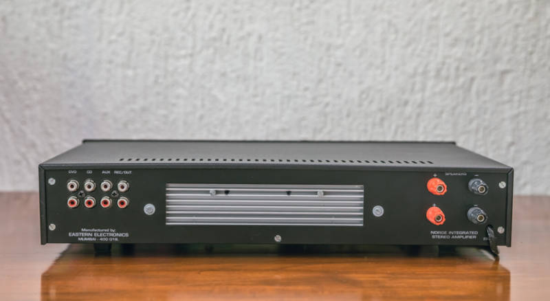

If you have the heatsink internal you can run it at 100 degrees if you isolate it from the case. And no customer gets panic.
Heatsinks outside are much more efficient, but for me its a pain to carry such amplifiers around. So if I need not to get rid of a lot of heat I prefer heatsink internal. But since I am a DIY I built them with a wide slot at the bottom to ge a good ventilation directly to the fins.
Regards Jean-Claude
Warm air elevates, most people learn that in kindergarten. More easy with vertical fins 😊
Black surface radiates! heat better than silver or other color... High school physics 😊
Internal heatsinks will heat up their surroundings by radiation and all those black caps will receive that, get a fever and die from dehydration...
Most manufacturers mount the frontend/driver boards to the external heatsink, so everything on that boards gets hot if the heatsink does.
Heatsinks should be external, black, with vertical wide spaced fins, not be obstructed anywhere.

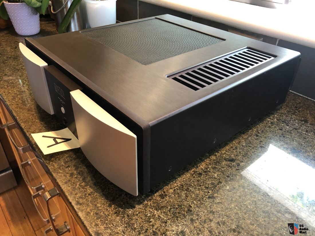

I've seen middle ground. My apt has them internal sort of. They are mounted on the sides and the bottom has large vents on the sides and the top/sides of the case is perforated. Runs very cool. It is easier to handle than my hafler or my amber which both have sinks external. While not exactly sharp edges, the sinks on those amps make them a little harder to pick up. And of course even with external sinks the hafler runs much hotter than the apt. The amber like the apt runs quite cool. I like WintrMute2's solution. Well ventilated and yet easily moved. And being able to pickup an amp given their weight is something to consider. I've also got an outlaw 755 (200x5) that weighs a ton, well ok not quite, I think 100lbs.

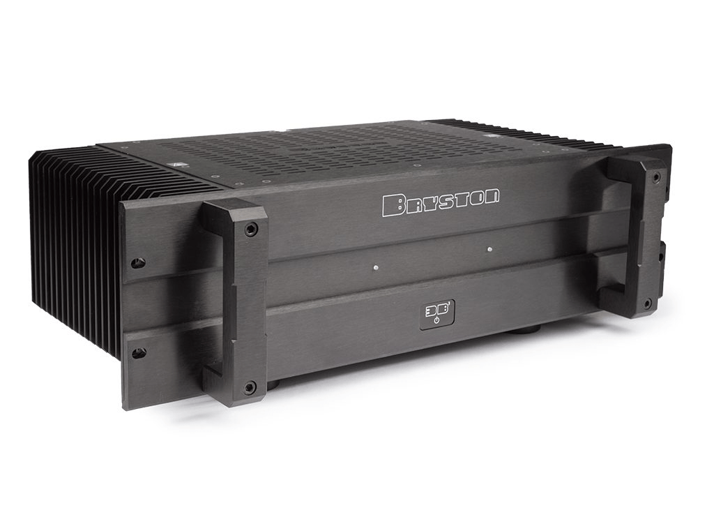

well i perhaps may be reliving my "glory days" as a touring soundman but external heat sinks didn't concern me as they usually lived in a rack/road case.... and cooling became the domain of rack design in order to accommodate having 4 Bryston 3B's in one rack and for those of you moaning about portability and ease of carry it should only be a concern if your trying to make your system portable....at home i would gladly live with a chirstmas tree like structure (sorry likely a seasonal influence!!) that was untenable to move so long as it provided me with an edge in performance characteristics... forced air or not....
