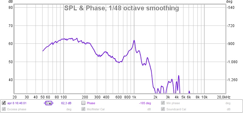

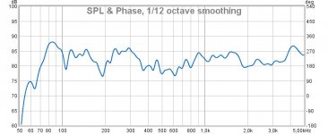

Internal narrow-band absorption techniques?

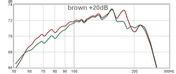

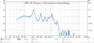

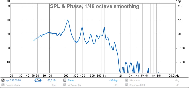

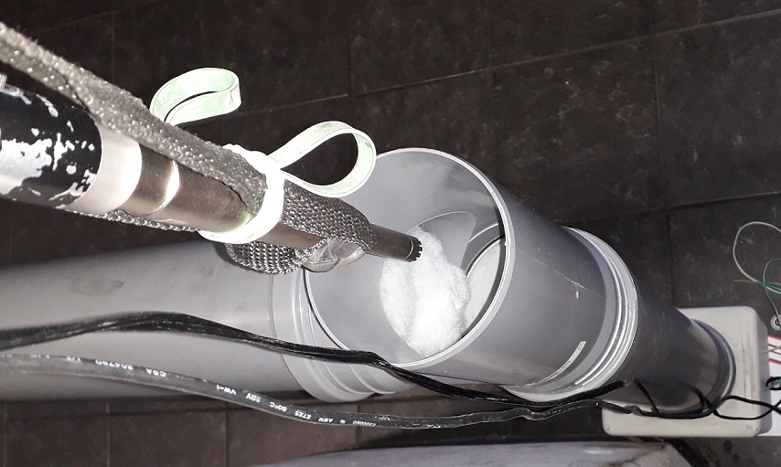

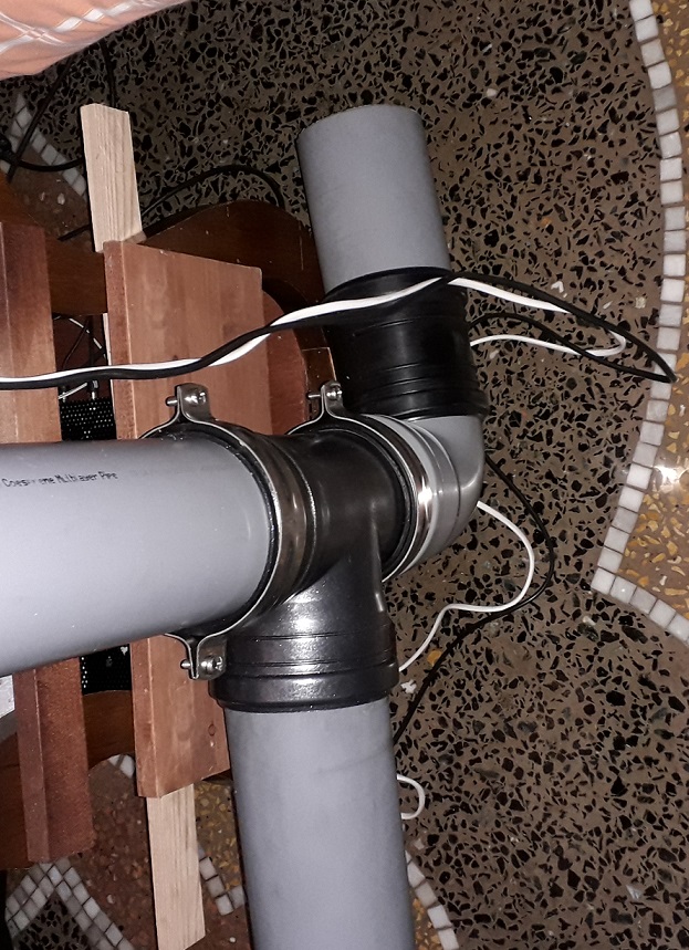

I added a resonant branch.
The position is critical.
It seems to me that it has the maximum effect if placed near the exit.
It has a narrow band: damping is required.
Blue: only the empty port;
Brown: adding a 32cm resonant branch;
Violet: adding acrylic in the branch, empty TL

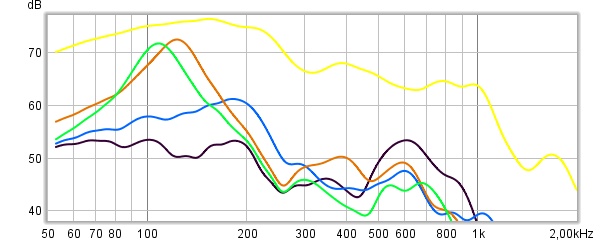

It seems to me to retrace the history of electroacoustics ... :)

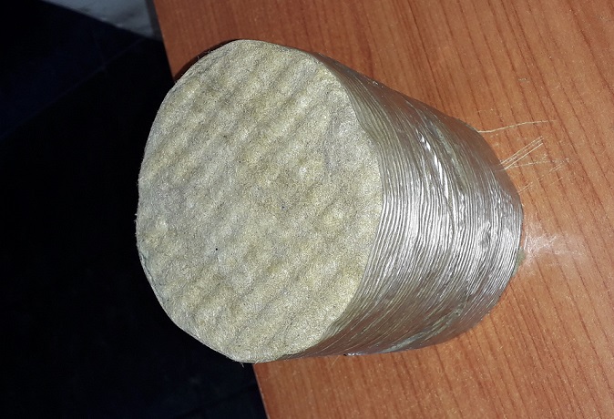

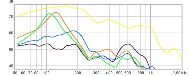

Some figures moving a cylinder of heavy absorbent 12cm, along the pipe, stuffed box:
green: in the throat
brown: intermediate position
blue: intermediate position
black: to the mouth
yellow: empty pipe

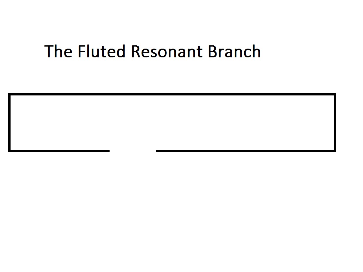

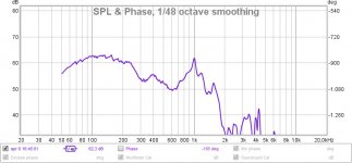

... and what about a FRB?
A Helmholtz resonator acts as a bass band. A tube closed at one end resounds at the fundamental frequency and harmonics.
Resonances in boxes often contain fundamental and harmonics.
Why prefer Helmholtz?
How does a fluted resonant branch behave?
Will it have one or two frequencies of action?
If they are multiple, will they be independent or related?
Will it be possible to use a FRB to increase the bandwidth of a resonant pipe adsorber?

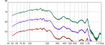

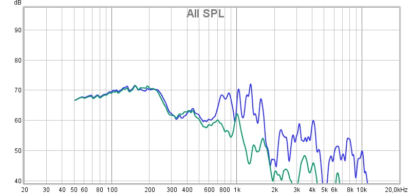

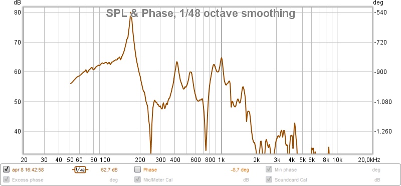

The resonance group 0.7-1.5 kHz originates in the box.
I tried to use helmholtzen, branches, different fillings, but I have the best result by covering the free walls with 4cm of polyurethane.
Blue: empty box
green: 4cm polyurethane over 3 walls
Any experience?
