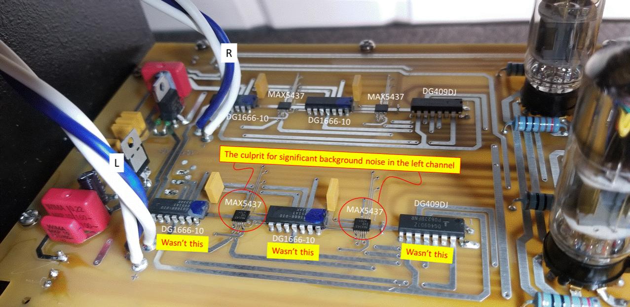

Intermittent Static on ARC REF 3 Preamp
Have you considered the tube sockets?

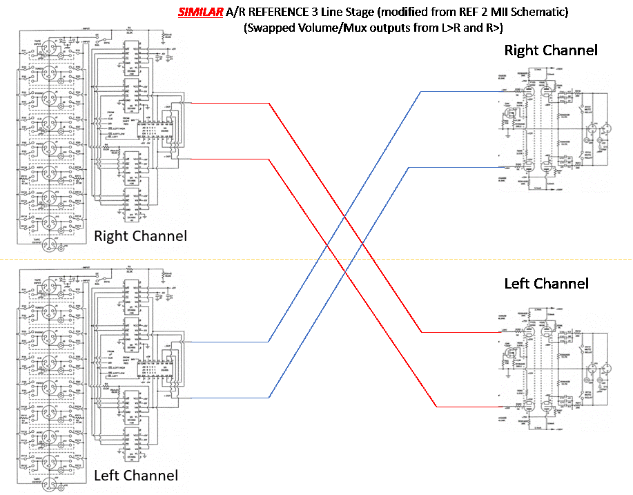

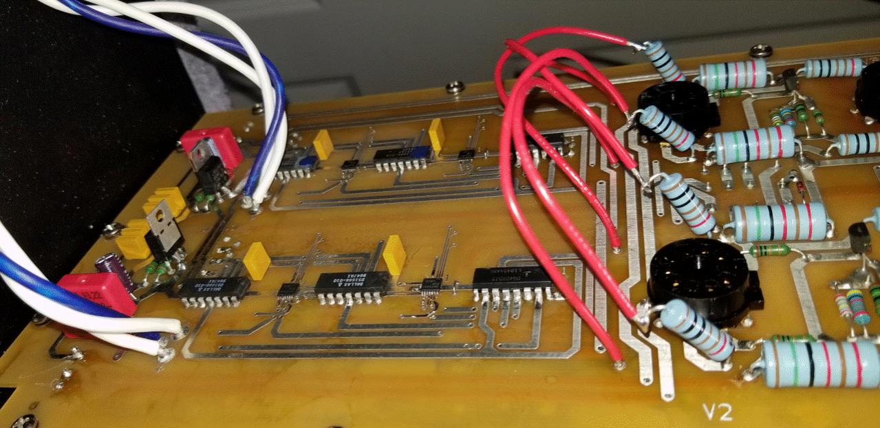

Yes, I ruled out everything beyond the digital volume circuitry by lifting the L and R output circuits and rerouting the L signal from the digital volume network, to the tube input of the R channel and visa versa. The noise followed the L digital volume network. See image, attached.

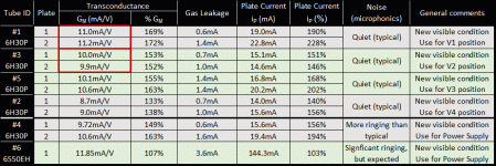

Final touch, characterized and selected best matching tubes to the various positions with most emphasis on matching gain to the preamp gain stage, followed by second best on the cathode follower stage. Sounds very nice now.

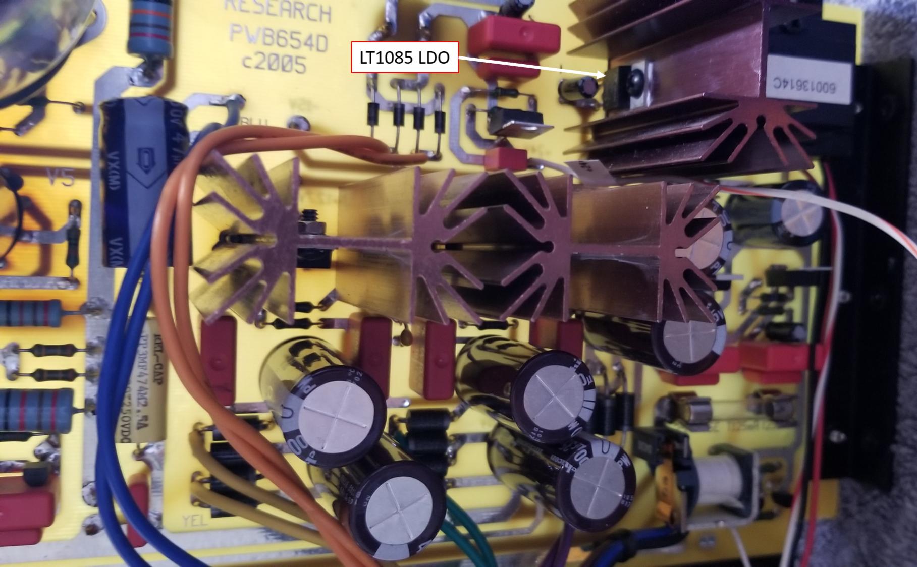

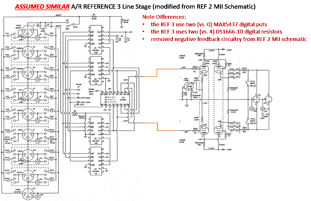

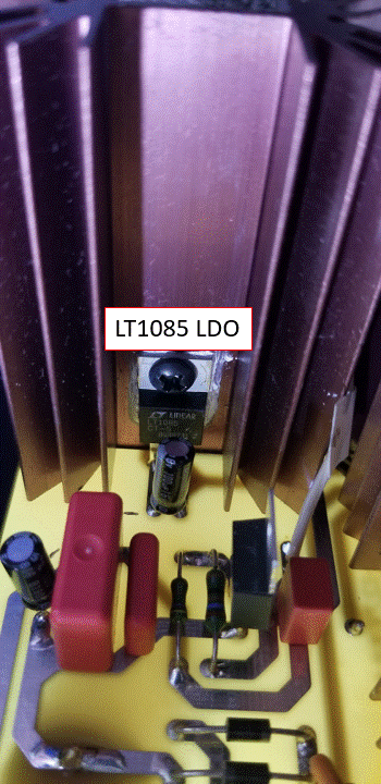

Vsquared,
My diy Ref3 works fine, I was just wondering how AR did some things. Do you remember what the LT1085 powers and what the output voltage is? Do they draw the -15volts for the CCS from the same source as the voltage that feeds the regulators for the volume control chips. (from the same diodes as the negative heaters)
Thanks in advance.
Hi Johnmarkp -
Unfortunately I never found the power supply board schematic and can't recollect the details any longer, sorry.
V2

Well folks, this closes the chapter for the culprit of the background noise in the left channel... it turned out to the the Maxim MAX5437 Digital Potentiometers... They were not at all fun to replace, being surface mount devices, but we're all good now. And as for the 2400pF Polystyrene decoupling caps that was seeking, I went with the REL RELCAP-51620, 600v RTE caps from Parts Connexion and had them match all 4 for me. So we're good to go... finally.

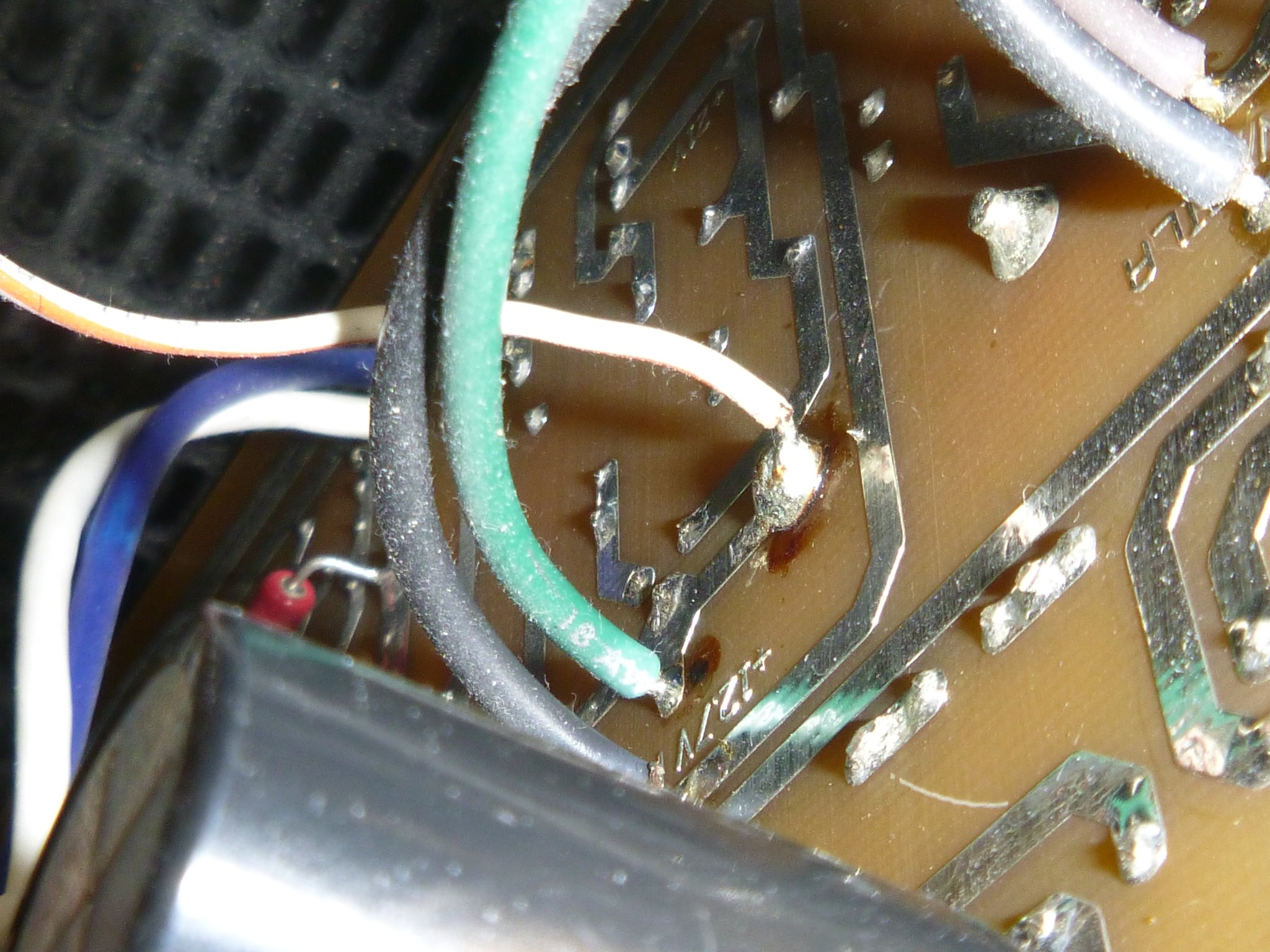

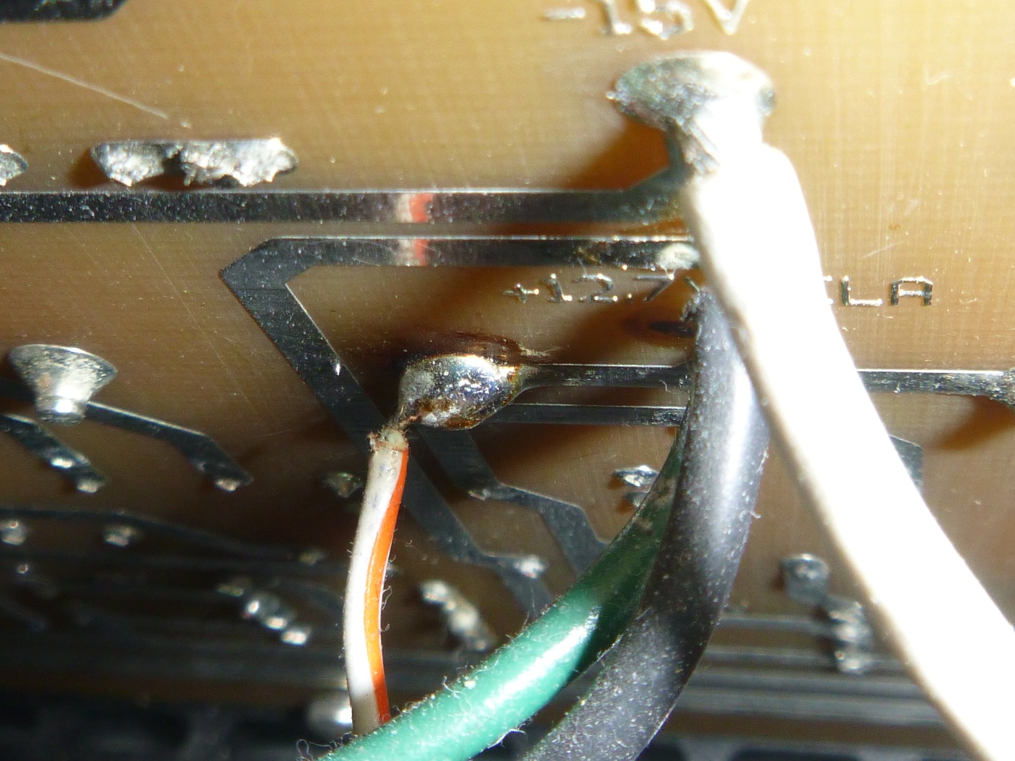

Hello and happy new year
Does someone still have his ref3 ?
In order to refresh mine, I replaced capacitors in the power supply (same value….), diodes and transistors.

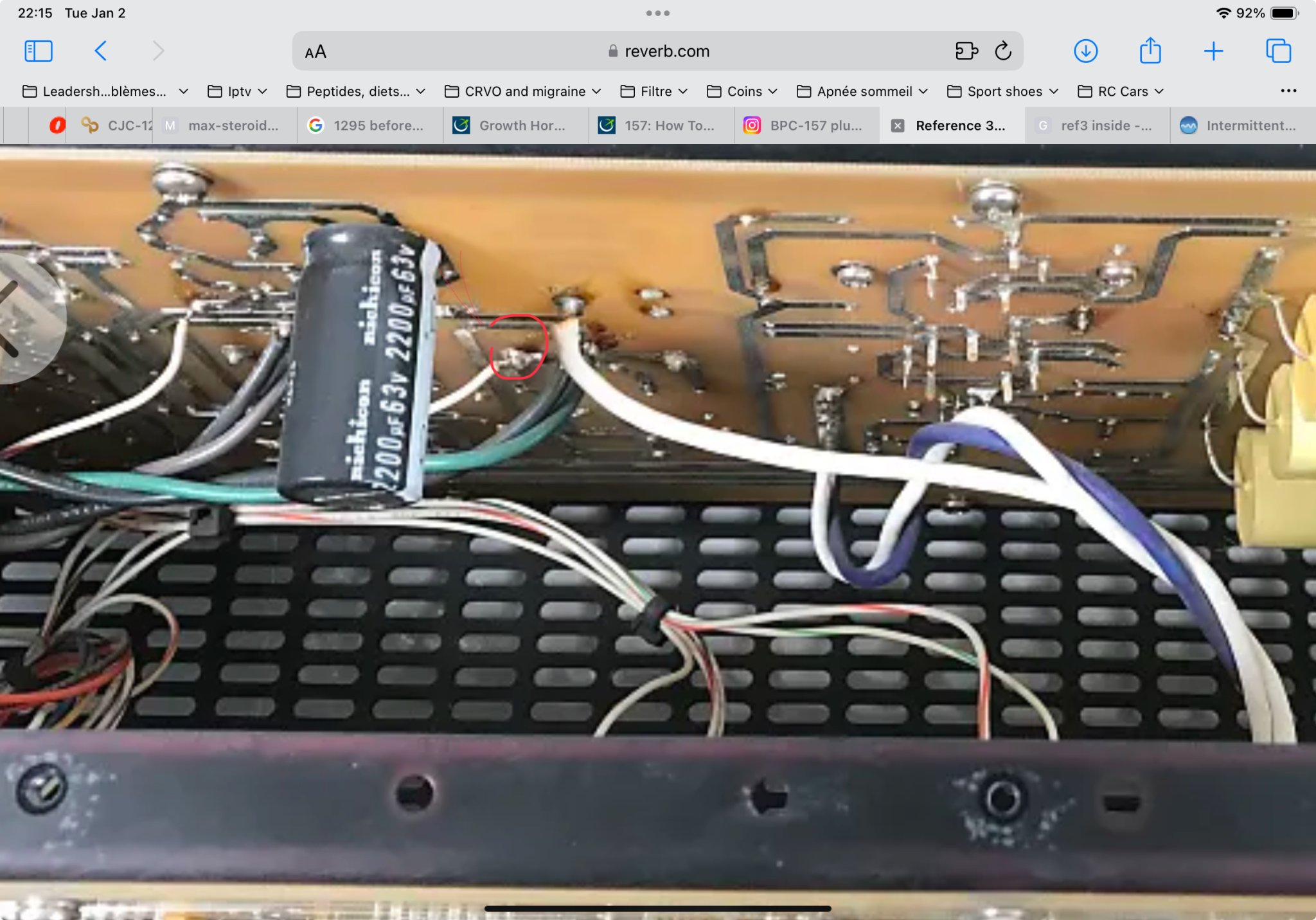

By not being sufficiently cautious (shame on me 😡 first time it happens in decades), in the back of one transistor (other side of the pcb) there is a thin wire (red and white) that was connected to the board. It seems while I desoldered the radiator, the wire moved to the wrong position and I did’t see it.
I grabbed a picture on internet to show you ( wire circle in red) but mine was soldered on the trace below.
Basically the wire was not connected as located on this picture but on the trace below after it slipped.
This burnt one max5437 (smoke and turned red) When I powered it on.
Can you please confirm where this wire should be connected ? ( maybe with a better photo as I cannot find one).
I ordered 2x max5437 and will pick them up today wednesday so would be very nice if someone could tell me that asap so I can fix it appropriately.
Do you think something else could have suffered from putting the wire on the trace below (don’t know what this trace volts is….) ?
thank you all

Geez Louise, you could have asked a week ago when I had the top off.😉
Anyway, I took it off again, see attached.
