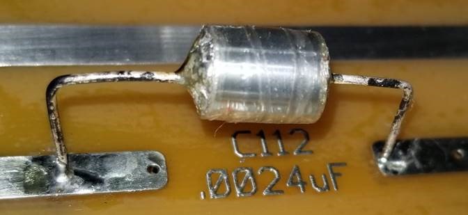

Does anyone have a service manual for the Audio Research Ref 3, showing 1) the source/model/make of the FETs, 2) the process on how to bias the FETs, and 3) a source for the specialty 0.0024uF polystyrene caps in series with the signal path (voltage rating/tolerance/where to purchase)?
Where can I purchase OEM matched FETs and polystyrene caps? Also, when changing the volume, I see a temporary DC component on the output - trying to figure out where that's coming from.
ARC uses house part numbers, and you'd have to buy parts directly from them.
The 2400pF is a standard value, but they test and screen all parts.
It's not likely the this capacitor needs to be, or should be, replaced.

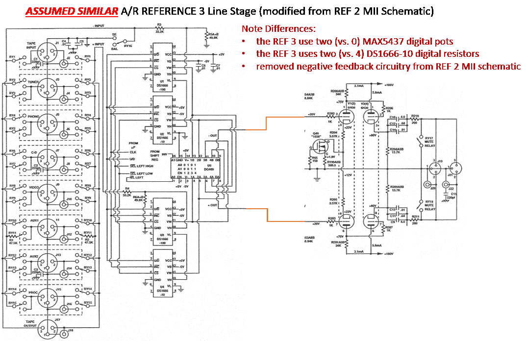

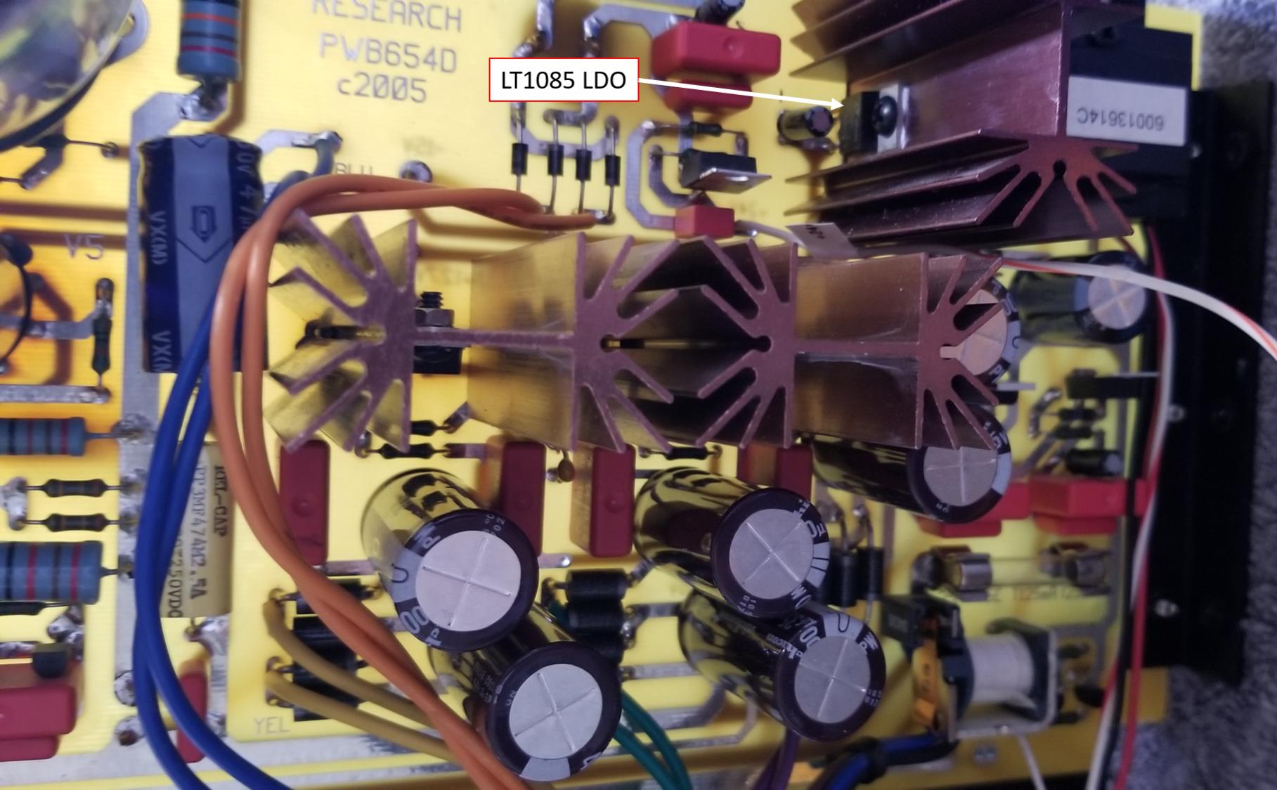

The parts for the digital volume control are still available. The DS1666 parts are EOL, but are still out there. The other chip is the common DG409. The circuit diagram is basically the same as the Ref 2 MII which is published at ARCDB - The Audio Research Database - The unofficial & unauthorized source for ARC information

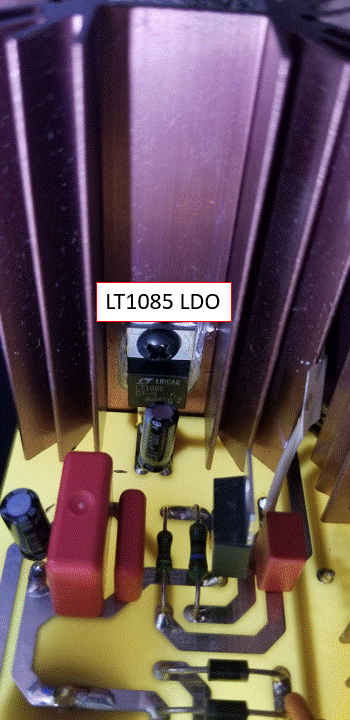

Where is the LT-1085 used on the PS board.

Thanks johnmarkp. I made assumptions on the REF 3, based upon the REF 2 MII and just eliminated the negative feedback FET circuitry from the REF 2 MII to create what I suspect is representative of the REF 3 (attached), showing one channel. The MII used 4 digital resistor IC's and the REF 3 uses 2 but adds two digital potentiometer IC's, so it's a little different, but similar enough. I left the Digital resistor/pot and mux the same as on the MII.

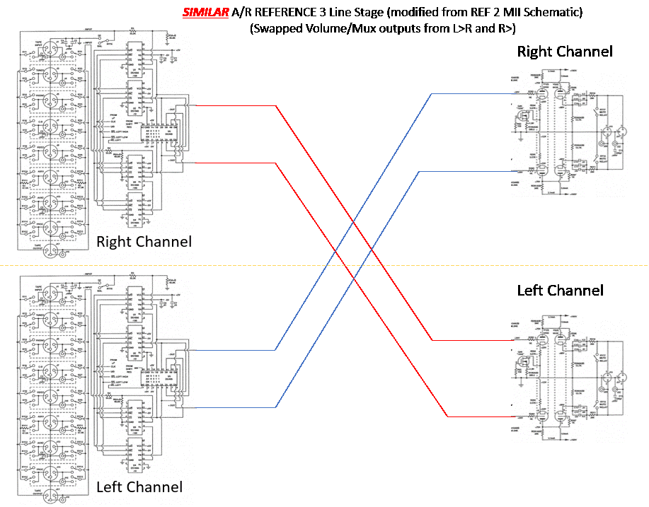

So it appears that a test I could do, would be to lift the 1K leads from each, the negative (DG409 pin 9) and positive (DG409 pin 8) input resistors and run a cross wire to swap the L & R signals?
If if the noise transfers to the R channel, it is clearly one of the following:
- MAX5437 (Digital Pot), https://datasheets.maximintegrated.com/en/ds/MAX5436-MAX5439.pdf
- DJ409 (Dual 4 channel differential Analog MUX), https://www.vishay.com/docs/70062/dg408.pdf
- DS1666 (Digital Resistor), https://datasheets.maximintegrated.com/en/ds/DS1666.pdf
If not, I wonder if it is a tube biasing issue? But swapping the constant current FET's didn't change anything.
I wasn't provided the remote, so I can't check if the issue remains in Mono or with Inverted phase.

Here are some additional pictures, FYI. The LT1085 is on the power supply board, shown in picture.
Ok, so it's clearly coming from that digital trim-pot/differential analog Mux/digital resistor array on the left channel. I lifted in input side of all of the 1K resistors [the negative side (DG409 pin 9) and the positive side (DG409 pin 8) from each channel] and criss-crossed wires to route the circuit board L volume stage to the R side of the preamp tube stage, and visa versa.
The noise followed and is now on the right channel. So it's clearly one of the two MAX5437's (Digital Pot), or the DJ409 (Dual 4 channel differential Analog MUX) or one of the two DS1666's (Digital Resistor).
Looks like the DS1666-010's are matched (marking on them), but I suppose unmatched pairs will certain sound better than the noise.
The noise difference between the two channels is significant with an average difference of 10dB and with the spikes in the noisy channel, a difference of 16dB.

1. Of course not. Why would you expect ARC to deface them if the types were in the service manual?
Otoh this is not rocket science, far from it. Donkey years ago i drew a circuit, made some assumptions and put values to the currents. If you have a working unit you can just measure the current as this is a simple CCS. Cannot see a reason many other fets won't work just as well. I think i built it using a 2sk170.
2. Look at the circuit. All voltages and currents are assumed, never bothered to update those with real readings as i long lost interest in this particular circuit or anything else wearing the ARC badge.
3. No idea where this cap is and what is it doing. Cannot see any reason for wanting this exact value. Is it just bypassing one of the output caps?
The DS1666 blow up all the time, mostly because users connect tube dacs or phono stages and this often puts the input at an elevated voltage. A pretty dumb choice on the part of ARC.
Analog_SA, That looks familiar🙂
Vsquared, got my ARC units mixed up. I think they went to the Max part since it can take higher input voltage compared to the DS1666. They used the Max5437 / DS1666 combo for a long time, Ref3, 5 and 5SE. The Ref 6 uses different parts. I do not think matching new DS1666's is critical. I took the time to measure 20 different volume chips a while ago. The difference between the lowest and highest value was less than 1db.

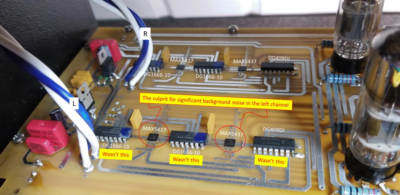

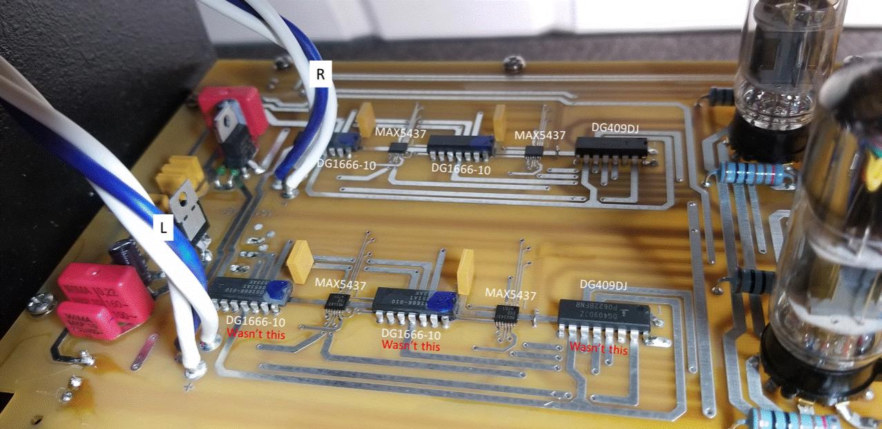

...arg... well, I replaced the DG409 and both DS1666-010's in the left channel and no luck... arg...
Guess I'll try the last two in that path, the MAX5437's, next... after that, I've pretty much run out of things to replace...

Well folks, this closes the chapter for the culprit of the background noise in the left channel... it turned out to the the Maxim MAX5437 Digital Potentiometers... They were not at all fun to replace, being surface mount devices, but we're all good now. And as for the 2400pF Polystyrene decoupling caps that was seeking, I went with the REL RELCAP-51620, 600v RTE caps from Parts Connexion and had them match all 4 for me. So we're good to go... finally.
