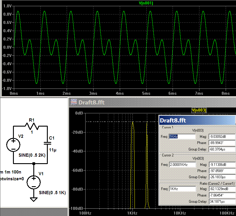

easy enough to test your soundcard, create .wav with 2 sines at different freq in r,l chan respectively; add dac r.l out with equal value resistors, and put into single adc line input
then a dft of the captured sum will show the phase diff between say 1 KHz in right chan vs 2KHz in left
LtSpice does wave file i/o, I think RMAA will play your test wav and capture for you - you should be able to make a long enough stimulus file that you could manualy initate a readwave while it plays using LtSpice alone
this sim shows you could read off 7.8 degrees phase diff @2KHz (diff from 1 KHz ref) which calculates nicely out to 11 US delay with plenty of resolution:
you can read off 7.8 degrees phase diff @2KHz (diff from 1 KHz ref) which calculates nicely out to 11 US delay:
The reconstruction algorithms in my sound card are old generation stuff..coupla years old...ancient...:bawling:

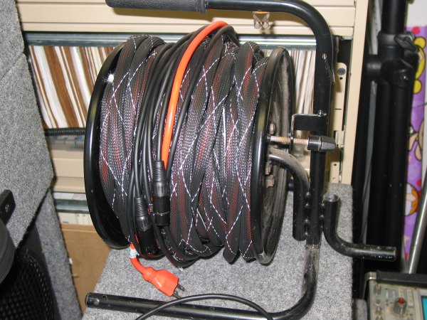

I have included a picture of the snake I used in a 450 seat venue. This cable has a 100 foot #12 extension cord, a balanced mike cable, and the line level stereo run back to the amplifier on stage, a qsc rmx1450. I used a 120 foot length of balanced mike cable for the stereo audio run in order to get the snake to fit on the spool you see. While the RMX-1450 has balanced input capabilities, the rack I use on the stage has an unbalanced (rca) input equilizer that feeds the 1450. So, I used the blue wire of the mike cable for right, the white wire for left. Yes, it degrades the hf channel separation, but that is not significant for this application, and I really didn't notice it anyway..
But of significance is the fact that even though I have 100 feet of unbalanced feed, there is not a whit of noise pickup, no hum, nuttin, in a very hostile e/m environment. The reason is this: The mixing rack/cd player I have on the balcony uses the extension cord for it's power. In that way, the source ground provided by the extension cord is very close to the line feed back to the amp, so that there is no loop formed that will catch stray magnetic field garbage. If I connect the building ground system at the source rack, to the rack in any way, the hum and noise is unbelievably loud.
Luckily, using the one unbalanced mike cord worked like a charm so I didn't have to run two balanced feeds to the amp. This is an old picture, I have since added a 120 foot length of RG-6 as a video feed to a 39 inch tv on stage, and the spool is difficult to wind the cables onto. Also added a dvd player to the balcony rack, and tied that audio into my main system. Plugged the tv into the same outlet strip the amp and snake are on, and still, no noise out of the system...(unless you count the spongebob video clip as noise:dead: ...(don't ask)..
The indicators of ground loop, by severity:
1. Steady state hum.
2. Music power modulated hum.
3. External noise pickup, like sub pops.
4. Alteration of audio phase by induced voltages at input.
My setup eliminated 1-3, the setup is incapable of resolving 4, especially with 450 people laughing and having a good time..that's all that counts..
