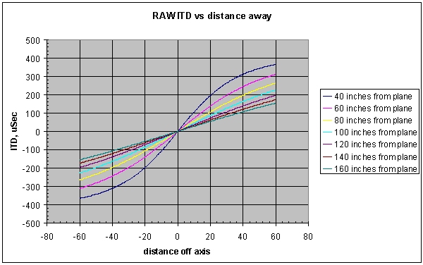

And here's the raw ITD graph I was referencing. and the depth differential one..
Cheers, John

jneutron said:
The intent is to calculate exactly what is available to a pair of ideal receivers 6 inches apart for the purposes of defining the source parameters that are required to provide the exact information a real source would provide..After this, of course, accomodations must be considered for what our capabilities really are, including the points you have made.
Yes. exactly. My point is that when you calculate x msec/y dB difference in an ideal setup, that is only a small part of the equation. ITD and ILD are important but so is pinna filtering and consistency with thead movements. The real problem is not how to create/record correct ITD and ILD, but how to deliver them to the listener ears. It is surely not lost in the cables 🙂
The sensitivity numbers are startling when it comes to depth....rather eye popping
Can you point me to some data. I hope they are not like those calculations where from the fact that in the front with signal with HF content directional resolution can be 0.5-1 deg, so they calculate ITD change from the theoretical model in the usec range, and the conclusion is that we must hear up to Mhz range. 🙁
Using the ear's frequency vs angle sensitivity is of no use for the description of a virtual soundstage.
No, but it is very important in the cone of confusion resolution and ambience perception.
Actually, it does. It is of course, a poor simulation, as nobody goes around with a septum in place.
Also never occures in nature the phenomenon that 2 distant source represent one real in the middle. 🙂
But your statement that imaging is denied with 2 speakers, is inconsistent even with the little speakers I have on either side of my computer monitor.
What you are talking about is stereo image - which is quite far from the ease of the natural hearing. Nobody said you can not imagine a stereo soundstage between the speakers. The problem is that the ITD, ILD pinna filtering, headmovement clues reproduced this way are inconsistent/destroyed. It forces your brain to work hard to select what info to consider real and what to omit. This can be enjoyable but never real (unless you have large, live room with benign acoustics, where the ambience info can mask theinconsistencies).
In case of mono over stereo speakers it works because the LF content of music has more voting power than the discrepancies in HF, but just turn 90 degrees to your speakers and listen to the same center image.
What is sad: the ITD, ILD and HRTF can be quite accurately recorded on 2 channels, but stereo recordings are not stereo playback compatible.
Agreed also. The question is a two parter..1. what is the absolute ideal ITD/IID (ILD) that a single point source can deliver to the ears, and 2. what degradation in hearing capability means to those ideal numbers. You cannot get lost in the second while examining the first..also, the first cannot be extended to the second.

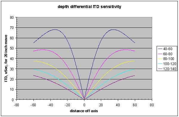

re:depth..
Hear in the Mhz range??People actually say that??
The worst I've come to is trying to come to terms with the thought that some are able to distinguish 2 to 5 usec ITD's, even though in the 500 to 12K range..that is rather amazing.
I'll post a graph. I tried previously, but found this forum only supports one jpeg per post..

Here's the pic. Each line represents the change in ITD as a result of a depth movement from one depth to another. As is seen, they all hit zero on axis, which of course is meaningless, we can't hear that well.
Cheers, John

The 100, 200, 300 numbers being bandied about are actually the kinda numbers needed for absolute localization..putting the head in a vice and pointing to the image.
We are not actually very good at that, what we are better at is relative position. For example, two bells at ten feet, one a foot to the right of the other, two different notes.. The issue is, can we tell which one is on the right?
That is differential localization. It is the derivative of the graph I presented. And exceedingly dependent on how far away the sources are.
