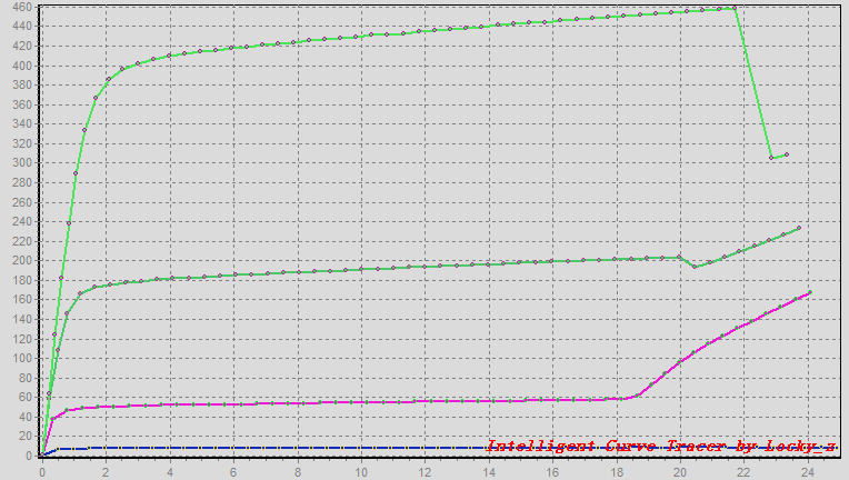

When I look at Locky's print from page one, he must have used a different setup. His vertical line consists of many, many dots.

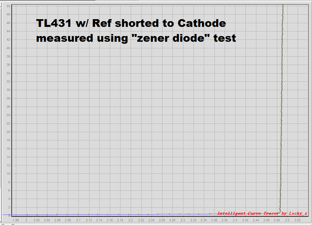

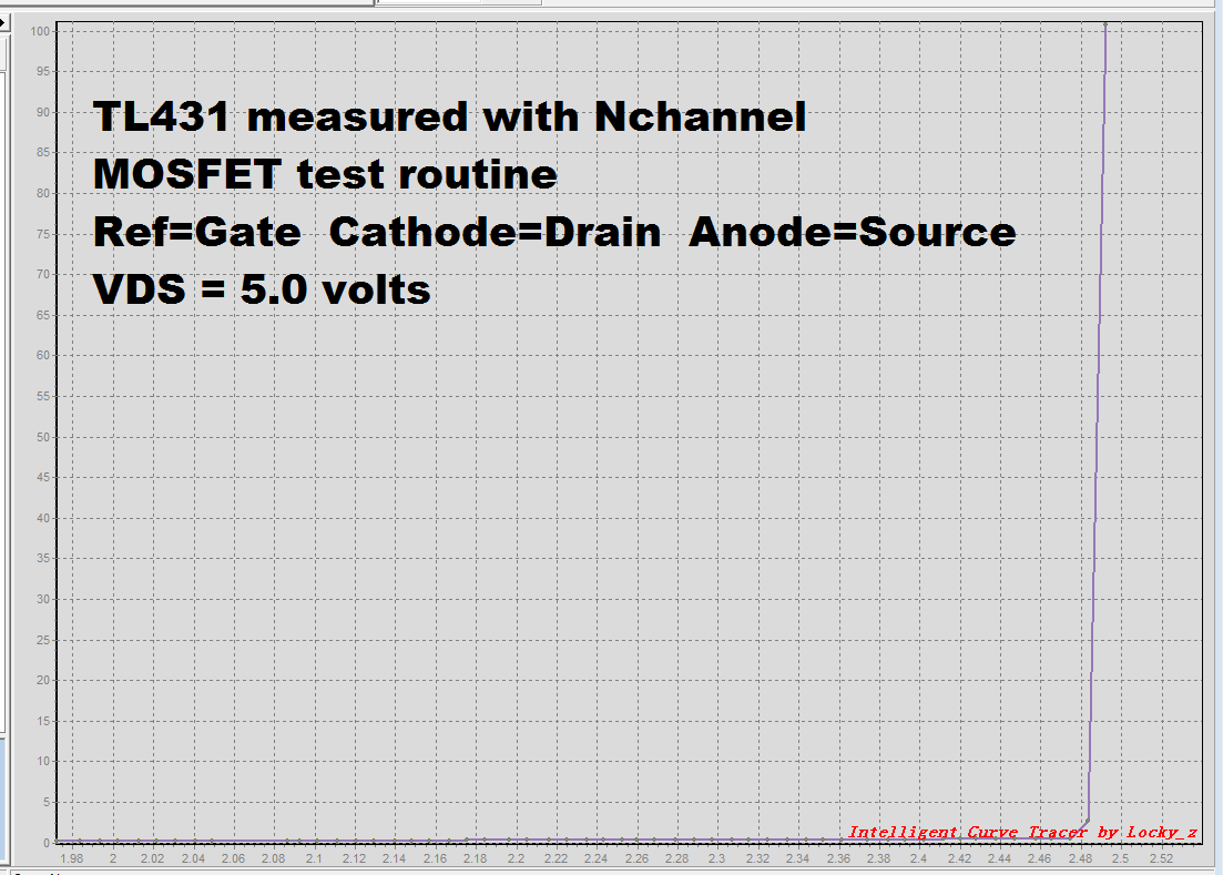

The two test procedures gave very similar results on my curve tracer just now. The same TL431 chip was used in both measurements.

Hi Mark, today I tried the zener way, and yes, it works as well here 🙂
Thanks again!
Cheers Ernst

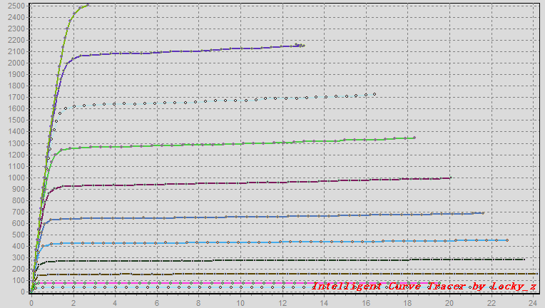

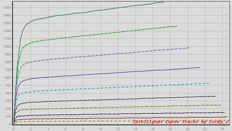

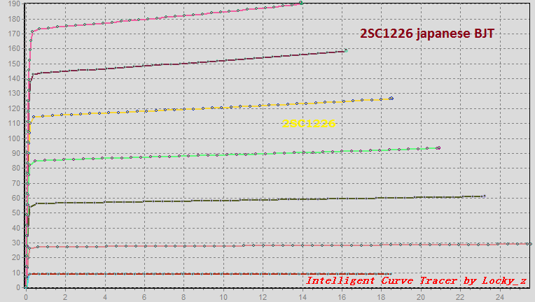

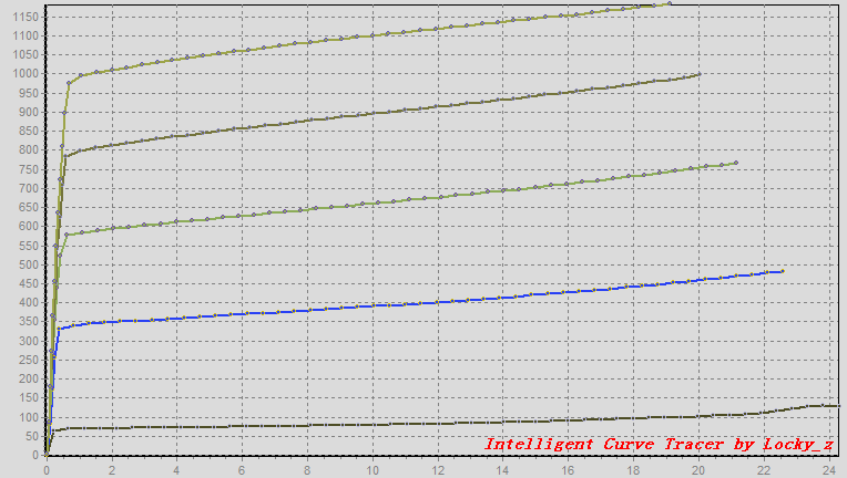

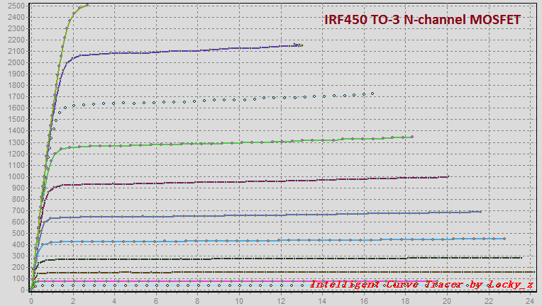

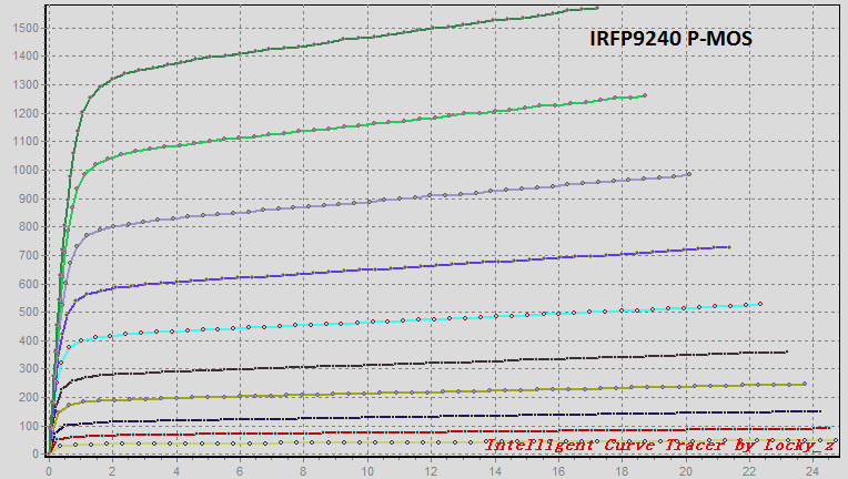

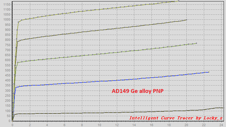

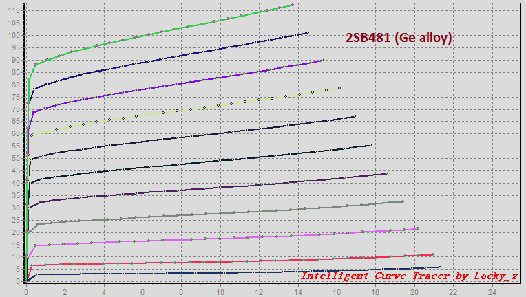

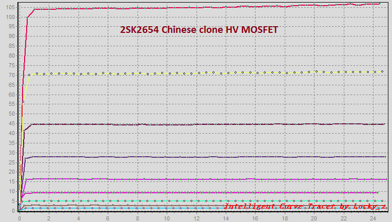

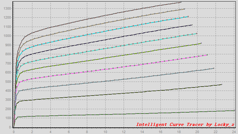

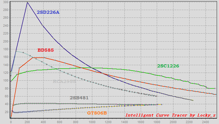

My tracer arrived recently!
And I made inumerous measurements!
Worked flawlessy!
Some examples, in attachment:
Worked flawlessy!
About crazy curves, I noted that the curves craze starts when we select a voltage impossible to obtain, like 36V with a 32Vsupply, or a low resistor for Rb and high for Rc, and manifests more in PNP/P-devices readings. In N devices, the curves only bunch to low values. With extreme wrong choosed parameters, the P-device curves become a fully mess.
Is easy to make a good reading, os onlya matter to make a little test before, and so choose the most correct resistors/Vc/Ve/Vb etc.
Oscillations perhaps I have only with this MOSFET (an IRF9610), and with a RF PNP. All other measurements worked without any trouble.

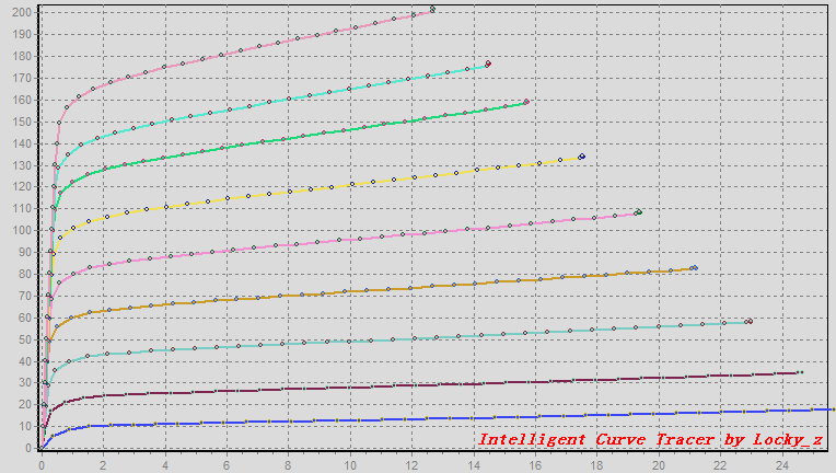

If you already own a used LockyZ curve tracer, you can export its raw XY data ("Save Data") to a file with suffix .cuv, which is ascii format. Then have your software department whiz together a little python code or perl script, that converts from .cuv format to the input format of your favorite plotting software (example: Excel .csv). Plot it there. Presto, any logo you wish goes in the bottom right corner. Or, no logo at all.
Attached below is an example where I took the LockyZ .cuv file, script processed it into an Excel .csv file, and then plotted it with Excel. Worked just fine.

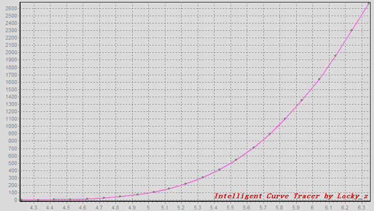

Here's an example curve from an IRL2203NS:
Load Conditions -> NMOS Vgs-Id(Fix Vce)
I selected RB=500 RC=5 since I'm looking for accuracy at a higher current of 1090mA, a constant Vce/Vds of 1.35V to match my operating condition, VB from 0 to 5 since Vgs won't ever go much beyond 3V, and checked "Calibration before measure".
Increasing the AD Sample should increase the accuracy of the measurement, but I wasn't sure where to set V Step. Since I'm looking at transconductance my thought was more data points along the curve would be helpful for calculating the slope, but I'm not positive that's correct or what the best balance of granularity is given the capabilities of the tracer. Locky at one point mentioned that the highest voltage resolution is 1-2 mV.
Once I had the curve, I selected the segment from roughly 900 to 1200 mA, right clicked, and selected "Vgs Calculate", which showed the transconductance to be 6898 mS:
Is this the most accurate and repeatable method of measuring transconductance across different devices? Should I just make sure I'm always selecting the same Id range each time I measure a new device?
Once I get to matching, my plan is to calculate the transconductance as above and then record Vgs at 1090mA, by right clicking, selecting "Id Sort", and entering 1090:
I can then export this data to a spreadsheet and sort to find matched pairs/quads based on high transconductance and close Vgs.
Let me know if all the above sounds correct and if I've missed anything.
Since these MOSFETs are D2PAK SMDs I'm using clips on the leads with wires going to the curve tracer screw terminals. I've added a 100R resistor in series with the gate to prevent oscillation, but I'm guessing in general I want to keep these wires as short as possible?
