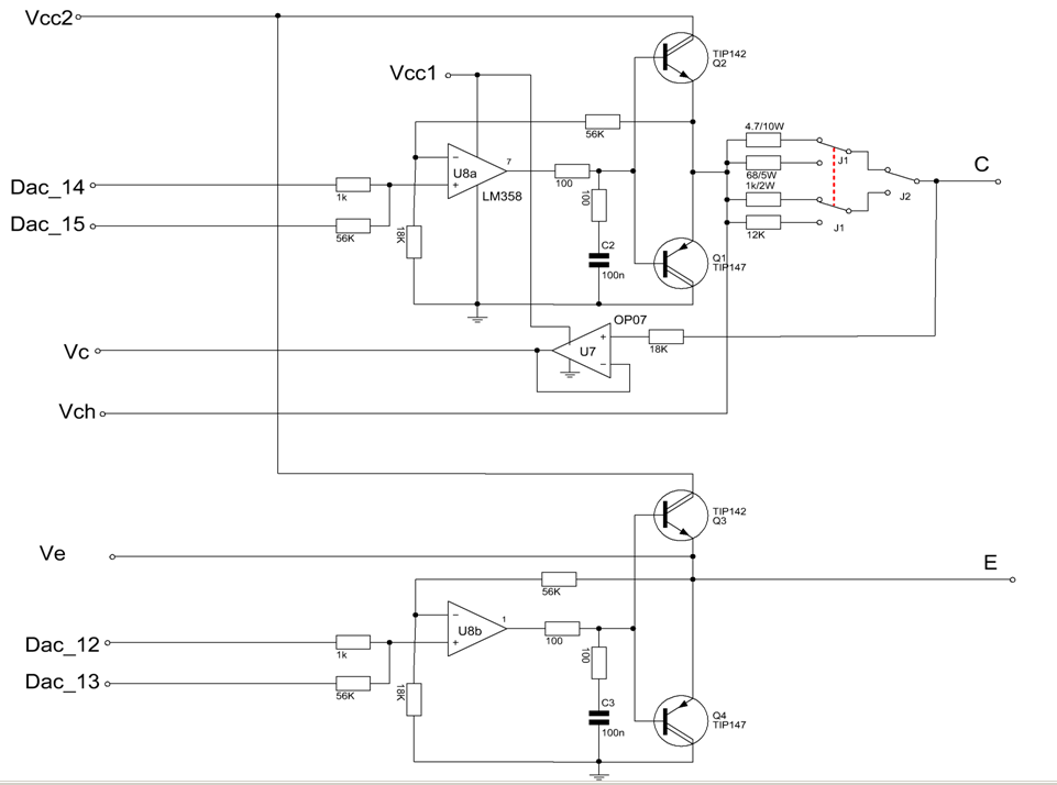

No Vcc2 on collector of Q1 and 2. I have replaced Q2-4 and still no Vcc2 on collector of q1. I have not replaced q1, as i do not have any. You mentioned Q7 being a possibility, but I do not have a part number and it is a position that is difficult to see. Would you mind giving that to me so I can get it on the way.

The power supply to Vcc2 by PMOS//R20,
The Vcc2 have some voltage unless Q1-Q4 is shorted or R20 is break.
Q7 is the 'pnp',it between R48 and R50.

i have replaced all fets. Vcc can be measured across Q2 but not Q1. Replaced Q7 with bc5xx. Still have over current lit. The base of Q7 is at supply voltage.

Q2 Q3 collect connect Vcc2
Q1 Q4 collect connect GND
The over current led light, the reason may be:
1.Q7(2sa970) C-E is shorted or turned on
2.PMOS G-S is shorted.
if the Vcc2(Q2/Q3collect voltage) is near Vcc, but over-currebt led still light.this mean there are no over current.
Then you can short the portect_sw( it is near the over-currect led,but not install),the sw will short Q7 B-E,If Q7 is ok,then Q7 will cutoff, and the led will not light.
If LED still light, may PMOS G-S is short.

I have the the tracer workinf again, but now I am getting very ragged response and cannot even measure in the same way before. Seems unstable. I replaced both the PMos and the Q7 with alternate transistors. I assumed this was not an issue due to the fact that they are not active in the actual measuring process/ Could this be causing my problems? Also, Although I have never cased it up, shold this help performance, providing a sheild from RF or other interferences?

Q7 and PMOS measurement does not play a role, you can even shorted PMOS D-S. But the protect will disable.
You also can short the Q1 B-E/ Q2 B-E / Q3 B-E /Q4 B-E ,then The LM358 driving the test unit direct. Q1~Q4 not play any role. But you only can measure small signal device.
In this way to see whether the system is stableand.
