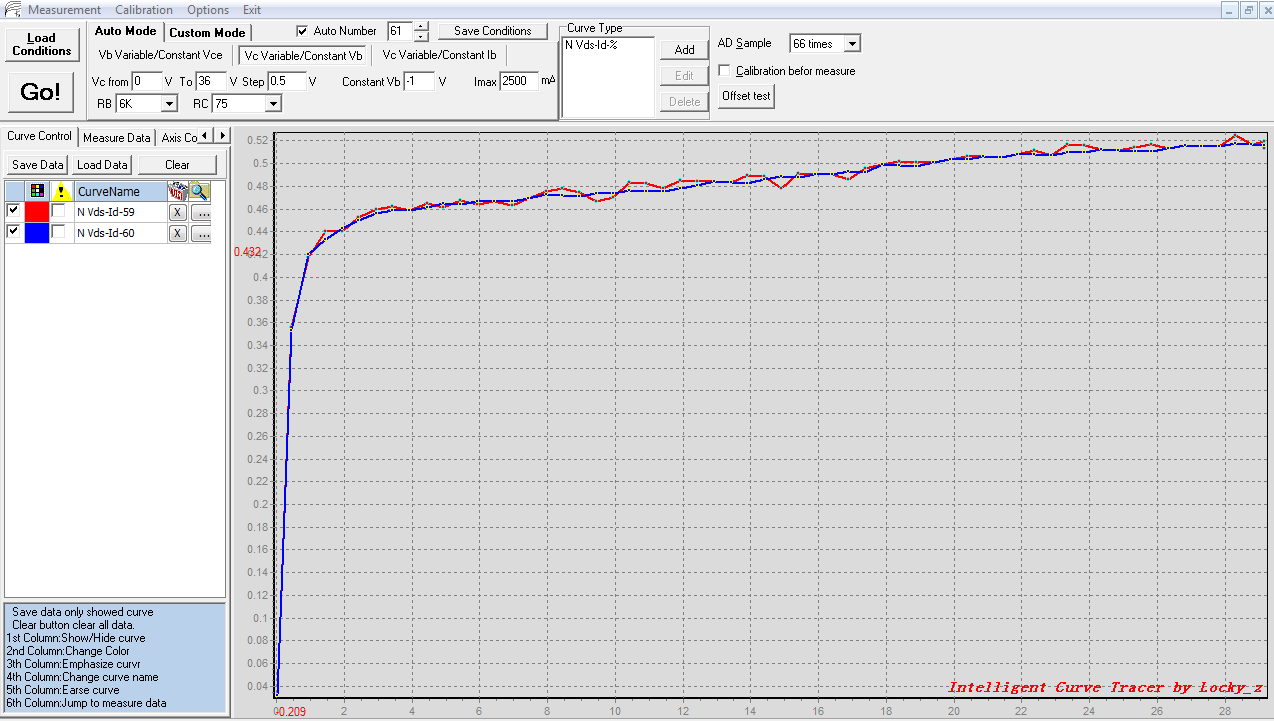

2) The attached curve shows a 'Vds-Id' curve for a 2N5457 NJFET. The red curve shows the results for the two AD sample setting while the blue (smoother curve) shows the curve for the 66 AD sample setting. I obtained similar results for all of the other 2N5457's I had on hand. Mostly I get nice smooth curves using the two AD sample setting for all of the other NJFETs I have tested. Can you suggest why I get less smooth curves for just the 2N5457s?

Your 'Ic' is too small, it only 0.44mA,you need to use RC=1K or RC=12K,2) The attached curve shows a 'Vds-Id' curve for a 2N5457 NJFET. The red curve shows the results for the two AD sample setting while the blue (smoother curve) shows the curve for the 66 AD sample setting. I obtained similar results for all of the other 2N5457's I had on hand. Mostly I get nice smooth curves using the two AD sample setting for all of the other NJFETs I have tested. Can you suggest why I get less smooth curves for just the 2N5457s?
Because the measurement accuracy or noise is about 2 ~ 5 mV, if you use RC=75,the Vrc only 33mV, If you choice RC=1K or RC=12K,then VRC will be 440mV or 5.3V, the accuracy is more than RC=75. The curve will be more smooth.

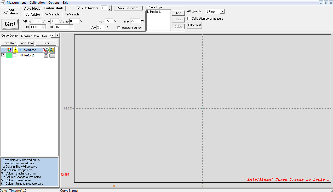

But should I get only one point in my curve as shown below?
What is your supply voltage?
The software control B/C/E channel power amplifier output voltage what you set, and measure them.
When it measured voltage(Vbh/Vch/Ve) is between you set value-2V ~ value+2V, the software consider the B/C/E channel amplifier is OK. if not, it conside power amplifier is failure, then stop to run.
From your picture,the vc is 35V,If your power supply voltage is less 35V, the power amplifier can output more than 35-2=33V, the software consider the power amplifier is failure,and stop.
If the parameter in ini file is error,example the gain is error, you want to output 30V, but the gain parameter error,so the output is less, the software measure them, consider the ampfilier is error,so stop.

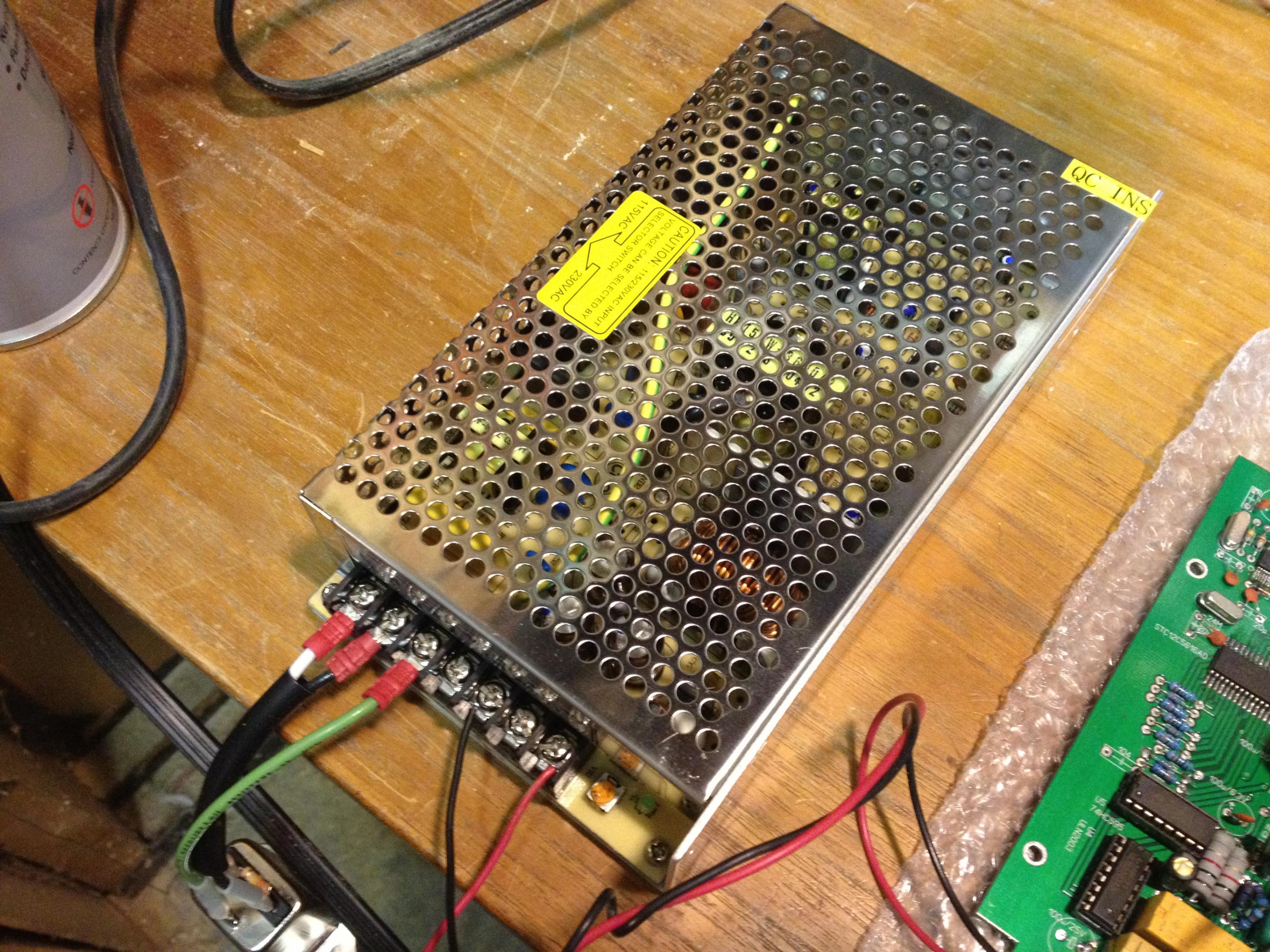

Power Supply for CT3
I found a power supply for the CT3 that I like and that seems to work well-36V/4.2 A. Price was good (cheaper than what it would have cost me to build an equivalent linear supply). 36V 4.2A Single Output Power Supply

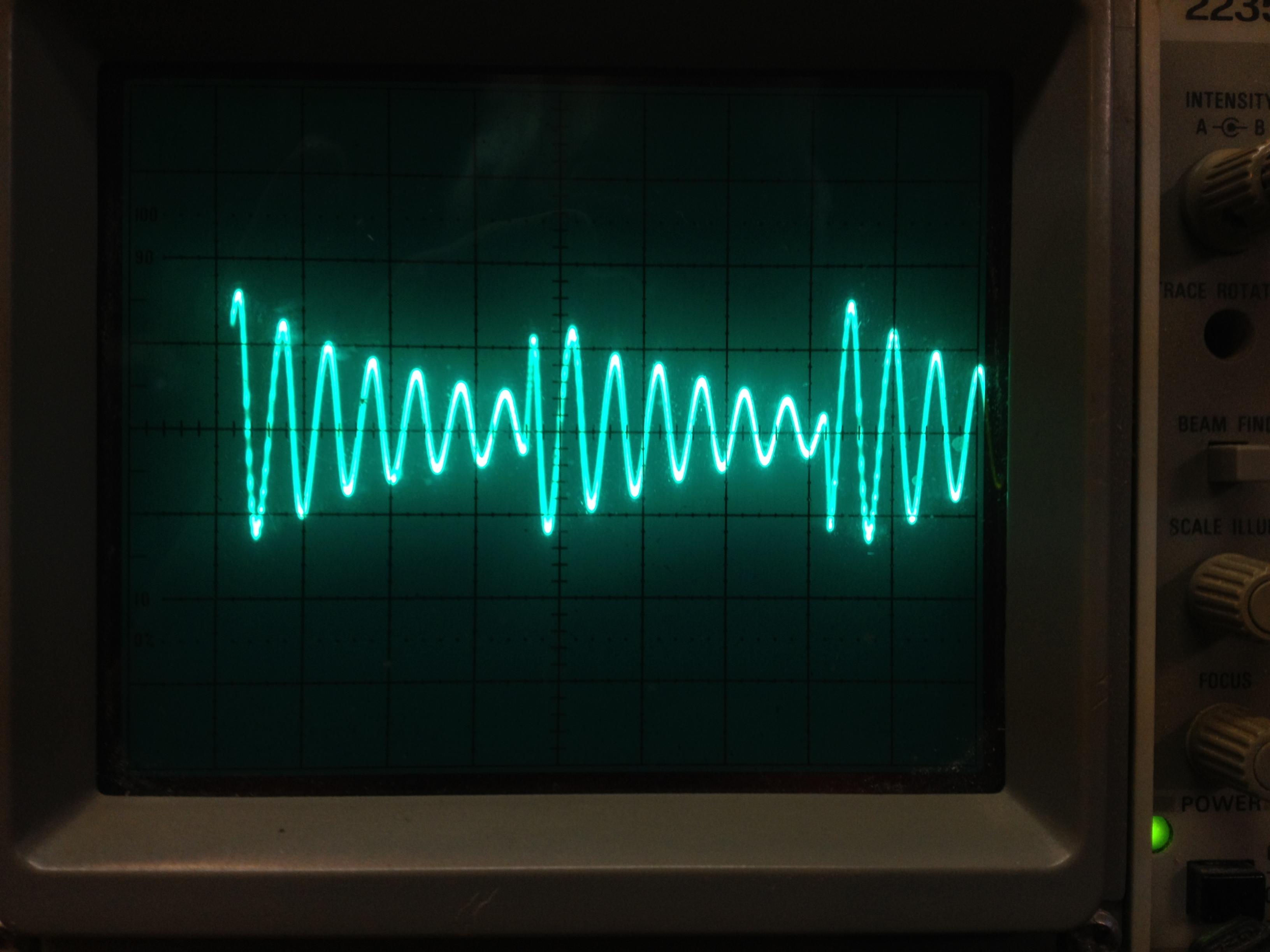

Noise is a little high compared to the linear supply I had wired up (see the scope photo-settings 50 mV/div and 5uS per div) but I think the frequency of the noise is high enough that it doesn't much matter-which brings me to my question-does it matter? It would be relatively simple to clean it up, but I am not so sure that the effort is warranted. Comments from the experts would be much appreciated.

This switching power supply no problem.
I compared the linear power supply and switching power supply, there is no difference.

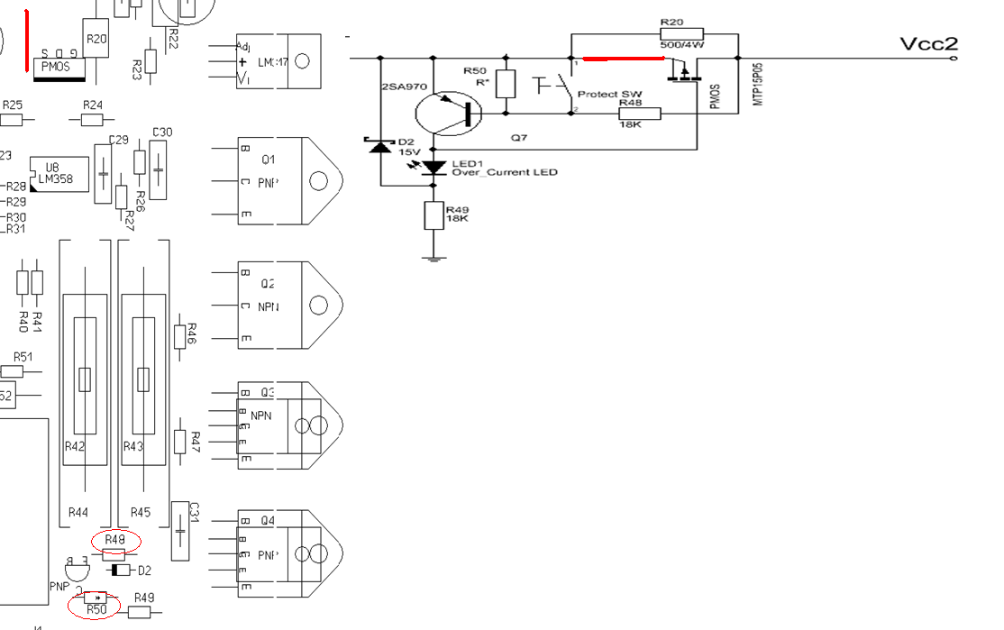

I was testing some mosfets today and got a pop and now LED over current light is on. Any ideas. I don't want to have to go this thing bit by bit.

"got a pop" mean you hear a 'pop' sound? or a popup a window?LockyZ,
The protect circuit as below:
Vcc is power supply input,and output to C/E channel amplifier(Vcc2).
If C/E channel amp have something wrong, or PMOS fail, the over current LED will light.
1.You can measure the voltage of Vcc2 (Vcc2 is Q2 Q3 collector), It is equal to power supply.
2.If Vcc2 is not equal power supply, then Q1~Q4 have some wrong.
3.If Vcc2 is OK, then use a 1K resistor connect Vcc2 and GND and measure the Vcc2 voltage. Normaly Vcc2 voltage drop is small. If PMOS is fail, the Vcc2 vlotage drop down a lot.
4.If Vcc2 is OK, but over current LED still light, then may be Q7 error.
You can check whether Q1-Q4 is short.
or use a 1K resistor connect Vcc2 and GND and measure the Vcc2 voltage. If PMOS is fail, the vlotage of Vcc2 is
