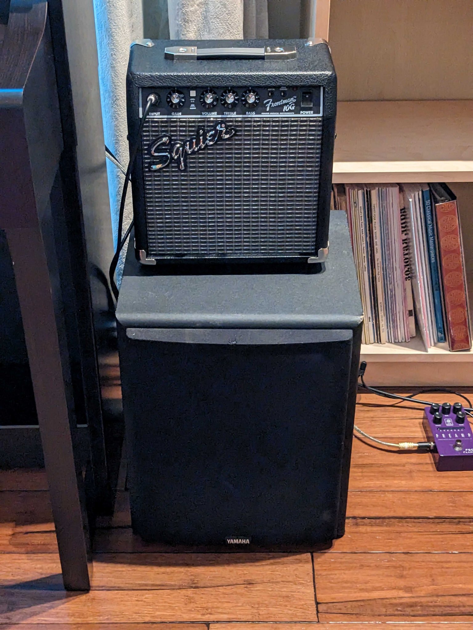

So, I am trying to understand what my bookshelf speaker (photo above) claims. I realize that most of the claimed wattage is marketing and has little to do with reality. This ELAC though is supposed to be serious, so the numbers should be interpretable. I see 6 Ohms nominal impedance, which probably means the resistance to DC? It also says max power 120 watt, which I interpret as peak. If those are correct assumptions, I get
120 watt = v_peak^2 / 6 ohm,
which gives me peak voltage that the speaker is likely to withstand to be
v_peak = sqrt(6 *120) ~ 27 volt.
My existing 2.1 class-D is powered by a 24VDC supply - the second board in the pic above. So... with this setup, I should be safe, right?
P.S. If the max power means RMS though, then peak is sqrt(2) larger, which puts it at 38 volt - even safer because I will only get peak of ~21 volt from this class-d with this power supply. Right?
I hope I'm not too late, and that your ELAC speakers have not already been destroyed. Fingers crossed.
Speaker wattage ratings tend to be a can of worms at best, and even worse than that (what's worse than a can of worms?) for speakers made by today's marketing-driven companies that long ago lost all concept of truth in advertising.
Let me give you the bottom line first: if you were to apply 10 watts RMS of sine-wave audio power to your speaker at a frequency of, say, 5 kHz, I can almost guarantee that your tweeters will fry within seconds.
(And by "fry", I mean that the voice coils will overheat to the point of complete mechanical and electrical failure, as the baked-on varnish insulation on the hair-thin voice coil wire turns into charred carbon.) The tweeters will be destroyed. They will need to be replaced, if ELAC will actually sell you replacements. If not, you're out the entire price of your speakers.
If you use this type of speaker for live sound, as I think you intend to, its quite easy for the scenario I outlined to occur. Simple acoustic feedback ("howl around") should the microphone get too close to the speakers would do it. Your tweeters would fry before you could get to the volume control to turn it down. Those ELAC monitors are not cheap, and I don't think you would be at all happy about this scenario.
So forget about 120 watts, RMS or otherwise. Forget about even 12 watts. What you actually need to do is restrict maximum power into the tweeter, worst case, to no more than, say 5 watts. Otherwise your tweeters are living on borrowed time. 🙁
As I indicated months ago, the key is very low power supply voltage to your class-D amplifier. If you lower your amplifier power supply to 12 VDC, maximum power into a 6-ohm load drops to about 8 watts RMS, which your tweeters might tolerate long enough for you to leap at your volume control and turn it down. Your current 24V power supply is far too much for this type of use - using that much power supply voltage is practically begging for your tweeters to be destroyed. 🙁
It would be quite a wise thing to do to insert a 12-volt, 12-watt automotive incandescent (filament) light bulb in series with each loudspeaker wire. This will give considerable protection to your expensive speakers - as speaker current approaches 1 ampere RMS, the tungsten filament heats up, its resistance increases dramatically, and this keeps speaker current from rising to levels that will fry your drivers (particularly the delicate tweeters).
The light bulbs will have some unwanted side effects (including power compression and likely changes in frequency response). But those are minor problems compared to total destruction of the tweeters in a $250 - $300 pair of speakers.
Note that this only works with incandescent light bulbs, not the new-fangled LED replacements. Incandescent automotive bulbs are starting to get thin on the ground now, so if you plan to go this route, snag them quickly, before LEDs replace them all.
The exact model of light bulb doesn't matter. It's the 12-volt, 12-watt rating that's key. This basically means that the bulb has a designed operating current of roughly one ampere (running on a 12V auto battery). In series with your loudspeaker, it will more-or-less limit maximum current to 1 ampere, preventing your tweeters from frying. (It might be rated 12.6 V or 12.8 V - that's of no consequence. Basically it's designed from a nominally 12-volt lead acid battery.)

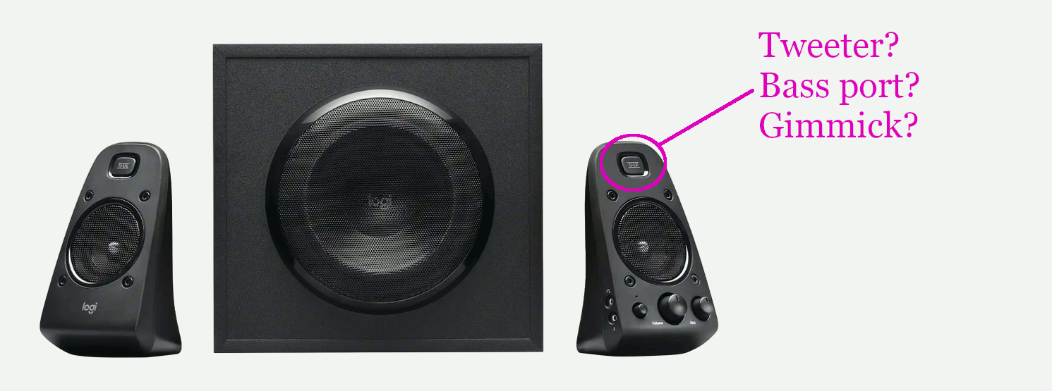

I have an alternative hookup too, mostly used by my daughter on bass in another room: her bass multipedal has an XLR out, which could be used in parallel with the regular ubnbalanced line out. So I hook up my cheap fender guitar amp to the line out, and an old Yamaha home theater subwoofer that I had in the garage to the XLR out, and the resulting sound is pretty satisfying for her and me.
(In fact, I accidentally stumbled on an infinite sustain that I get if I hang the bass on the wall in the usual slot, which is close to the sub, and gently pluck one of the strings - it keeps the bass tone going forever. 🙂 )
If you like how a bassline sounds than my fav Z623 would sound even richer and deeper and prolly louder than even the Yamaha subs that I know. From the sounds of things I gather that you and your daughter also prefer a bassline over percussive banging and slapping played on a bass instrument. Also if you main interest is rock type stuff than again you might want to cut more of the lower bass and add a tweeter to the sub 😀

Electric guitar to Yamaha MG12UX console to Logitech Z623 2.1 speakers. Nothing blows up at even very high volumes and just smashing away at the strings. Three mics plugged in and on as well as a bass guitar. No feedback or blown tweeters. No tweeters to blow up!! The satellites have very capable full range drivers designed to create THX levels of sound and cope with massive dynamic range. Problem solved 😉
Interesting!Randy Bassinga said:Nothing blows up at even very high volumes <snip>
The Z623 was probably designed to survive loud shoot-em-up video games, which might be one reason your guitar doesn't kill it.
The usual trade-off for increased speaker toughness is reduced audio quality (i.e. a more restricted and more uneven frequency response.)
Unfortunately the best-sounding tweeters tend to also be the most delicate ones.
Interesting, because omitting tweeters drastically limits the high frequency response of a speaker system.Randy Bassinga said:No tweeters to blow up!!
I found a pic online - what are those rectangular doodads near the top on the front panel of the Z623? (See attached pic)
Those things aren't piezo tweeter horns by any chance, are they?
I have an old Yamaha electronic keyboard (PSR-E4-something-something). Like most of these keyboards, it has little power amps and a pair of speakers built in. And those speakers, obviously, survive whatever the keyboard can throw at them.
I think low maximum power output (from the built-in power amplifiers) is likely a key factor.
The keyboard appears to have two tweeters, one at each end. They look like dome tweeters, but I suspect they are actually piezo tweeters. A lot of older boombox and mini-component speakers contain five-cent piezo tweeters disguised with a Mylar dome over the top to make them look like dome tweeters.
Piezo tweeters sound nasty, but are very hard to kill. Supposedly you can crack the ceramic element if you feed it sufficiently high signal voltage, but it takes a lot of voltage to do it.
Raising the tweeter crossover frequency quite high - 5 kHz, say - minimizes the nasty sound quality of the piezo tweeters. This might be what Yamaha does in their keyboards.
Yamaha also plays tricks (custom EQ) to make those tiny speakers in those tiny plastic enclosures create tolerable quality sound over the entire frequency range of the keyboard.

Gnobuddy, that was designed to THX specs, it says so on the item with a big bright logo. I think you know very well what the THX specifications are and the minimums for sound quality that is acceptable under the standard. I think speculating on an item that you have never heard in person is not very productive and as can be seen that the speculations are way off the markThe Z623 was probably designed to survive loud shoot-em-up video games, which might be one reason your guitar doesn't kill it.
This is starting to sound silly as parts express browse shows plenty of tough drivers in the PA catalogue that are also highly regard in the Hi-fi community
What does delicate tweeters have to do with bass anyway? If you have your filters right, they will never see any input! Anything else is not bass. If the guitar output of your flamma is frying drivers then your gain staging is off! As a line level output, it should be well able to set a correct output signal to drive any power amplifier and your patches should include compression and such to give its output stage a safe signal. Check your settings and patches
Disagree, Parts Express catalogues plenty of full range drivers that appear to be highly acceptable in this community. You must realise that there are even full range drivers in high-end PA vertical arrays and thingsInteresting, because omitting tweeters drastically limits the high frequency response of a speaker system.
Review the dangers of speculation, the doodads are covers for screws. Those full range drivers are delivered 35wrms each
Built-in keyboard speakers are not very capable but if you have previously mentioned listening through thrift shop bookshelf speakers that come from budget micro systems and then they can be comparable but a totally useless monitor for serious scrutinising
Seriously? Built-in keyboard speakers and their technology is totally irrelevant to both this thread and Croc's query. The one practical and serious recommendation is still a Z623 capable of ticking all the boxes in one value package that is tried and tested in both domestic and gigging

My short-term solution is a cheap Squier guitar amp jerry-rigged together with a Yamaha sub:
