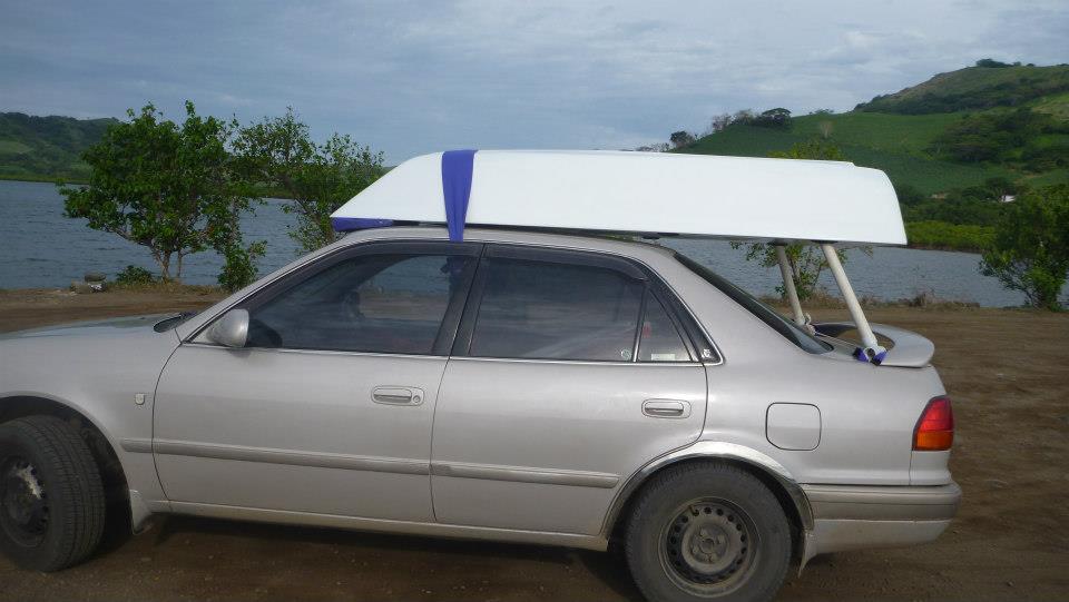

Back home, day one of new school term. The pod was awesome. It gave us so much free space in the car, made travelling much more comfortable. Currently covered in over 2000 km of bugsEven if you had to pay $1000 AUD for a roof-top box made of it?

You know, you are lucky, that means Australia still hasn't lost all its insects....The pod...Currently covered in over 2000 km of bugs

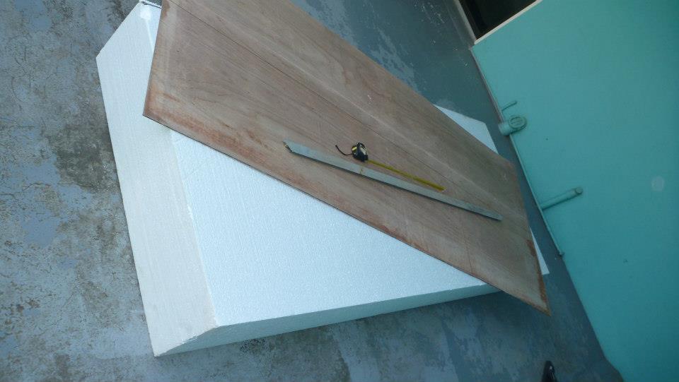

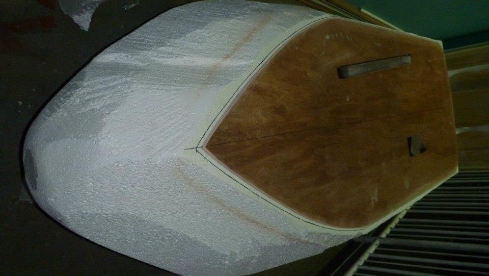

That's kinda what I was thinking. Dunno if I have the skills and access to the working space, materials, and tools needed to build one out of HDPE, but old hard-plastic suitcases are out of fashion, and therefore cheap at thrift-stores; a large one of those could serve as a roof pod.Gnobuddy, if I had to spend that kind of money, I would make one instead.
That is a brilliant idea! 👍 If you're the entrepreneurial type, I suspect there would be a market for that product....a car topper skiff that doubles as storage pod...
Cool Styrofoam boat!
(Now how about that Styrofoam bass guitar speaker? )

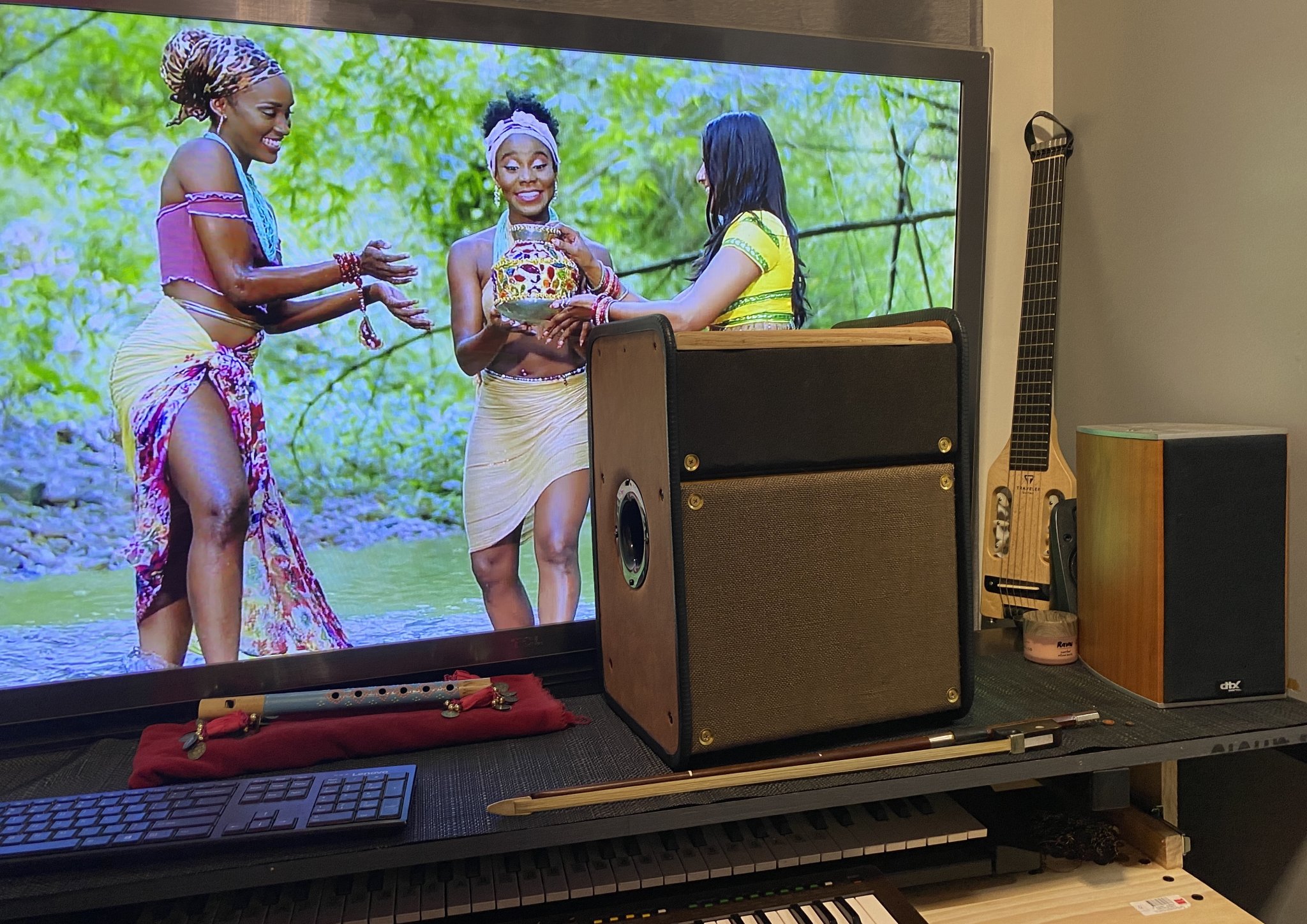

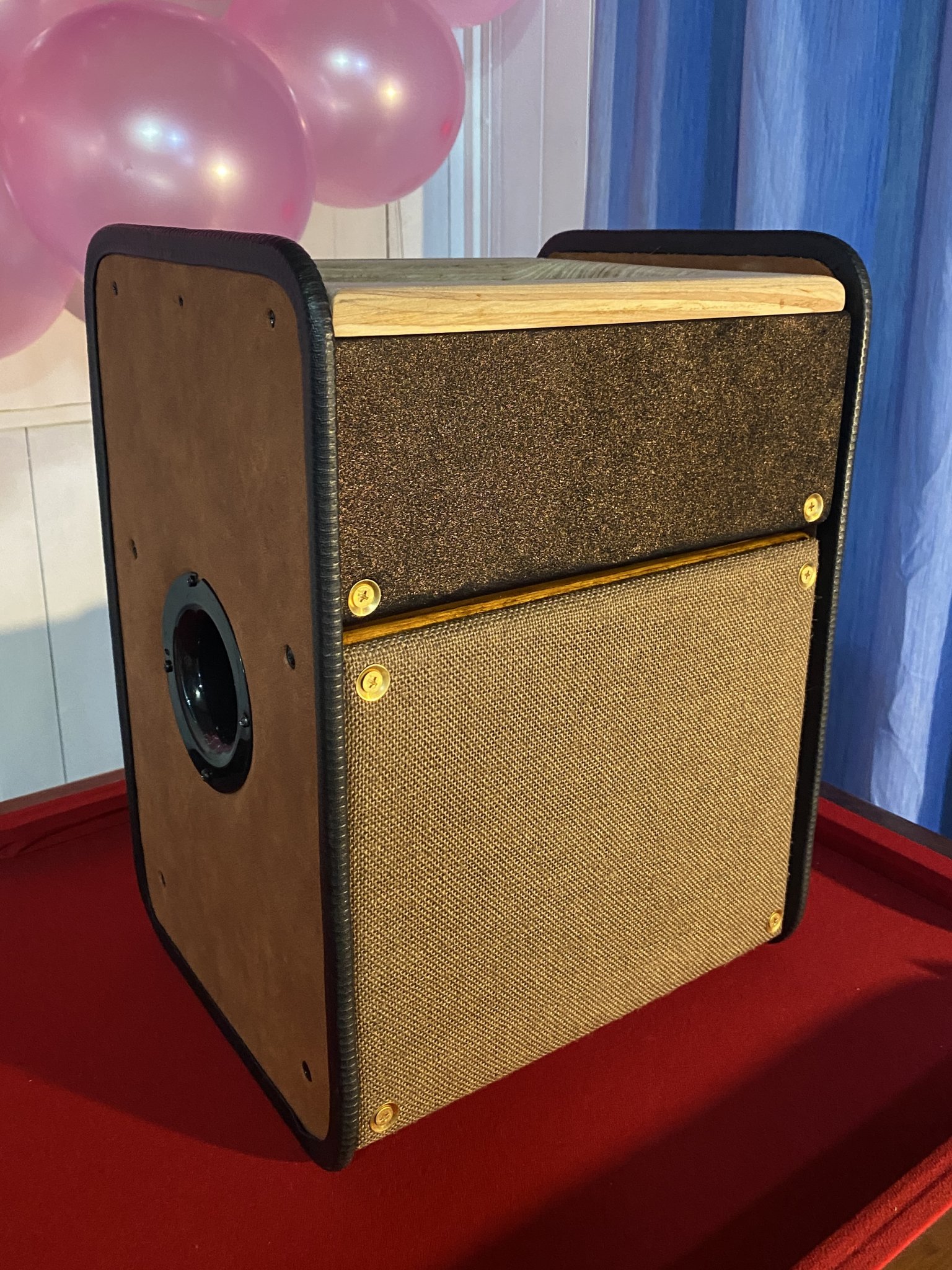

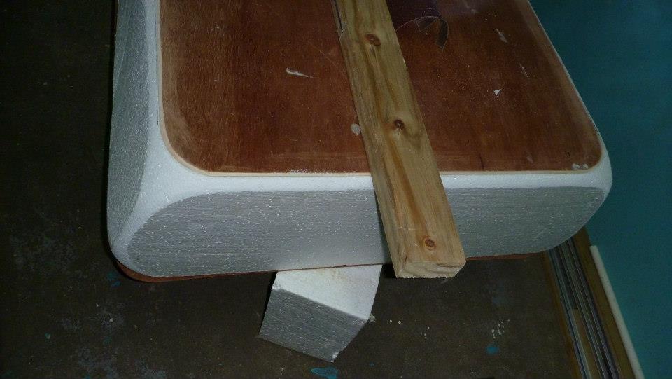

Taking some time away from renovations to update the thread. Cabinet construction is now complete for preliminary stage. Amp functions as intended
Currently fitted with guitar input socket, preamp, volume control pot. This feeds the low frequency amp and driver. Tops and tone controls not yet implemented. The amp has been in use for two weeks classes now and teacher is impressed
Also did a demo at the local music shop, they haven’t heard anything this authoritative in a package this small and again very impressed reactions. The shop is looking forward to the tops being implemented to see how it goes as a synth and drum amp. I have been asked to put one in the shop after sourcing a safety certificate
Now I have to sort out the tone electronics. Then I’ll start on the larger project which is a build from scratch using a 10” dvc 400wrms driver and two 6” full ranges in a package not much larger then the Logitech build. I intend to use a four channel tp3255 board for power and trying to find one with a decent build quality. I already have the speaker drivers for this project as well as eight 5670 tubes for the pre and tones

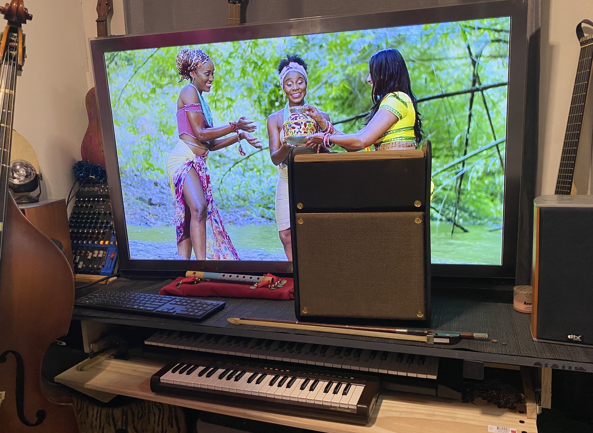

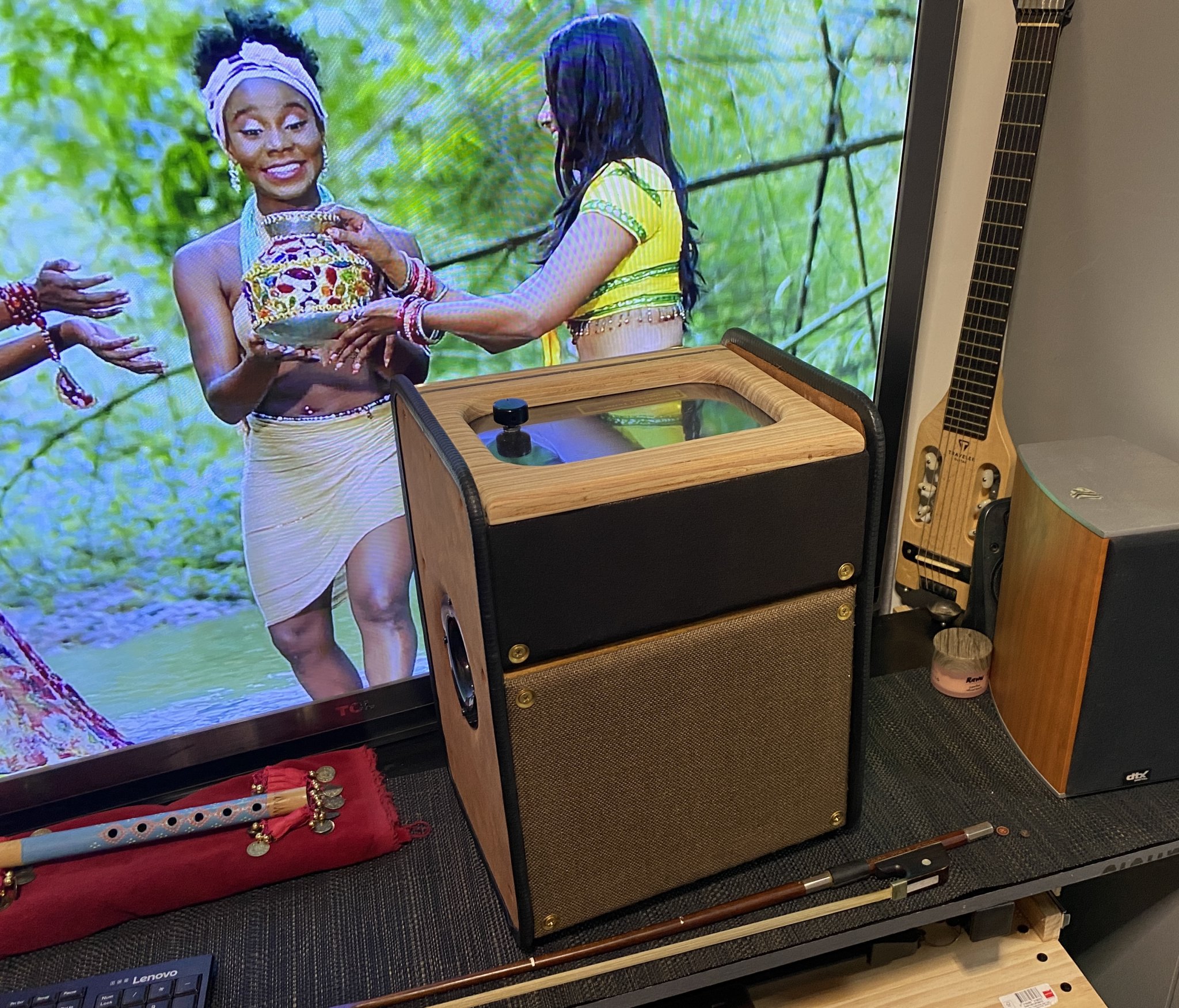

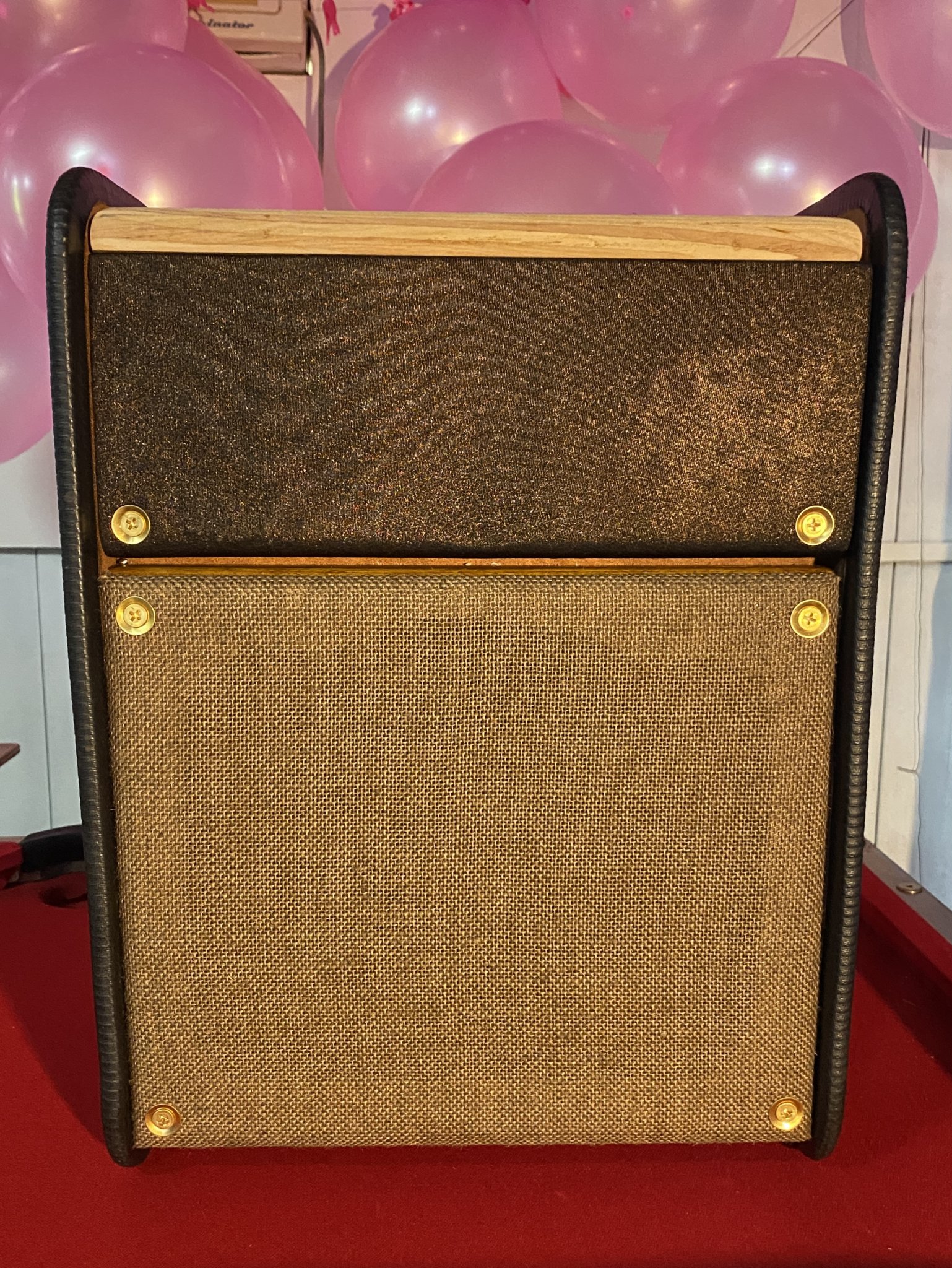

Some pics of the completed cab for the Logitech affectionately called “Lil Terrors z623 Mod”
I would appreciate some feedback good or bad to fine tune the cosmetics. For example, I am changing the side protective plates to a thicker sheet material and using edge trims in tan colour

Wow, that looks great! You have exceptional craftsmanship skills....some feedback...
IMO, the only thing missing is some sort of logo, especially if one of your creations is going to end up sitting in a music shop where members of the public can see it.

Gnobuddy, thanks for the kinds words. I enjoy working on the aesthetic process. Notice how the side plates form ears or lugs at the top. Originally, I wanted to have a pair of handles cut into that area. But my head section grew too tall, and now that strip of upholstery fabric showing is becoming more and more of an eyesore
Also, the edge moulding trim can only accommodate 4 mm, which forced me to use 6 mm ply as the side plates and rebate the edges 1 mm on each side to flush fit the trim. The Problem I now see with it all assembled is the illusion that the walls are too thin for a bass box. What isn't apparent is that there is the actual original enclosure inside the new shell. This looks wrong
The top plate, the bit of birch plank I had left, was 3 mm too short to fit clean. I rounded over the sides where it almost meets the side plates in an attempt to disguise the gap and fill down the gap with a weather strip. This didn't work and looks like another area not very well implemented
I am going to build a new enclosure based on the Logitech box dimensions and make it just a bit taller to have a partitioned compartment for the head. This will let me do away with extra side plates and allow for a much shorter overall box. Will upholster it the same and run wider trim along the edge of the side panels in a tan colour, The side panels will still stick up like ears but not to form handles. Instead, they will be a touch taller than the knobs for protection
The birch looks ok in that position, especially in its natural colour instead of the silly stain I put on earlier. But, this top area can look better. I am entertaining the thot to use only a thick perspex as top panel. I have a trick where I print knob labels on a transparency in negative and stick it over the perspex panel. I stick aluminium foil under the panel. Then I wrap the whole panel in dark auto window tint film. This gives scratch protection and a dynamic instrument panel. Step drilling into that panel and gluing in LEDs at the appropriate points will make that light up when powered on
If I had a thinner slice of a nice dark heartwood, then it would have made a nice top panel trim. Will go look at some flooring slats at the reuse centre tomorrow
I still need to sit with the materials that I have been collecting for decal work and brew some thots

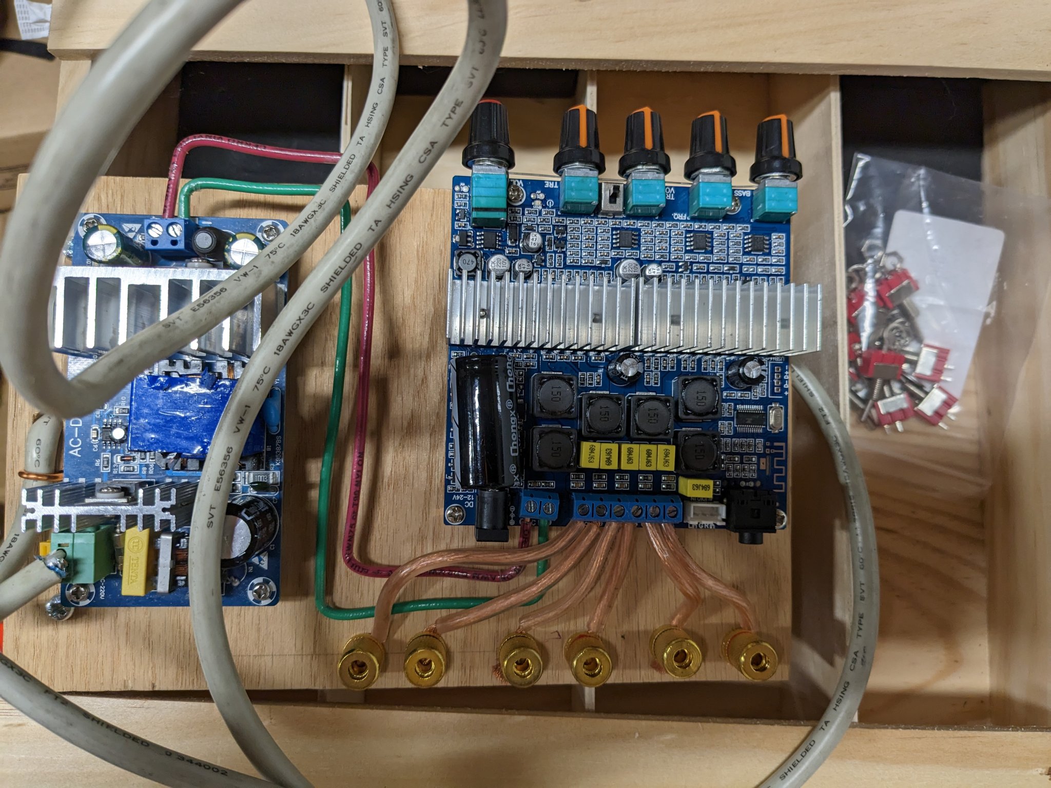

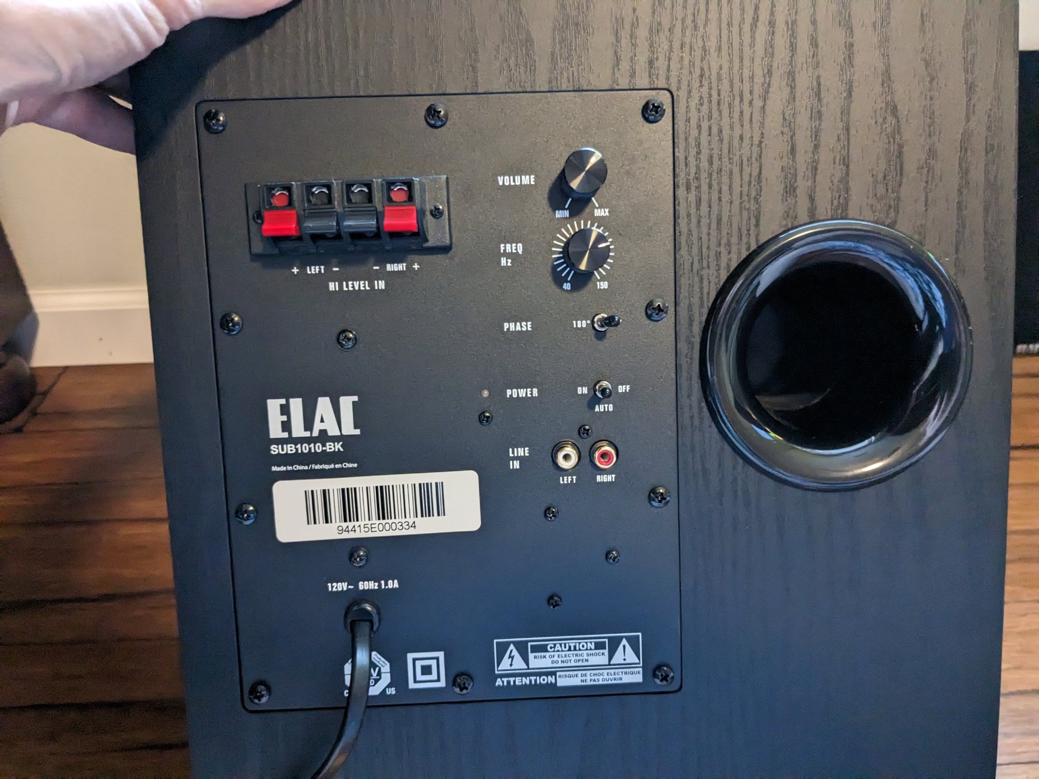

@Gnobuddy and @Randy Bassinga, apologies for resurrecting a year-old message but I have a specific question for just the part I quoted: how does a dedicted cheap class-D board replace the need for the filter? It is probably a novice question. I understand it like this: if I send speaker output to several hi-, med-, low-frequency drivers, the sound levels from these drivers will be too different and random, and, also, they will probably shunt/short each other, so, for each driver, I need to remove the part of the spectrum that is not going to be reproduced by this driver. But, if I have a dedicated amp for each driver, each driver sits on the output by itself, and the level can be individually adjusted, so no need for filters....
Project 1 is to create a full-range powered speaker system using the existing subwoofer, paired with some smaller drivers for higher frequencies.
Then there is project 1. Do you really want to DIY all those active filters? It's a lot of complexity to deal with, and the end result is still hit and miss, because you don't know what the frequency responses of your individual speakers (subwoofer, satellites) is.
There is an alternative: class D 2.1 channel amplifier boards, like this one: https://www.amazon.com.au/Amplifier-DROK-Channel-Stereo-and120W/dp/B09B32RCX2/ref=sr_1_4?crid=MQBOH7HWHNQ4&keywords=2.1+channel+amplifier&qid=1646941179&sprefix=2.1+channel+amplifier,aps,81&sr=8-4&th=1

Is this about right?
In general it doesn't - but the specific board I linked to actually consists of three separate class-D power amplifiers, and also includes active filters. It was designed for "2.1 channel" use, so there is a low pass filter feeding a dedicated subwoofer power amplifier, and two high-pass filters feeding dedicated power amplifiers for the two satellite speakers.how does a dedic(a)ted cheap class-D board replace the need for the filter?
Because those filters are already on the board, you don't have to build additional filters, as Randy was originally planning to do.
If you search for them, you'll find other "2.1" power amplifier PCBs for sale. All the ones I've run across integrate the three necessary filters onto the same PCB.
No, unfortunately it's not that simple.But, if I have a dedicated amp for each driver, each driver sits on the output by itself, and the level can be individually adjusted, so no need for filters.
The trouble is that the subwoofer will make nasty noises at frequencies too high for it to handle properly, while the satellite speakers will make nasty noises at frequencies too low for them to handle safely. They will also rattle themselves to death if fed too much power at frequencies that are too low.
Tweeters are particularly fragile. Good ones are usually designed to work only at frequencies above 2 - 3 kHz. You have to ensure that frequencies below that are removed before the signal reaches the tweeter, otherwise the tweeter will fry in short order.
-Gnobuddy

@Gnobuddy , once again - thanks! This is very detailed and really up my alley! Now that I feel like I got some basics, I will try to describe - in a separate thread - what I specifically have in mind, and I will ask you and everybody to critique it.
Yes! In fact, I do have a minimal multi-effect contraptions for both bass (this) and acoustic (this). The bass one also works fairly ok with the electric guitar (to my unexperienced ear), and I got this simple fuzz pedal from the same brand - mostly because of the sentimental value since Gilmour supposedly uses fuzz rather than distortion.
I never really planned to plug any of my instruments very directly into a subwoofer or speaker. In fact, I assumed that one does not do that because the electric guitar tone needs to be created somehow. In hindsight, it was a bad assumption - I did not realize that traditionally, people used the amps and cabinets to create tone!
The last component that I would like is a mixer - I also got that idea from your conversation with Randy from a year-old thread. But let me stop hijacking this thread - I will create a separate one for my imagined setup.
Thanks again!
This is roughly what I had in mind - except I did not know about the Flamma preamp until I learned about it from you in a different thread. My thought was that I would create tone with pedals/effects, and I would amplify it with a transparent PA as needed. It took me a while to realize that this is not a very natural way of thinking in the electric guitar world. Tone and amplification usually go together in people's minds it seems....I've obtained quite good results playing electric guitar into a small pair of thrift-store "mini Hi-Fi" speakers driven by a little class-D power amp from Amazon. The key to good sound is the addition of a Flamma FS06 Preamp between guitar and power amp...
...It's probably a good idea to look for some similar pedal or multiFX processor for your daughter's bass. That is more likely to get you acceptable sound than just plugging the bass into a subwoofer....
Thanks again!
Randy, I'm happy with mine: it's is not terribly fancy but not a boombox either: I have a pair of bookshelf Elac speakers and an Elac subwoofer connected to a 2.1 class D board. They sound amazing, even compared to an older Marantz 4.1 that I have in the garage, which is also excellent.
Cool man, you should be able to have a close listen to the lil video that I linked in pm. What do you think tone and authority wise? I can't hear any mic rumbles or anything that peeps advising low filter keep saying is needed. Tone sounds fine to me too and nothing like what people think would happen straight into a sub. Deep low bass records just fine from a subwoofer driver without any filters. I have many such recordings, but wary of posting vids of any kids. Bottom line is there is nothing better than first-hand experience. Everything else is just speculation, never mind how educated
At home, I use a pair of Alesis Monitor One MkII near-field studio monitors as my main speakers, with a Velodyne subwoofer filling in bass below 70 Hz or so.how is the low frequency extension and ability of your music listening system? I mean, does your stereo do bass?
It's only the smallest little 10" sub Velodyne makes (made?), but it does a pretty good job reproducing deep low-frequency rumbling sounds from today's movies, and I can also clearly hear low notes from a 5-string bass guitar.
A few years ago I generated some low-frequency sine WAV files using Audacity, and tried playing them through the sub. IIRC, in our living room, the sub does a pretty good job down to around 35 Hz.
IMO the Monitor One Mk II are very nice speakers (and I once shared an office with the two engineers who designed them, so I got an inside look at how hard they worked at getting surprisingly good performance out of them on a budget price).
I was lucky and got my monitors at an absurdly low price because passive studio monitors had recently gone out of fashion, having been replaced by active ones.
