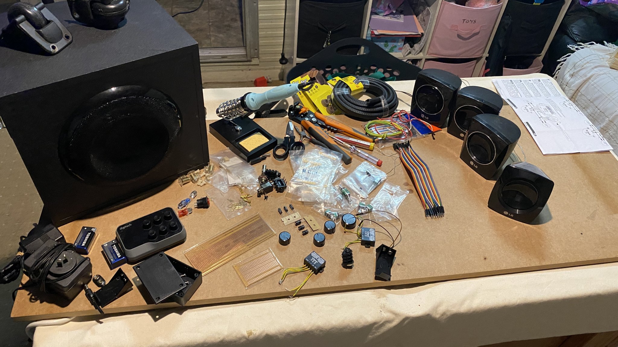

Hi all, trying to assemble a music system that a tri of year 4 primary schoolers may plug various instruments into for practice. This needs to double up as a bass amp for my daughter for her electric bass classes at school. She is used to the little sub plugged into our mixing desk at home and like me she hates the weak uninspiring sounds that the usual suspects in the music shop make in the sub $1500 mark. Our usual listening and playing stuff is West Indian including dub
For $35 I found a group of four Logitech 2.1 systems that included the one that was the same z623 model sub we use. Issue was that this one didn’t have the satellites in lot. The left satellite contains the controls and plugs into a DB15. The right satellite plugs into a dedicated rca. Rear panel also has rca and 3.5mm inputs. The missing satellite has another 3.5mm input as well as headphone out, bass level knob, volume knob
In that lot there were satellites from LG as well ones for the other smaller three subs
I have a little USB/battery powered mixer with Bluetooth, instrument in and aux in
Also have two Kemo M040n black box preamps, 18 volts of battery, 18v dc wart, 9v dc wart, pots and passives for passive tone controls, passives to build four sets of the MPF102 jfet pres from another thread
Add to the list some knobs, wheels, mdf, marine ply, upholstery fabric, carpet, retractable handle from bag
Hoping to fit the sub and a pair or two of satellites into another new box and something the gyals may plug things like electric bass, upright bass pickup, mic, electric guitar, electronic drum set, tablet and like. Basic controls to find basic sounds

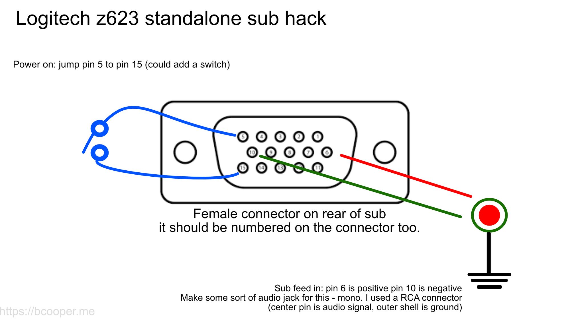

First challenge is to decode the DB15 pinout. I know that the pins for discrete input for the sub section and standby from the net searches. Plugged into this pin with the little mixer and bass guitar sounds sweet but the loudness is absent. Swapping the satellites from the home system and plugging the mixer into that returns the loudness

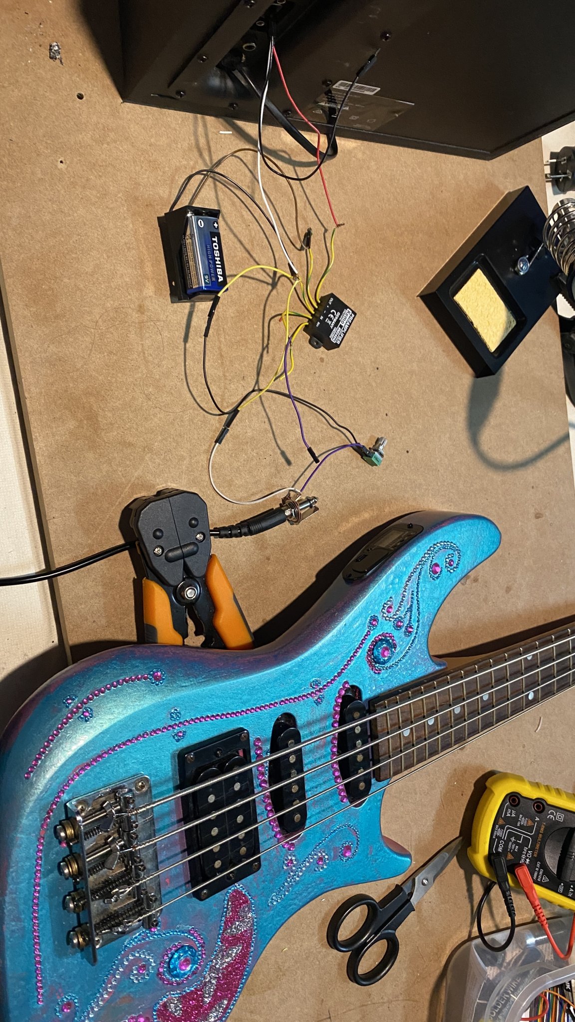

Old electric guitar converted to bass strings. With my bridge tuner mod and locked at nut, kid friendly and won’t go out of tune. 25” scale. Stock electric guitar pickups handling four bass strings just fine it seems. Anyone know why?
Bass plugs into Kemo pre via 10k pot and pre plugged into sub direct in. No tone adjustment at the moment but sounds amazing so far. The pre did the job. Next test will be 18v via battery for the pre and then plug pack power to see if all stays noise free
This is the hack for discrete input to the sub amp. The blue loop is the standby power. I would like to place a pretty looking switch there with an indicator LED. Can anyone please help with the correct procedure for measuring the voltage on that loop and if that can power the indicator LED?
Tried the Kemo pre with 18v. Sounds very good. Every fret comes through with authority and is musical at even very high volumes and as most know, the Z623 can get loud and carries a THX rating (if that means anything now, some years ago folks used to wet themselves on seeing a THX badge. I think only Yamaha decided to ignore THX. I have only had higher end Yamaha HT receivers, so my THX experience is limited to the Z623 and the 5.1 version)
I still haven't done anything with the components for tone and jfet pres. Hoping to get some assistance with someone knowledgeable with these to see if the values can be optimised for my particular use
One this about the Kemo is a hum that is not present when volume knob is full left and increases with volume increase. What things can induce hum like this? Is it a screening issue or supply?
This net find appears to contain errors. I do not know enough to say this with authority. I tried to learn my way around the multimeter and then decode the DB15. For example, in that image, the standby loop is connected to pin 5. Well, pin 5 gives me positive in for one of the amp channels! I do not understand why they connected the standby to pin 5. Shorting pin 15 to ground or any of the three input channel's positive pin turns the system on. The input pins are not direct wire connections, there are some SMD resistors and caps on the PCB and there is input impedance present at the RCA and 3.5 connectors. Look like pin 5 shorted to even resistive paths to ground will turn it on. I think I have worked it out as I now have direct access to all the pins and system functions and there appears to be a logic to how the connections are implemented. I want to share my finding on this so that it may help others with this system. I'll do a post on it when I get a chance and continue carrying on like an idiot with this monologue

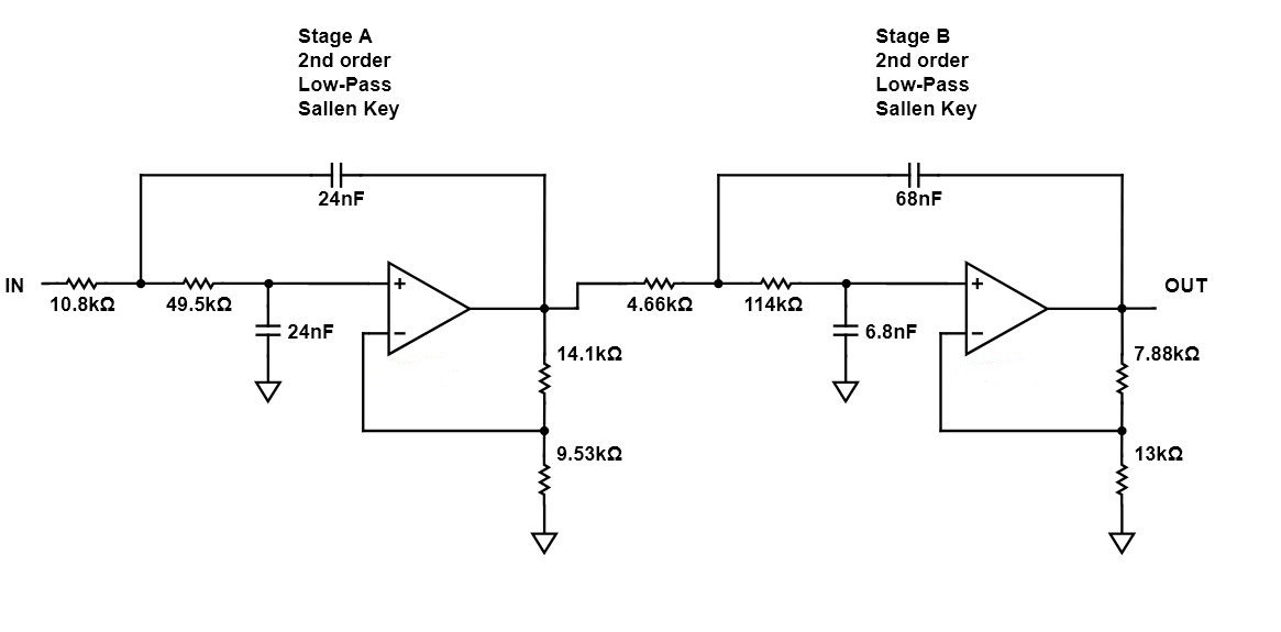

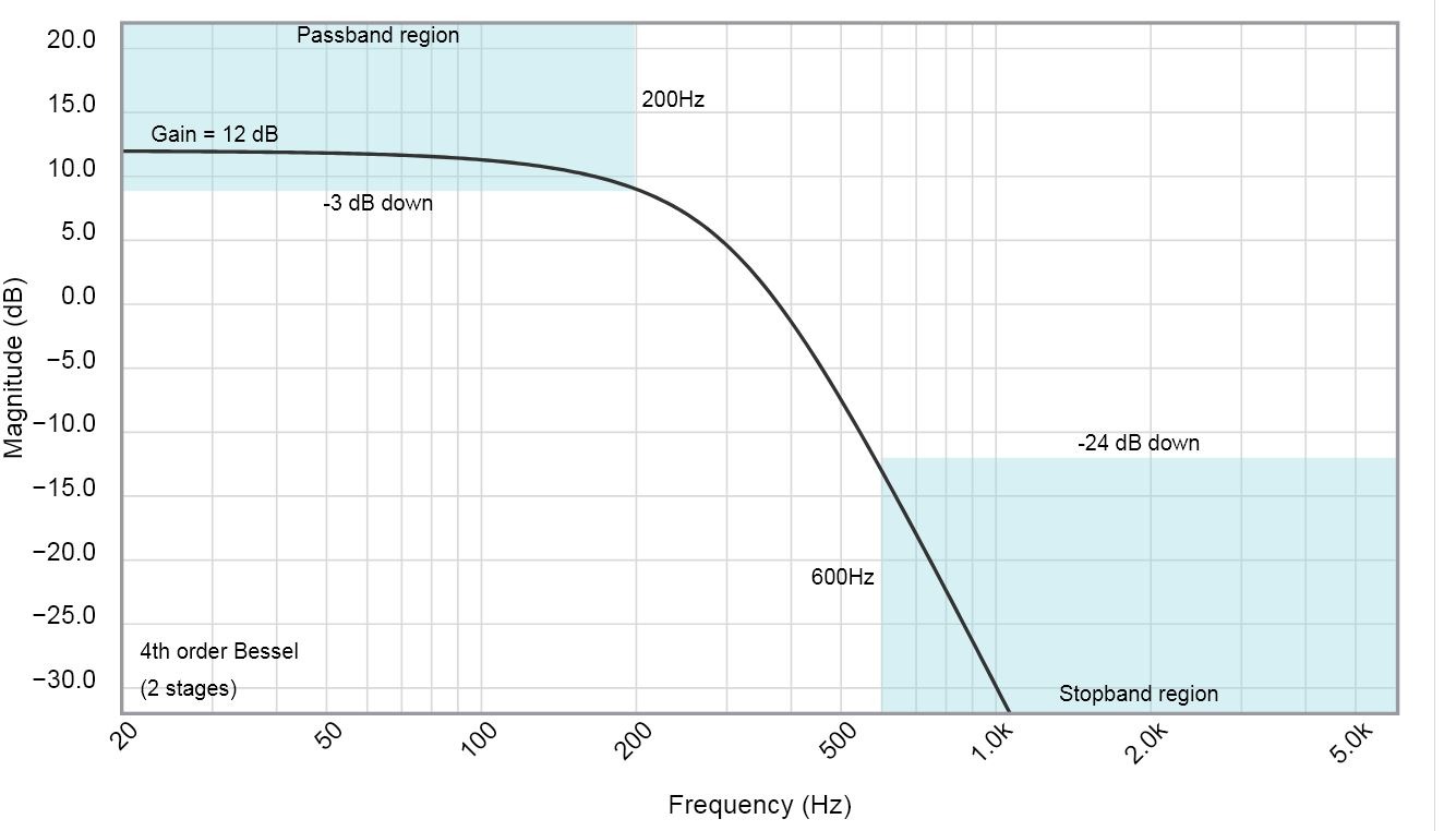

Working backwards. Going by what I have learned from reading and tools, I designed this 200hz low pass for the sub output. Using TL072 jfet opamp and +15/0/-15 dual supply. Will it go up in flames if I put this together? 🤔😱
Not if wired according to the schematic. But it's not ready for prime time:
1) The input needs to be fed from a very low-impedance source. The only way to guarantee this is to add one more op-amp, between input and the left end of the circuit you showed, configured as a voltage follower (or non-inverting amplifier with small gain if needed).
2) You will not easily find 24nF caps. 22nF is the standard value. You can make 24.2 nF by paralleling 22nF and 2.2nF, but it will nearly double your capacitor costs; why not just design for 22 nF?
3) Same issue with resistor values. 10.8k is unobtanium, 11k is standard in the E24 range ( https://www.asenergi.com/pdf/resistors/standard-resistor-values-e24.pdf ).
Note that the difference between 10.8k and 11k is only 1.8%; unless you use 1% tolerance resistors, and 1% tolerance capacitors (hard to find and expensive), there is no difference.
Similarly, 9.53k, 49.5k, 7.88k, 4.66k are all very exotic values that will be hard to find.
Bigger questions (and I am trying to be helpful, to save you money and time, not to dampen your enthusiasm): You are working with a subwoofer with an unknown frequency response, and satellite speakers also with unknown frequency response.
4) How do you know that 200 Hz is the right crossover frequency to mate them?
5) How do you know a Bessel alignment is the right one?
6) Why make a crossover network with 1% tolerance, when we don't know the speaker's own performance to even +/- 50%?
7) What sort of low-pass filter is already built into the subwoofer, and why do you need to change it?
In post #2, you wrote "...sounds amazing so far". If it already sounds good, why mess with building expensive filters that may not do anything good, since you have no measurements on the existing driver behaviour?
What I'm driving at is: if it already sounds good, why not just blue the satellites on top of the sub, or build a box around the pair to hold them together, and enjoy as-is? If you want to add stuff, rather than muck about with the existing frequency response (which already sounds good to you), why not add things that are useful, like tone controls, maybe a little overdrive circuit for some growly bass, maybe a simple compressor, which many bass players like?
-Gnobuddy
Is apparent that I am not quite there with understanding of such things to "design" a functional circuit yet
The wizard lets you choose the -3db and set a slope, e.g. -24db point. Then you have to pick how many stages. The closer the two points, the more stages needed. The next tab in the wizard lets you set tolerances. I just checked what seemed to be the closest tolerance options. Same with the component values. I haven't looked up availability yet, I just assumed that the wizard will use regular values because I thot it had a built-in component library

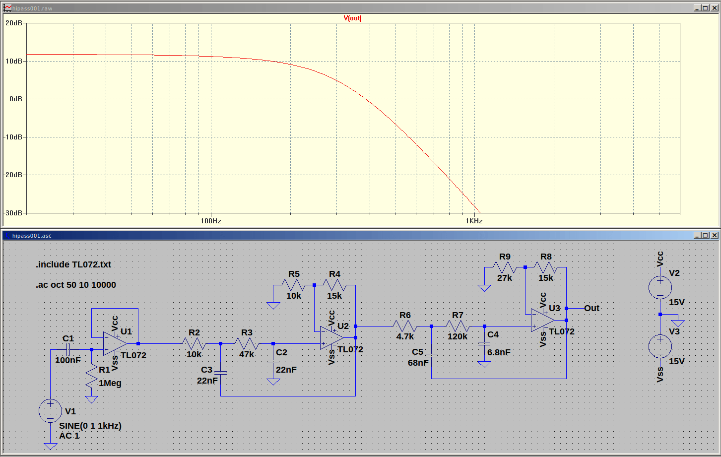

I'm attaching a functional circuit (drawn and simulated in LTSpice) that does pretty much what your own circuit does, but it does not need exotic resistor or capacitor values. It does need one more op-amp, to buffer the input.
While integrated circuits that include two op-amps are popular (TL072, for instance), there are also chips that contain four op-amps, such as the TL074, which is pretty much two TL072 chips in one.
By the way, I've never seen Bessel filters used in a crossover network. They provide much cruder frequency control than Butterworth filters, so those used to be the most commonly used ones. These days it's more likely to be Linkwitz-Riley filters, which are slightly tweaked Butterworth filters.
But before you build your active filter...let's talk about if you actually need it!
...The wizard...
Computers are still a lot stupider than people (Donald Trump excepted). 😀
The filter wizard you used crunched through some math (which computers are good at), and came up with a theoretically ideal filter. But the wizard does not have a clue about the bigger picture.
For instance, the wizard doesn't know that you are working with a subwoofer that already has a frequency response that sounds good to you, that you don't care about +/- 0.1% accuracy (but do care about the high cost of such components), et cetera.

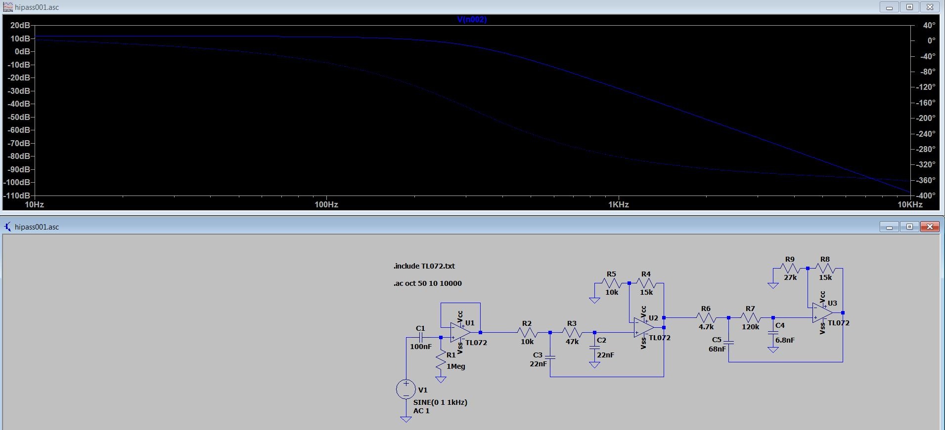

I need to find out if I can design a schematic in LTSpice and have the program run a frequency response plot
You can, indeed! I just did this, and you can see a screenshot of both circuit and simulated frequency response attached below.
I'm also attaching the actual LTSpice simulation file ("hipass001.asc"), which you can open up in LTSpice and tinker with, if you like.
You'll also need the TL072 LTSpice model, so I'll attach that as well.

I started trying to understand the low pass stage first for no particular reason, I have to understand the high pass side too
Next I have to learn about a summing stage

Am I loading and probing this correctly to display frequency response?
Looks good from here. :up:
If you're using LTSpice, under Edit, Preferences, you can change the colour of the traces, background, et cetera. A thin dark blue line on a black background isn't exactly easy to see. 🙂
What happened to the power supply in the schematic? Is it off-screen to the right? (It's necessary for the simulation to work.)
-Gnobuddy
