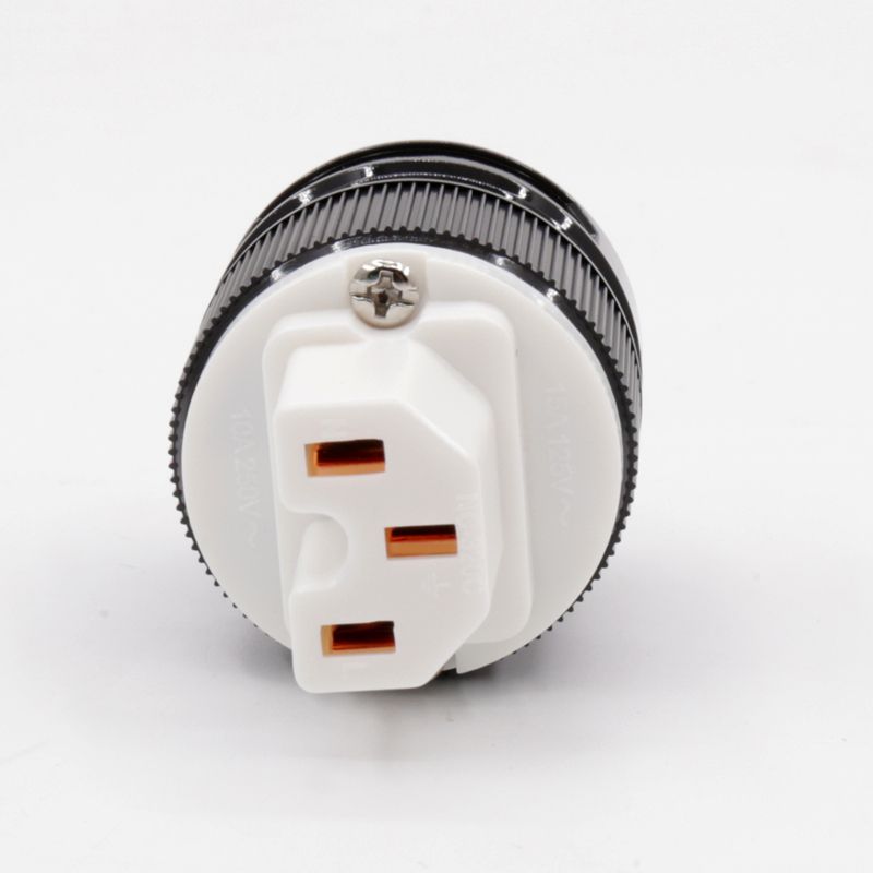

Hi Thanks a lot ! i will try one asap i really cannot stand captive cord. I know there is a point of contact more ... and i confess i also like to play a little with cables 😱This is what I used, there are better ones on RScomponents $$....
and cheap but fancy plugs 😀 for instance about iec plug the ones found on ebay are easier to use and with receptacles good also for thick wires.

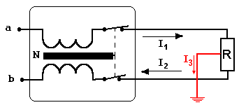

Yes the same devices all based on an invention by a chap called Schuckert in Germany (Europe) in 1903 with the name Summenstromschaltung zur Erdschlußerfassung. In a few areas in the world where 115V 60 Hz mains voltage is used instead of the more standard 230V 50 Hz twice the current should be delivered also through way thicker cables as P = U x I. With thicker cabling/more copper and higher possible current mains impedance can be quite low too. As humans die from current mainly ...... RCD's or GFCI's need to be adapted.
Of course these devices only work OK when there actually IS a PE connection...and the DIYer on duty is aware that PE is there to save lives and follows safety rules. GFCI's/RCD's for whatever the same devices are called in whatever area belong to the electric items that are rarely understood 100%, certainly by laymen.
...... RCD's or GFCI's ..... Of course these devices only work OK when there actually IS a PE connection....
Please check on that.
I know a GFI will trip with no PE in sight-- it is a *differential* leakage detector. Also (in the US) a GFI without a green (PE) wire is an approvable and suggested solution for safety where a PE can not be reasonably provided. A GFI will trip-out properly on a floating source (engine-generator on rubber tires).
Depends on how you explain it. Please see the picture. English is not my language so keep that in mind. We could continue in one of my languages though 🙂
It is, for instance, a person that is the connection/path to ground/PE thereby creating a difference in currents ... otherwise it is a differential circuit yes. If the person would float in the air or be fully isolated then not much would happen. If the ground/floor would be fully isolated also not much would happen I guess.
If the person were floating in the air, like a bird on a power line, nothing would happen, no shock.
