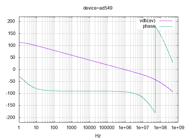

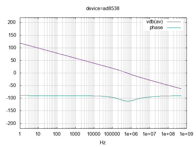

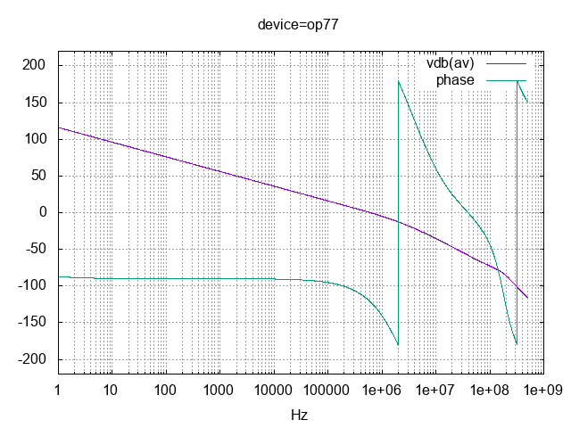

... using the adi.lib from ltspice we get 78 usable opamp models. Here the open loop gain results...
opamp stepping to the max ... 🙂 3 results shown here for example

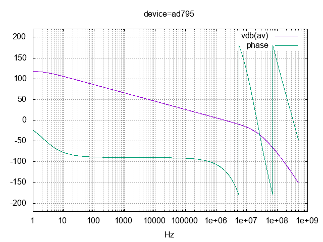

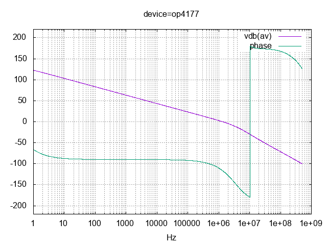

... another 48 opamps ex adi1.lib from ltspice working with ngspice ...
some examples shown here ...

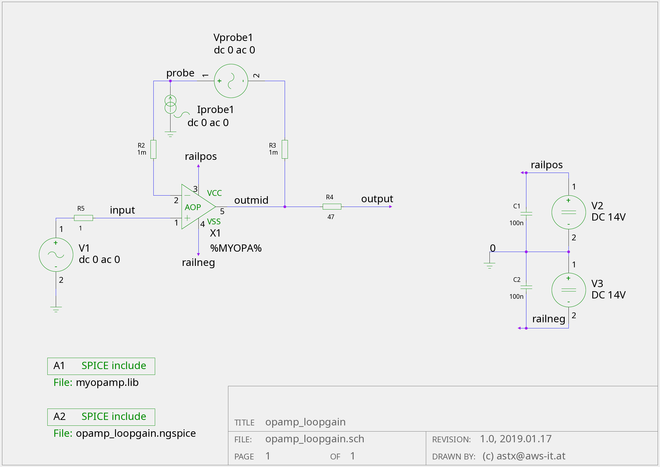

Schematic which has been used for open loop gain simulations.
BR, Toni
