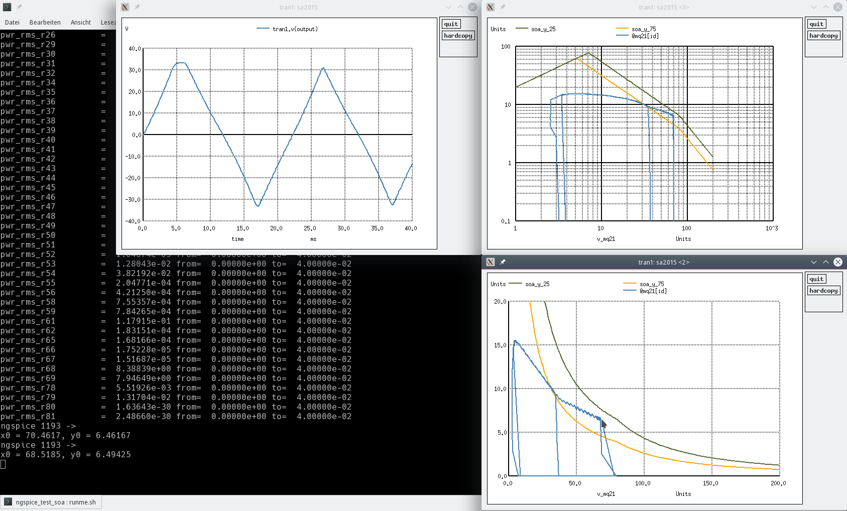

Just compiled and tested the ngspice version v30. Works!
Attached the redone SOA plot. In the zip file a small tool to calculate the soa data from the SOA lines ex log log plot from datasheets. (preliminary to demonstrate the correct formulas: "calculate_soa_data_from_log_log_plot.pl").

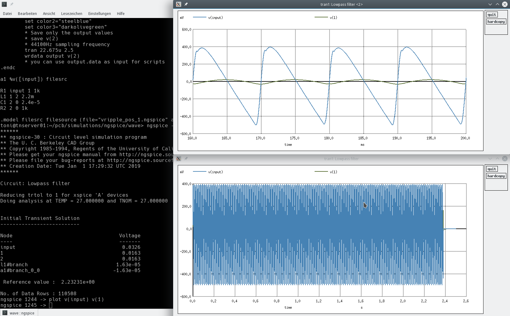

... just tested this python scripts to be able to work with ".wav" files as input/output:
GitHub - Ttl/spice-audio-tools
Works (note: you need a xspice enabled ngspice)! There are many other opensource tools to convert or view the wav files in/from any format you need ...
Have attached 2 wav files with 900mV pp ripple from my power supply simulation for your experiments. Note: european 50/100Hz !
Having fun with ngspice, Toni
P.S.: a small perl utility to generate SOA lines from only a few points ex log log scale from datasheet is in development. Maybe tomorrow ...

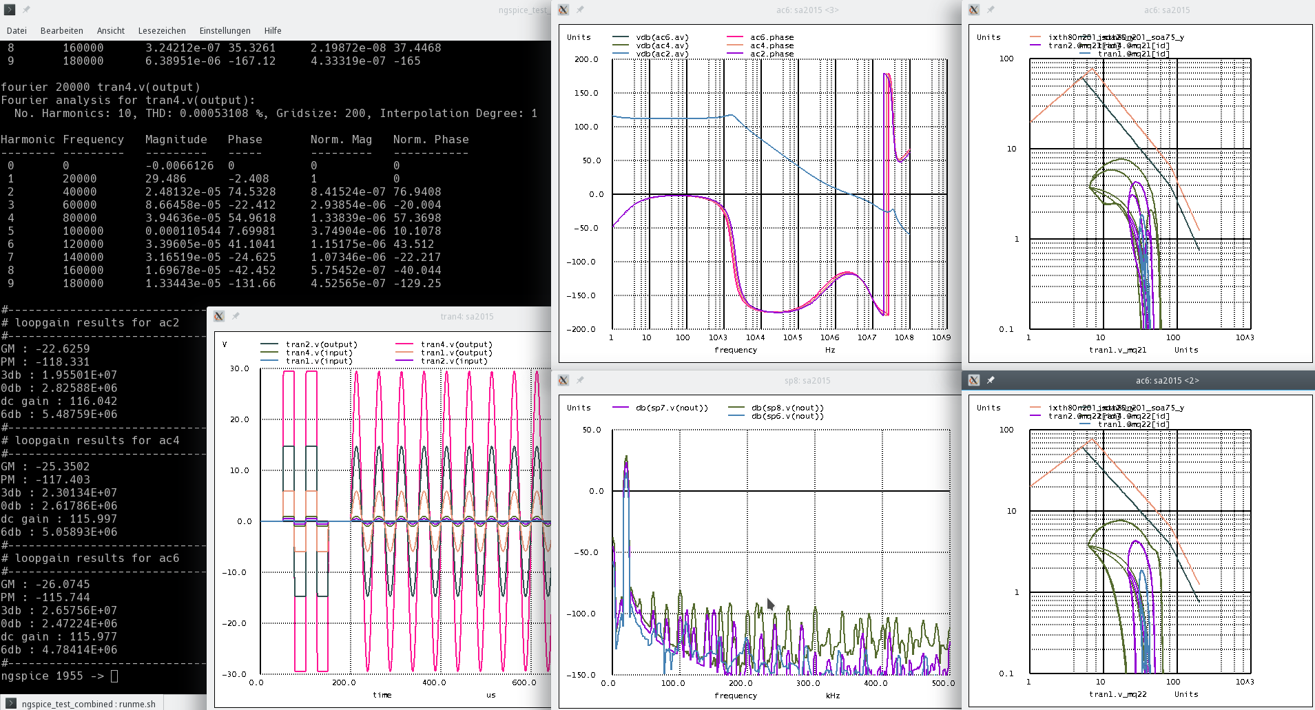

ASTX LABS - SA2017 VMOS IXYS ngspice simulation test
The ultimate combined simulation test ... That makes really fun 🙂
For test I have changed several parameters - look for "v1_level" and "compose" and "alter" strings in the "combined .....ngspice"
It is really nice to get so much data from one stepping run without any mouse click...

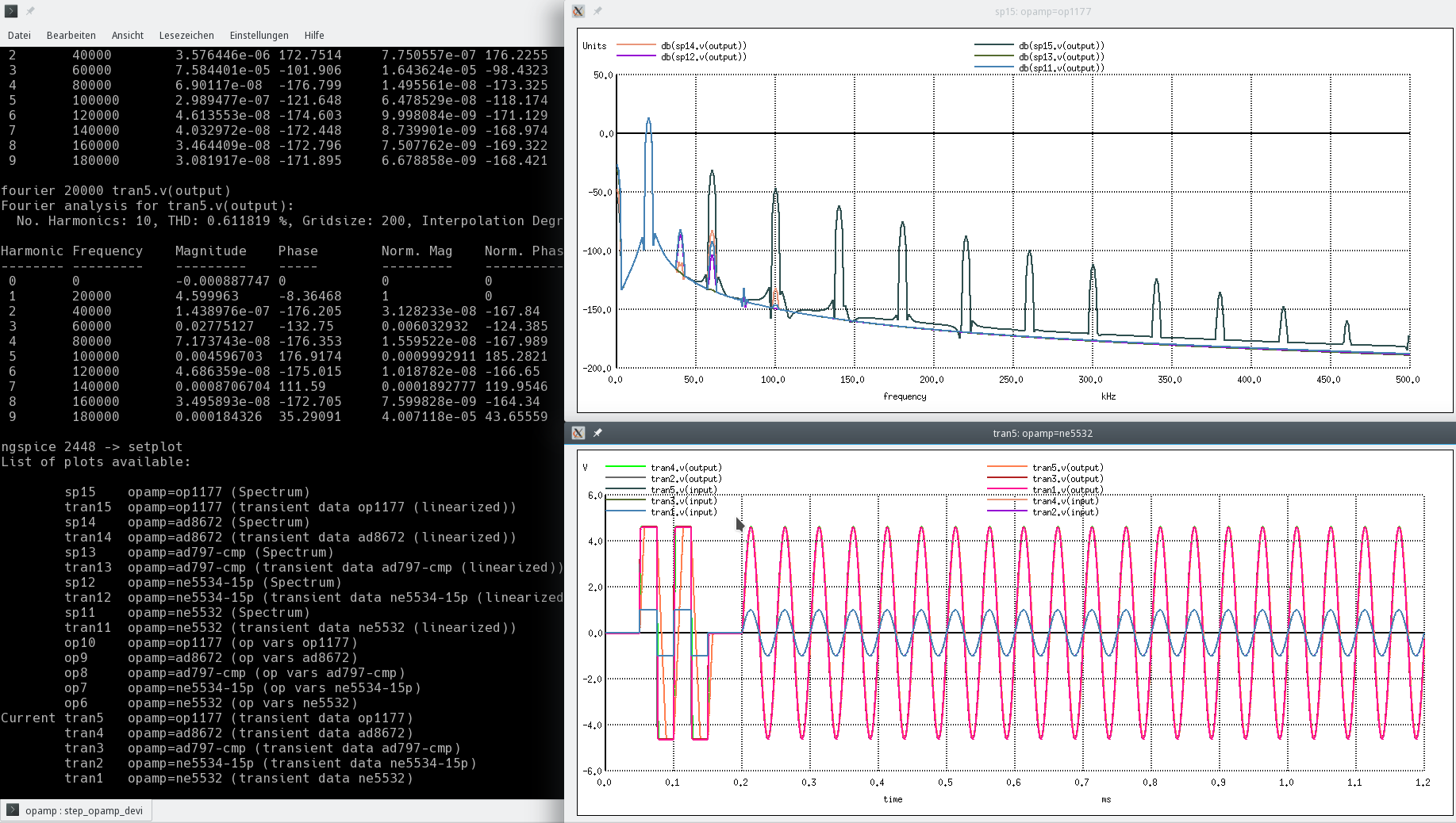

Attached an example for device stepping using different opamps.
The example shows how to use include files, save data for later evaluation.
Be warned that fft results of opamps are not very reliable!
To run the simulation you need ngspice 30 with 2 unofficial patches (developed by astx).
Hopefully the patches / functionality (included in the zip file) will find the way into the next ngspice release...
Have fun, Toni

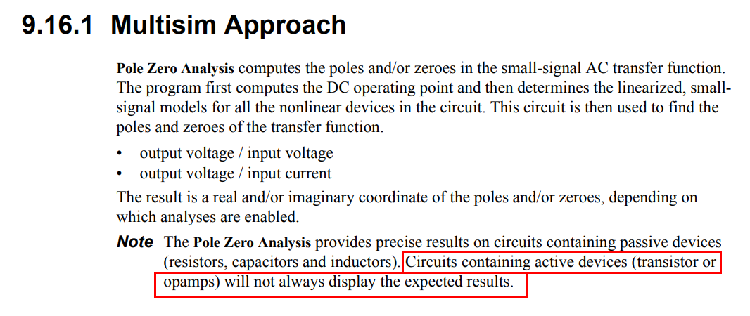

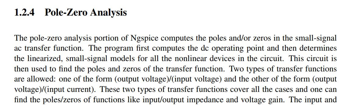

There is one feature of ngspice that intrigues me and, this is only a guess, might possibly intrigue Bob Cordell too. That is its "Pole Zero Analysis" whose description in the User Manual is excerpted below.
Is this feature actually implemented in the current release of ngspice? Is it stable, reliable, and more or less free of ridiculous oversimplifications? Bugs?
It would be VERY nice to have a way to accurately calculate "Right Half Plane Zeroes" and "Higher Order Poles" when developing the compensation strategy of an audio power amplifier. Has anyone done this using ngspice? Did it give you the right answer?

I gather that nobody has tried pole zero analysis in ngspice and thus its bugginess / robustness is unknown.
LTSPICE doesn't have pole zero analysis.
According to this version of the user manual, neither does PSPICE.
TI-TINA doesn't have pole zero analysis.
HSPICE from Synopsys does have pole zero analysis but the license fee is several hundred thousand dollars.
Multisim does offer pole zero analysis, but it employs some kind of computational approximations which don't give the right answer in the cases we care about (red highlighting in image below)​
Personally, I am happy to wait. I am comfortable letting somebody else be the pioneer who prepares test cases, uncovers bugs in ngspice, files bug reports & trouble tickets, and runs regression testing.
_

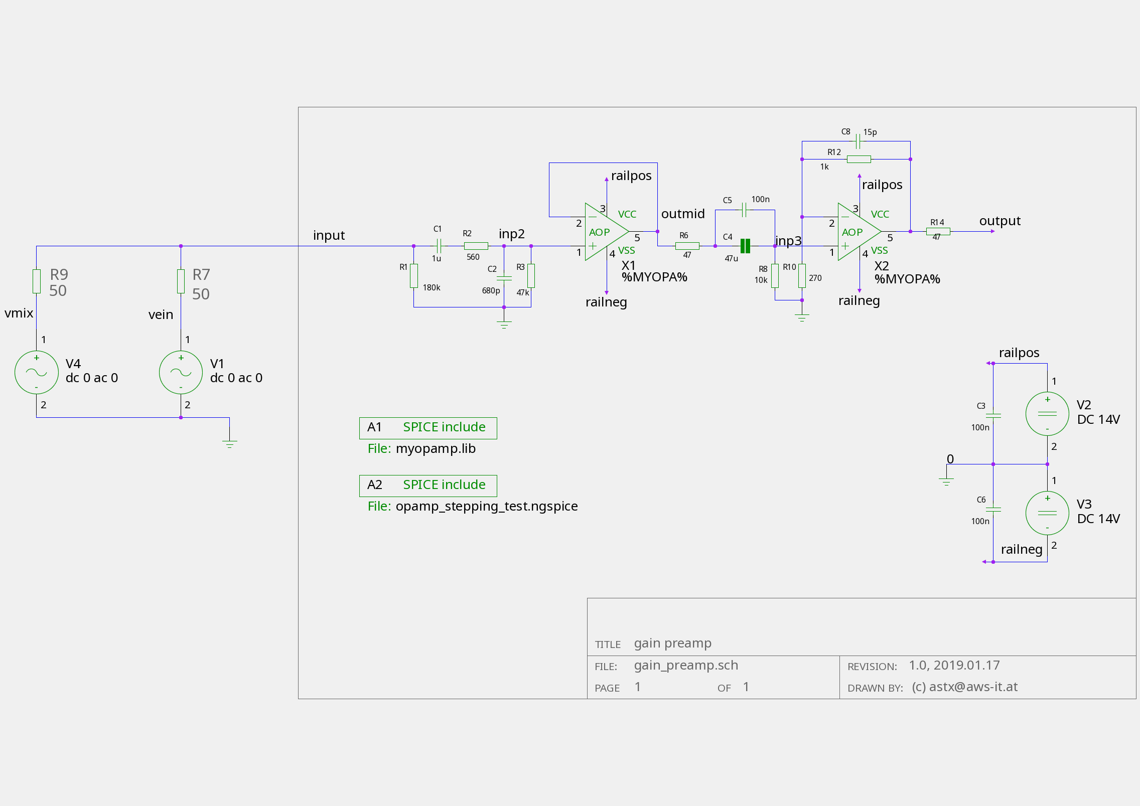

here are the reasults running ngspice using this netlist and "pz" afterwards ...
Schematic from above opamp circuit.
BR, Toni
Code:

Code:
ngspice 2517 -> pz input 0 output 0 vol pz
Reducing trtol to 1 for xspice 'A' devices
Doing analysis at TEMP = 27.000000 and TNOM = 27.000000
Warning: Pole-zero iteration limit reached; giving up after 292 trials
Warning: Pole-zero iteration limit reached; giving up after 256 trials
No. of Data Rows : 1
ngspice 2518 -> print all
@c.x1.c1[i] = 0.0000000e+00,0.0000000e+00
@r14[i] = 0.0000000e+00,0.0000000e+00
pole(1) = -6.448271e+07,0.0000000e+00
pole(2) = -5.909002e+07,0.0000000e+00
pole(3) = -6.664565e+05,0.0000000e+00
pole(4) = -4.246934e+04,0.0000000e+00
pole(5) = -4.576797e+00,0.0000000e+00
pole(6) = -9.078086e-02,0.0000000e+00
pole(7) = 4.1096170e+04,0.0000000e+00
pole(8) = 9.3701938e+08,0.0000000e+00
zero(1) = -3.112961e+08,0.0000000e+00
zero(2) = 0.0000000e+00,0.0000000e+00
zero(3) = 0.0000000e+00,0.0000000e+00
zero(4) = 4.4597922e+02,0.0000000e+00
zero(5) = 1.7216954e+03,0.0000000e+00
zero(6) = 2.2142360e+10,0.0000000e+00
zero(7) = 2.2371969e+10,0.0000000e+00

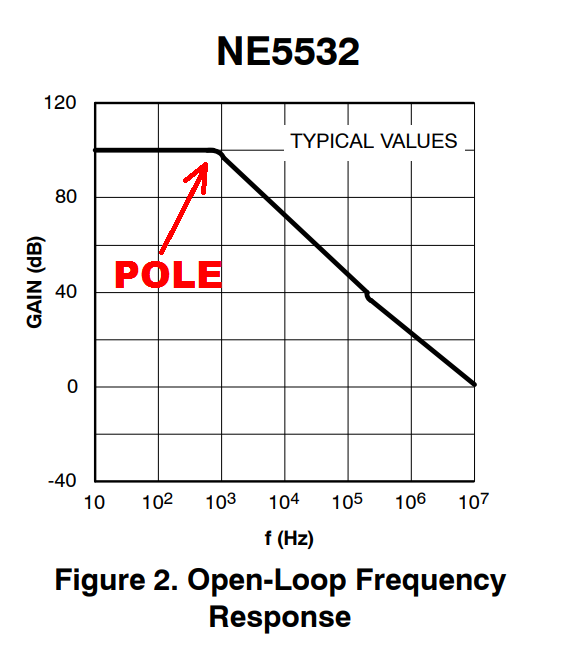

Attached is a figure from Fairchild / ON Semiconductor's datasheet for the NE5532. It shows a pole at about 0.9 kHz which is 5.6 kradians/sec.
The NGSPICE output seems not to include this pole. It does show pole #6 at 0.1 hertz (!!) which is, um, unexpected. Also unexpected are zeros 2 and 3 which are both at the origin, 0 hertz. Namely DC.
Good luck and best wishes to all ngspice users.

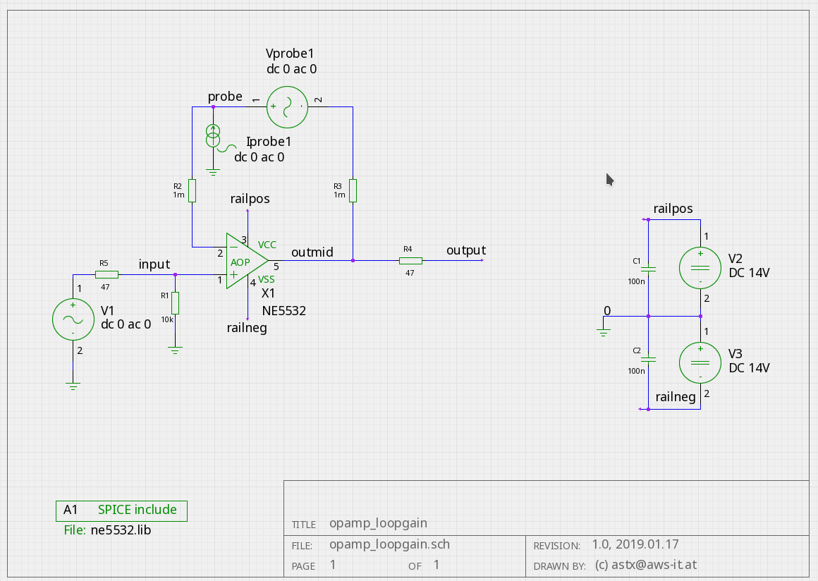

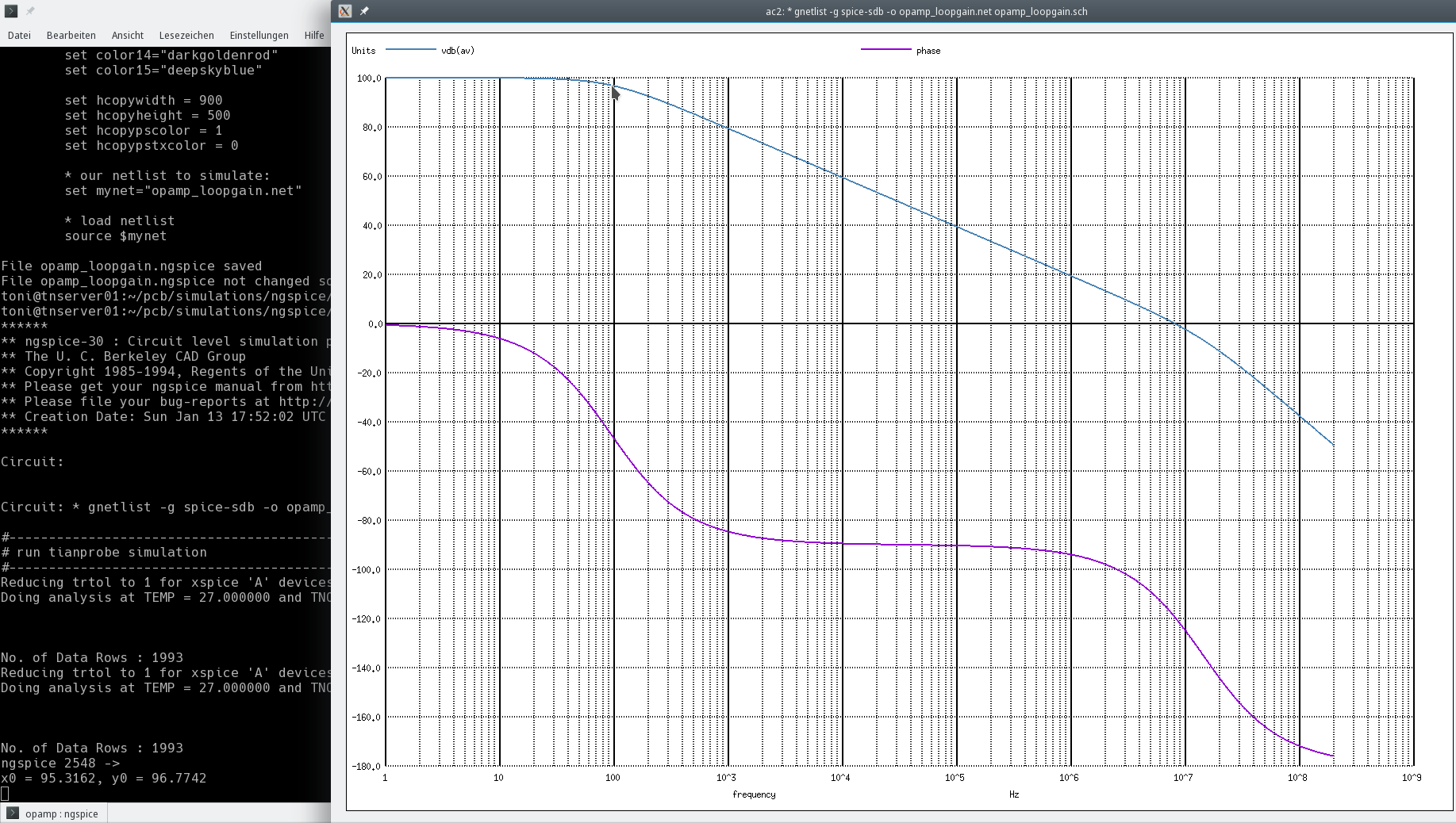

This is the ngspice calculated open loop gain using the tian method. And the "PZ" result data. Also nonsense?
BR, Toni
Thx goes to ngspice developers for implementing the patch into the current pre-master release to allow "linerarize" using a custom simulation time range!
It would be nice, if the other patch could be discussed too (avoid writing empty current vectors).
BR, Toni
