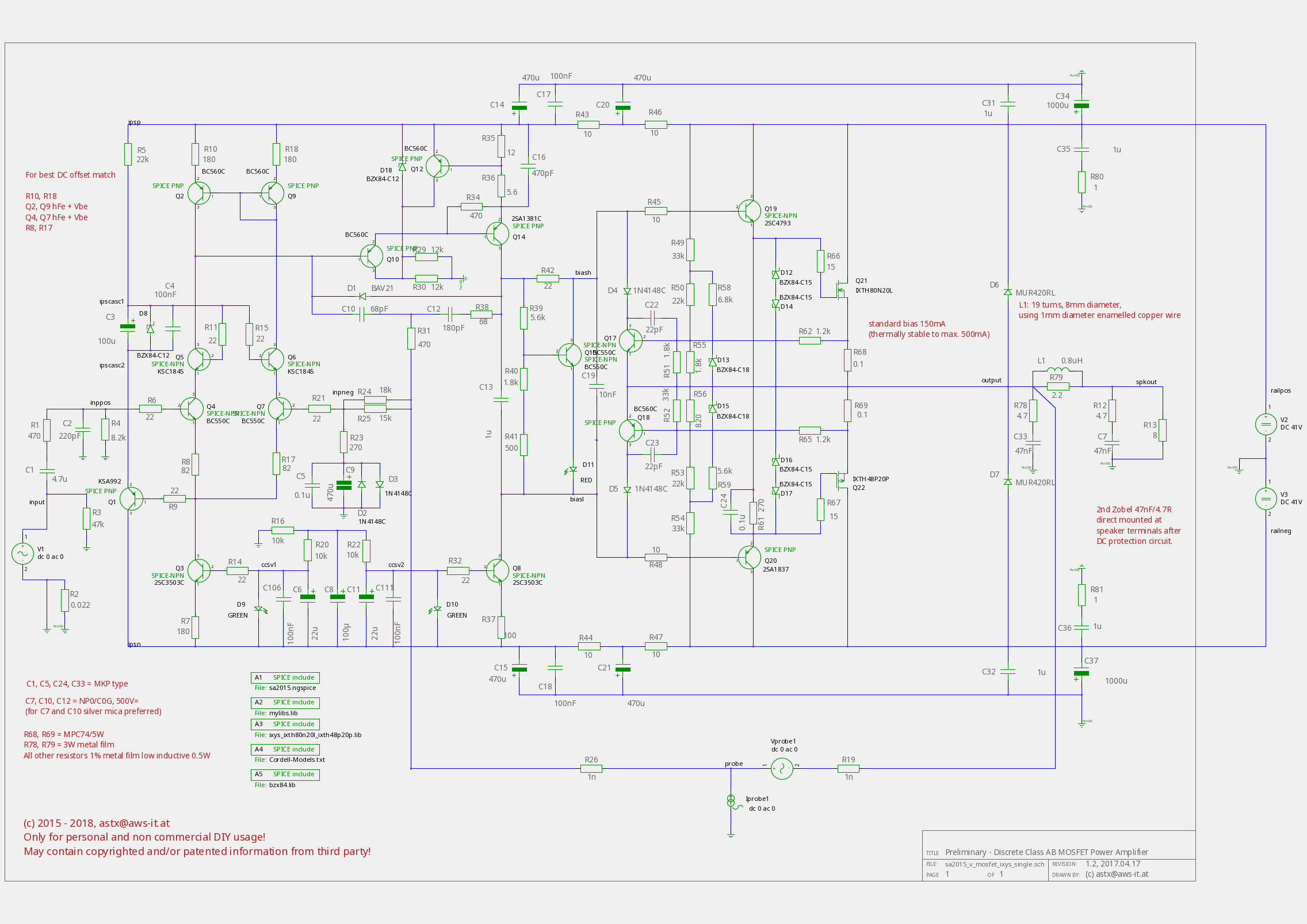

Attached a test result using ngspice 29plus from 23.12.2018.
Have tried to simulate my IXYS based amplifier where Dave Zan has designed the power mosfet models incl. ksubthres.
Was a bit work to replace the schematic components to spice compatible ones but the simulation runs. The scripting language let me do a DC, TRAN and AC (and hopefully later a loop gain checks using multiple tian probes) analysis in one automatic step including the plot output (the output can go directly to postscript too instead of screen).
Have fun, Toni

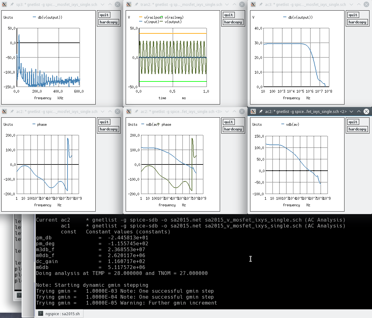

Of course will do, but need some hours for cleaning up.
BTW: Tianprobe works. ...
ngspice has only limited support using multiple processors in parallel, but you can fork many ngspice instances to work parallel on the same circuit. That automates and speeds up standard tasks for me I can never reach using the mouse and switching between TRAN, AC, DC or whatever. You are right in criticizing the available schematic editors but this is not the fault of ngspice.
Here the sample ngspice commands to automate the tianprobe task (reused parts from the above link in post #3)
Measurement results:
BR, Toni

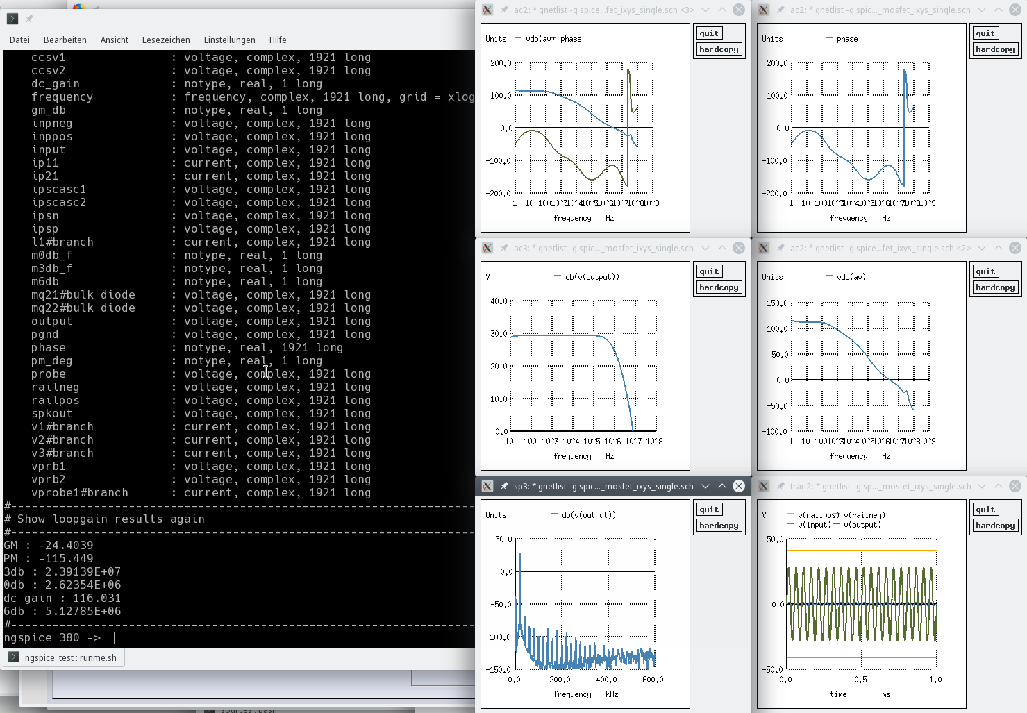

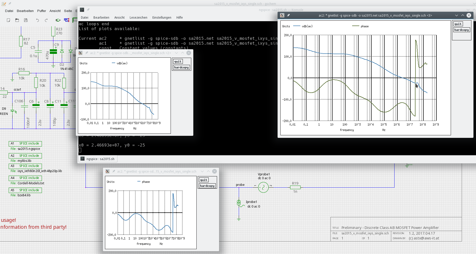

In only one run I can get those results:
Loop gain stability, output, fft of 20kHz full power, gain/frequency - see picture.
Note: a major difference is, that under LTSpice I have had always troubles with capacitor attached at input and nfb capacitor and needed to short circuit them. ngspice has no problem to find the operating point.
This is the command script:

ASTX LABS - SA2017 VMOS IXYS ngspice simulation test
... attached the combined test of a complete amplifier. Note: you need the developer version of ngspice 29plus (= upcoming v30 release).
See NEWS info in source code:
The "runme.sh" is reduced to sim the already generated netlist including all needed libs.
Only for educational usage because many included models are 3rd party (c).
Have fun, Toni

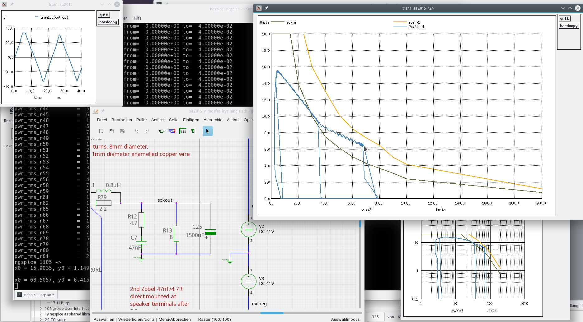

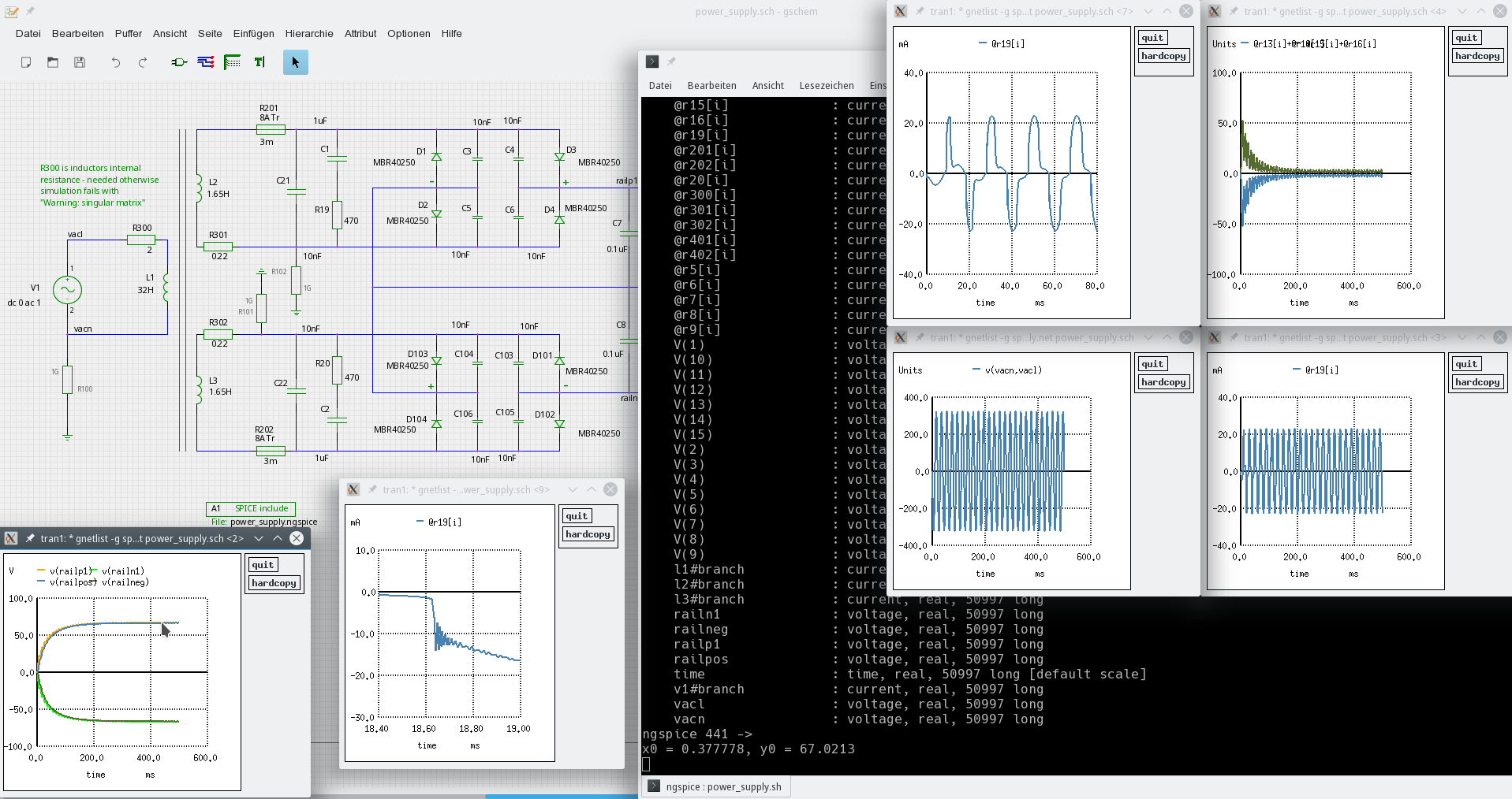

ASTX LABS - powersupply with transformer - ngspice simulation test
... my powersupply simulation works too...
here the ngspice script:
using right mouse button you can zoom into the graph. Shown is a ringing detail of R19.
The output values are the same as the LTSpice simulation!
Have fun, Toni
Have fun, Toni

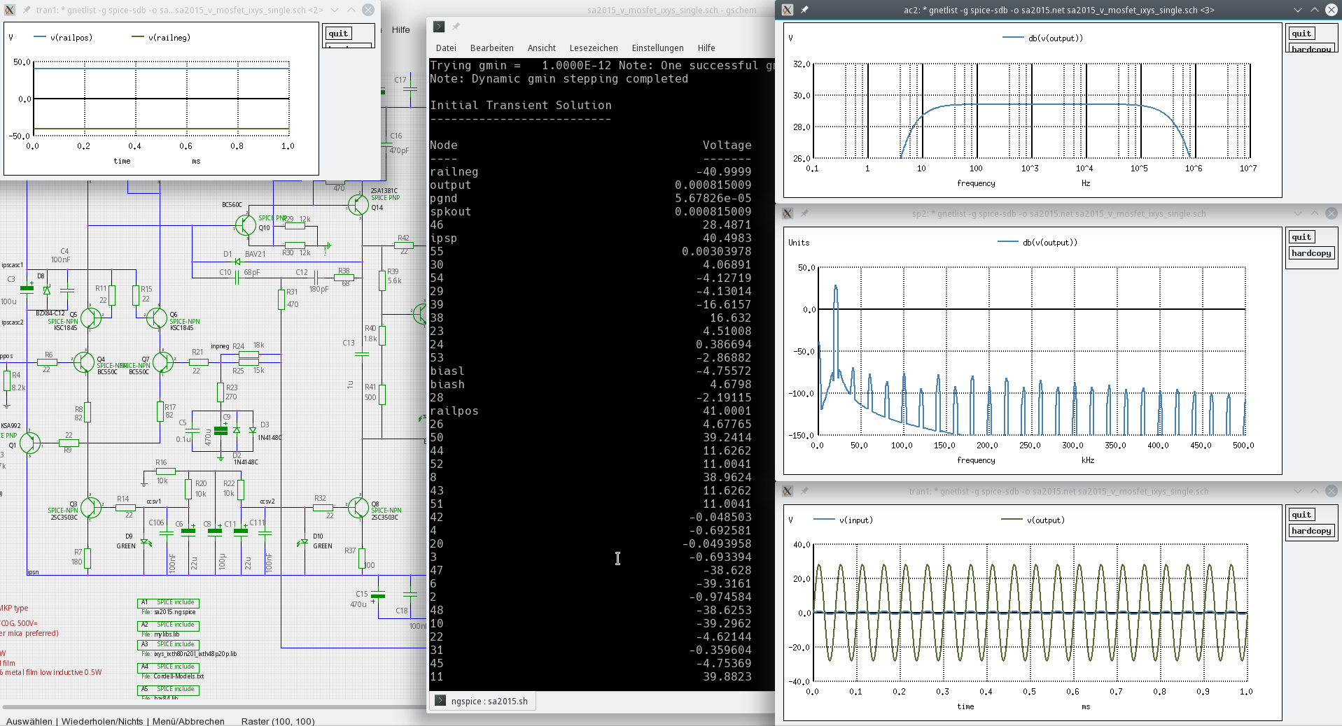

SA2015 IXYS model amp: fourier analysis
Protection and VAS Diode in situ.
... also nice to have ...
BTW: all simulation tests are very close to the LTSPice XVII version ...

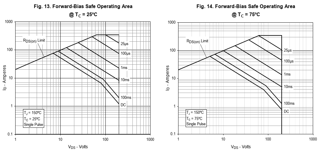

E.g.: Input signal 1V - output power on 8R ~ 81W
Calculate all power dissipation values for all devices - automatically!
ngspice OUTPUT:
I like it, I love it, a simple perl script generates me a huge "meas" script where I can calculate and plot all power dissipation values for a review - WOW.
Part of generated "meas" script
Attached the perl example which extracts all devices from netlist and generates a sorted meas script to be automatically included in the ngspice run...
BR, Toni

# Show vectors from ac2 run
# Show loopgain results again
GM : -19.2597
PM : -121.966
3db : 1.43818E+07
0db : 2.89793E+06
dc gain : 115.986
6db : 5.5177E+06
# Show distortion
Fourier analysis for output:
No. Harmonics: 10, THD: 0.00177092 %, Gridsize: 200, Interpolation Degree: 1
Code:
.control
let p_c1 = abs(v(1,input)*@c1[i])
meas tran pwr_rms_c1 RMS p_c1
let p_c2 = abs(v(inppos)*@c2[i])
meas tran pwr_rms_c2 RMS p_c2
let p_c3 = abs(v(ipscasc1,ipscasc2)*@c3[i])
meas tran pwr_rms_c3 RMS p_c3
let p_c4 = abs(v(ipscasc2,ipscasc1)*@c4[i])
meas tran pwr_rms_c4 RMS p_c4
.endc
BR, Toni

In about 2 second ngspice run with some lines of self programmed simple code I get the information I have had to click hundred times my mouse button...
I have fun, Toni 😎
ASTX LABS - SA2017 VMOS IXYS ngspice soa simulation test
A bit tricky to get extra lines on the plot. To print the SOA data lines of the output power MOSFET I have used "compose":
One can good see the over current protection in action.
Attached also an excerpt of the IXTH80N20L datasheet.
BR, Toni
Code:
* SOA data points of IXTH80N20L
* compose soa_a values 20 20 14 10 7.5 6.2 5.1 4.3 3.7 3.1 2.4 0.74 20 16 13 10.2 8.5 7.4 6.5 5 4.2 1.2
* compose soa_v values 1 14 20 30 40 50 60 70 80 90 100 200 24 30 40 50 60 70 80 90 100 200
compose soa_a2 values 20 16 13 10.2 8.5 7.4 6.5 5 4.2 1.2
compose soa_v2 values 24 30 40 50 60 70 80 90 100 200
* linear scale
plot @mq21[id] vs v_mq21 soa_a vs soa_v soa_a2 vs soa_v2 xlimit 1 200 ylimit 0.1 20
* log scale
plot @mq21[id] vs v_mq21 soa_a vs soa_v soa_a2 vs soa_v2 xlog ylog xlimit 1 200 ylimit 0.1 20
BR, Toni
