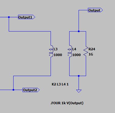

I solved it by adding an ideal transformer with the secondary ground referenced.

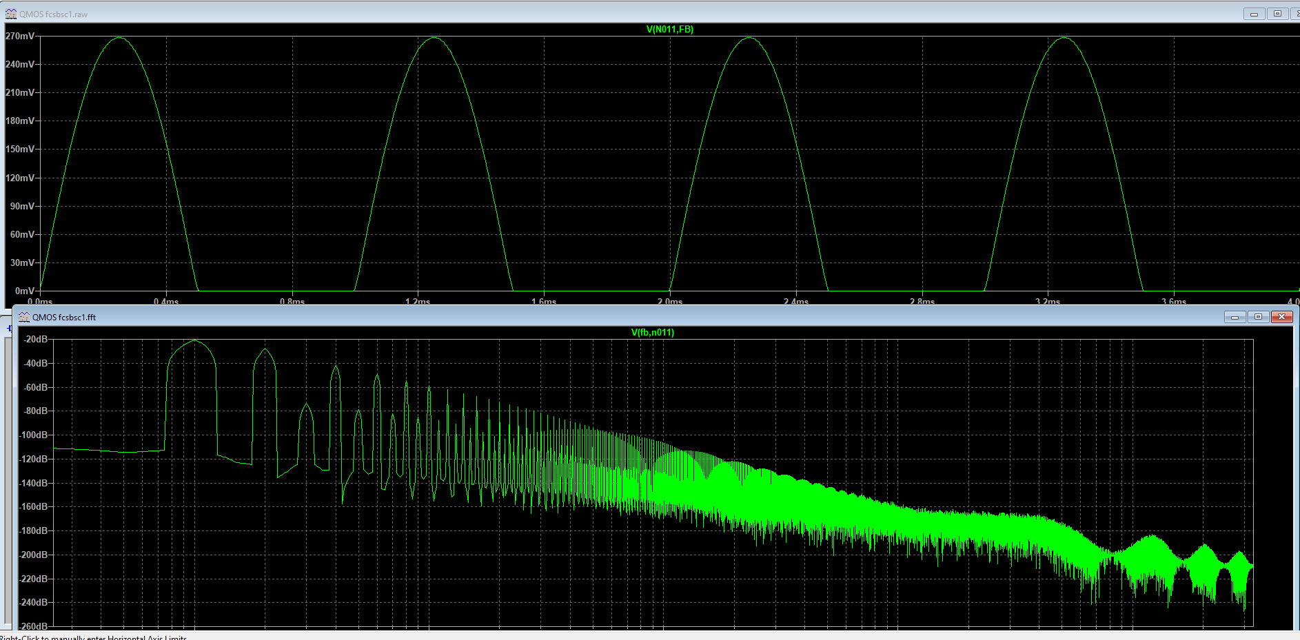

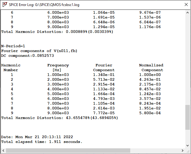

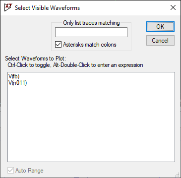

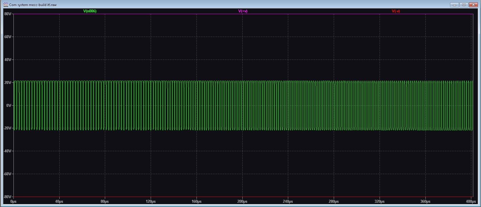

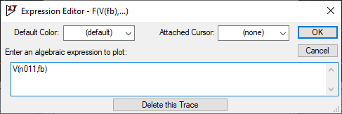

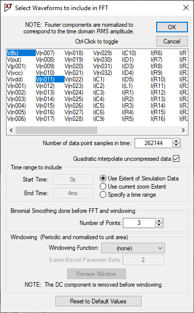

Sometimes it pays to be stubborn. Yes, you can FFT a difference:
1. to just do the error log, just direct ".four {f} V(a,b)"

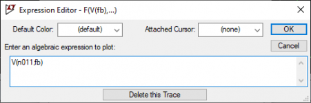

2.1 to plot a difference fft, start with view FFT in the trace dialog but select two nodes by control clicking the second node.
2.2 This brings up a dialog that allows you to select and edit the selected nodes, including an expression with Alt-double-click, which can be V(a)-V(b) or V(a,b)
2.3 click OK

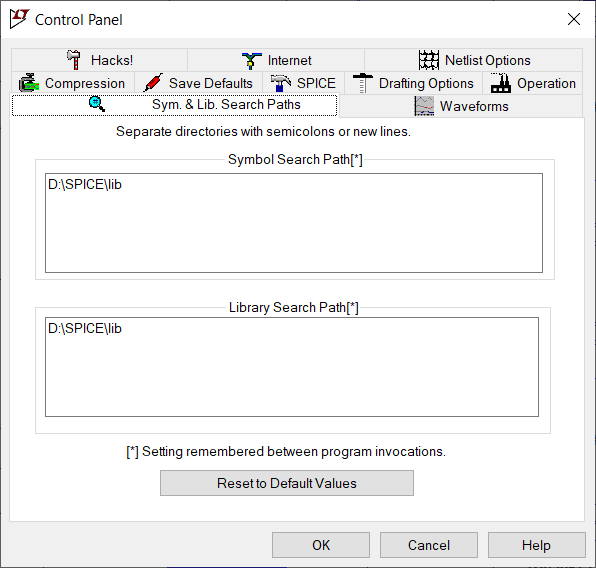

An advantage of 3rd party library files is that LTC will not mess with them during updates, and you can put it where there are no security problems. It may be useful to add a path in the control panel:
