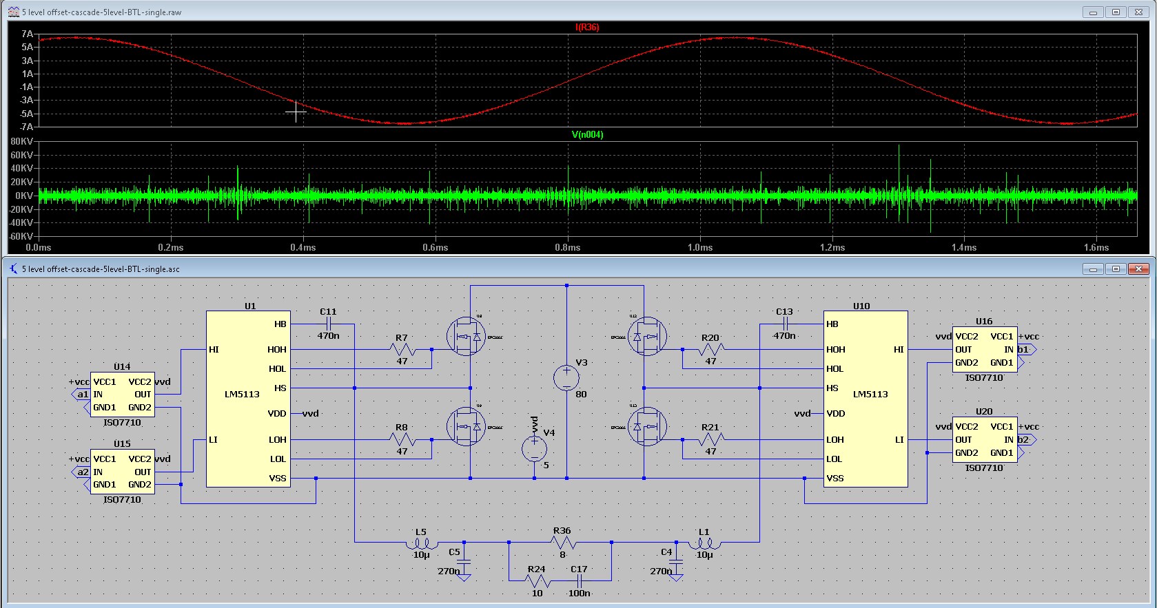

Hi All

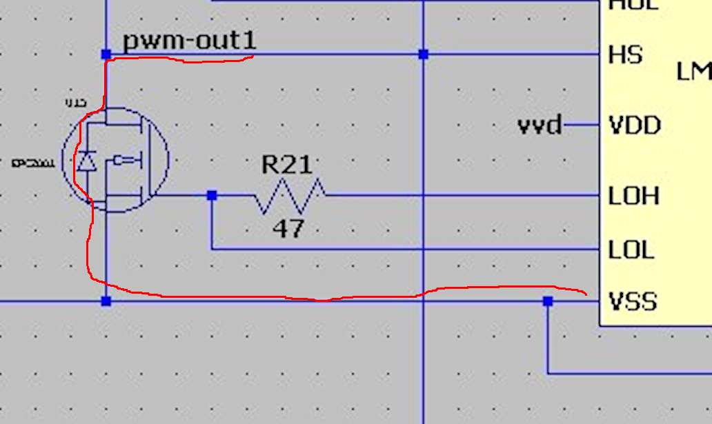

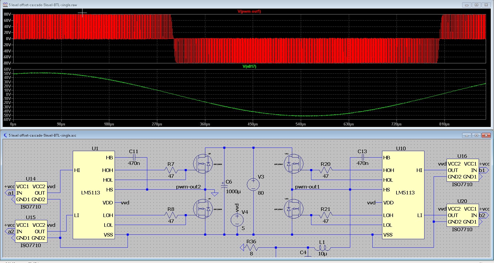

I have a strange outcome from a simulation, the output is just fine, Get a nice sinusoidal signal, but when probing before the low pass filters on output mosfets I get voltagespikes into the tens of kilovolts. I see no switching action, but it do because I have demodulated output and it is on 800 Khz.
It is a floating output did put some big resistors on it, that did not help.
regards

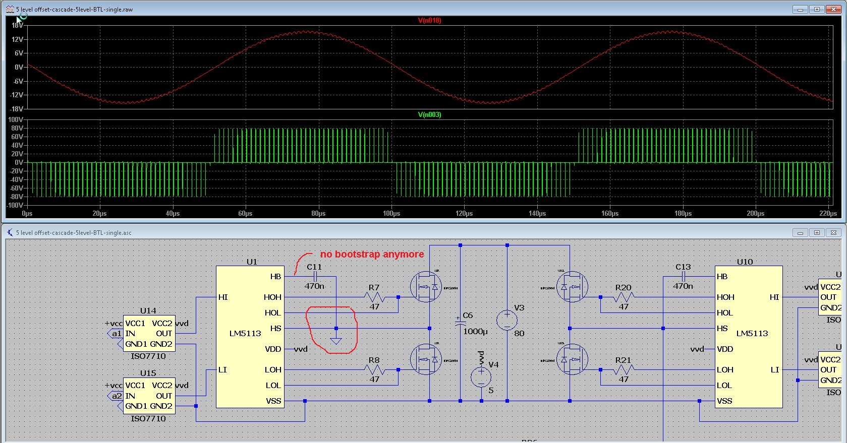

Yes you are right. 🙁
Here the new ones, I have included the same version but now with pwm-out2 grounded and also the speaker out.
However when pwm-out is grounded there is no signal for the bootstrap circuit, need active one.
Then it go well as you see, so floating errors?
regards

It's difficult to imagine how signal pwm-out1 can fall to 20 kilovolts below ground, when the drain-to-bulk "body diode" of the lower MOSFET is connected between pwm-out1 and 0V. We'd expect to see it fall no lower than -0.8 to -0.9 volts. Maybe you've got an unexpectedly high impedance ground network.

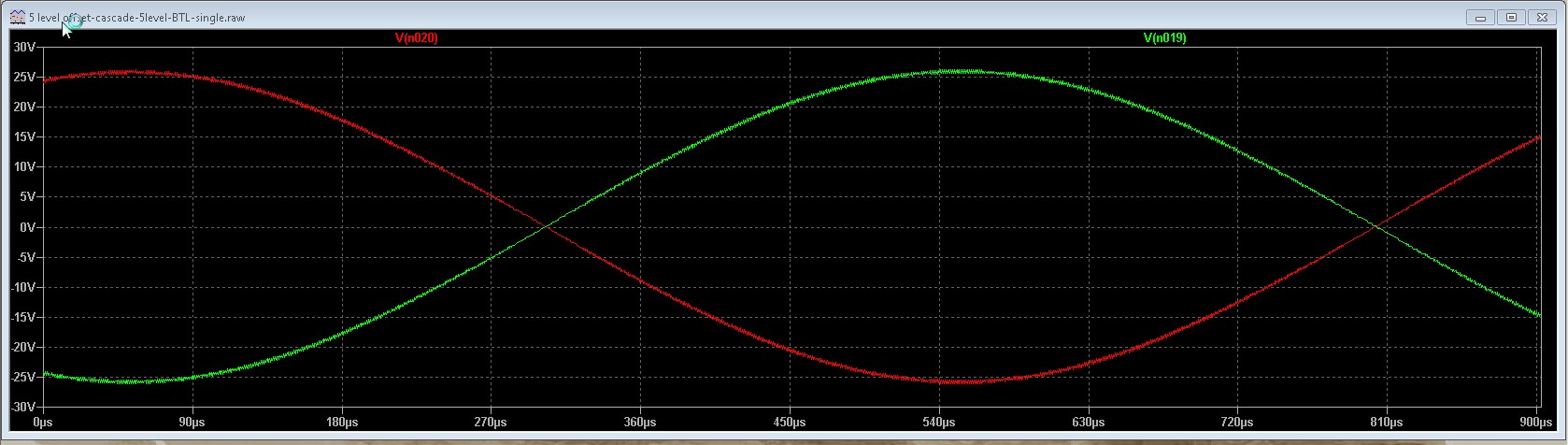

I have change the circuit like this, because it works then for single output and not btl by reference the sources of U8 and U9 to ground, but one things does not work, the bootstrap has that way no boost on one side, but ot does simulate right this way.
Setting the bootstrap to a other point with pwm the fase get corrupted and three level is lost.
The high voltages on the nodes are gone that way, but strange is that both does simulate with normal outputs a 1Khz and 180 out of fase in the btl failing version.
the shunt resistors did not work.
Can try in the old 32bit version of ltspice, just curiousity?.

Then connect the VSS to ground with a 1 - 2 pF capacitor and a leakage resistance of 1 GigaOhm (Rpar=1G in capacitor parameters). You will not deny that there is always a capacitance between VSS and GND. Both for optocouplers and for transformers. That would help. I even made an element - a floating ground on such a principle. Give it a try. That should help.

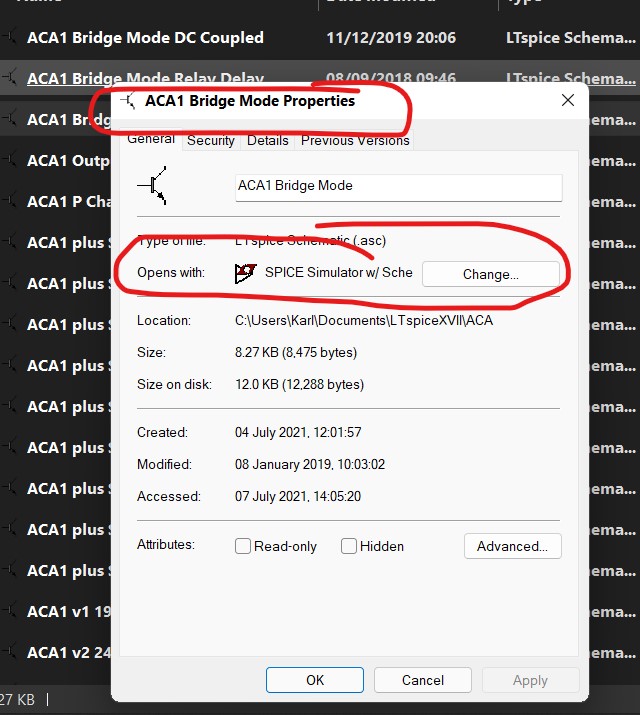

One thought (just thinking aloud) have you altered the default settings in Windows regarding file associations.
Right click a .asc file and check it is set to open with LT

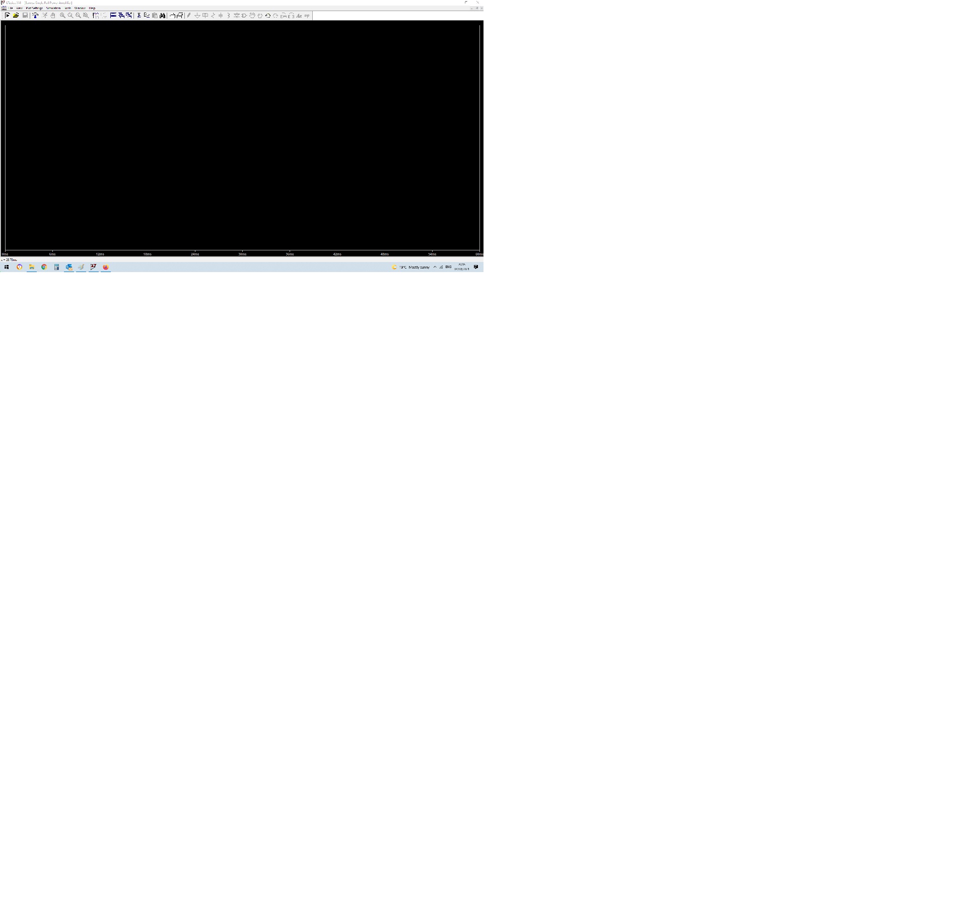

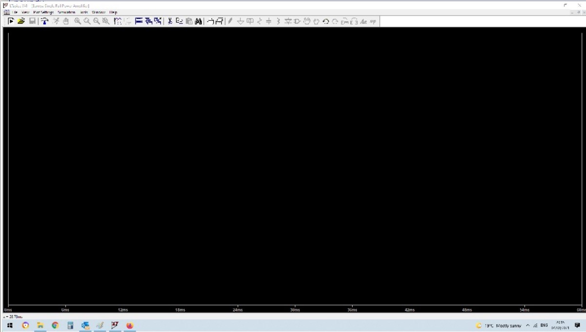

Hard to make that out but it looks like a graph or plot pane. Have you saved the .asc file together with plot settings? If so it might be auto running and waiting for you to make the next move 🙂
What happens if you just click the program executable shortcut? Don't click a .asc.
You should have that somewhere like the desktop or start menu.

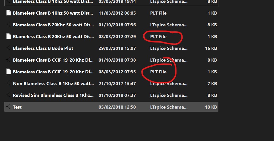

Here is the image blown up. I can see it is the Europa amp. Look where you have saved the files and see if you can see any .PLT files like these. PLT files will auto run the simulation.
I don't think there is anything wrong with the LT install from what I see.
