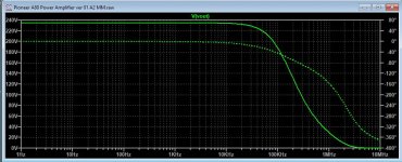

First my apologies if this has been handled in the previous messages of this thread - but I cannot find any information with internet search either.

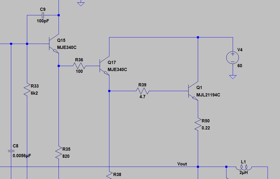

I stumbled across strange voltage values of the same signal when doing a simulation of Yamaha A-700 power stage (yes, with wrong component models but better these than nothing).
So I downloaded the zip file from
Installing and using LTspice IV (now including LTXVII). From beginner to advanced.
and tested it also on the Pioneer A80 model from there.

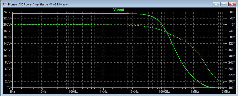

Same inconsistency appears - voltages in ac simulation are greatly different from voltages in tran simulation:
Am I doing something very wrong or thinking very wrong or using the software in a wrong manner here?

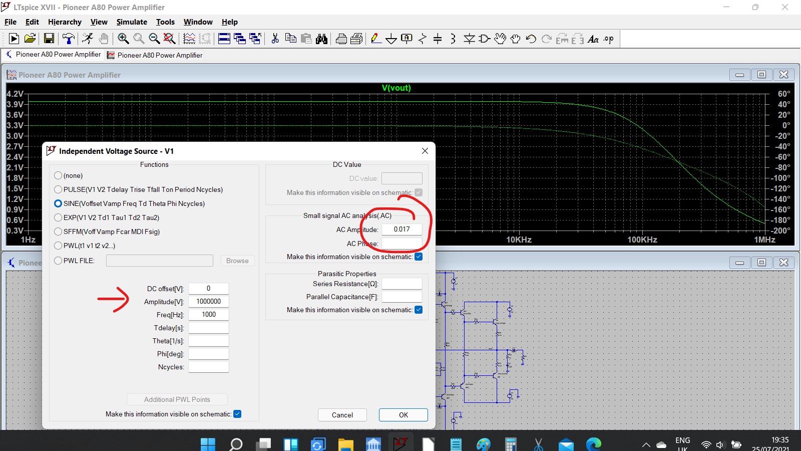

.ac doesn't look at the actual circuit level capabilities. It simulates with the devices linearized around the DC point, really a very small signal, and the .ac level specified in the command is only used to set the scales of the graph.
240V if you set the .ac at 1V only tells you that the gain is 240x, about 48dB. What is the gain of the amp?

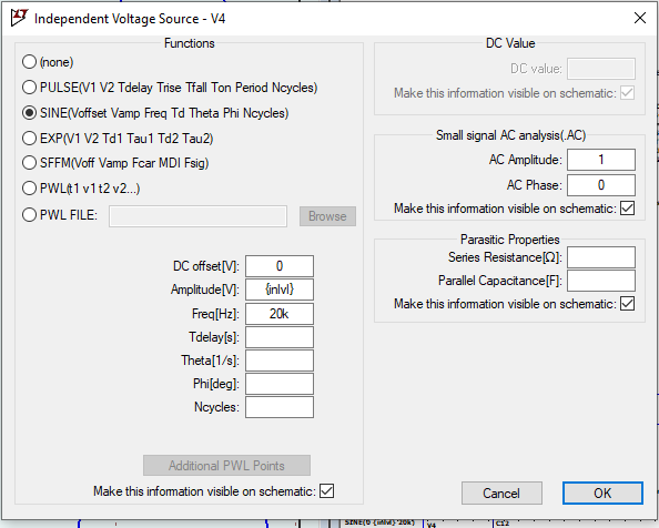

You set the test signal level for graphing in the top right corner see attachment.

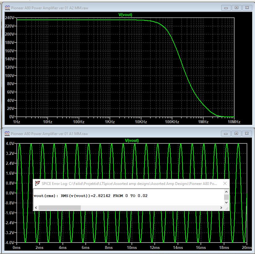

Ok, starts to make sense. So to have realistic values in amplifier ac analysis one should adjust the ac signal level so that the output voltage more or less matches the device actual (or designed) levels?
Regarding the gain of the amplifier - cannot tell, I just took the model from Mooly's package.
But technical specs are given for input sensitivity 150mV, power rails for output transistors seem to be around +/-60V.
Transient simulation shows that 150mV input corresponds to 35V output (P2P). Clipping (in the simulation) starts around 240mV input signal.
There is no 'right' or 'realistic' analysis level in .ac, it's a gain and phase versus frequency, you cannot draw any conclusions from it with regard to large-signal behavior.
You can set the level to 1kV, it won't change the graph one bit.
So 150mV for 35V output is a gain of 233, which very nicely matches the approximately 233V with 1V input in your graph ;-)

Yes, that is crucial. OTOH, you also need to be aware of the limitations. The important thing about a .ac run is that it is strictly small signal, each device linearized around the DC bias point, so it cannot be used to test for any nonlinearity or distortion.
For that you need a .tran which is a large signal simulation using the actual signal levels you specify and exercising all non-linearities of the devices, insofar as they are part of the models.
For instance, it is not uncommon for say an opamp model not to simulate the current drawn from the V+ and V- pins, or not to simulate temperature dependence of the input DC offset. Know your model!

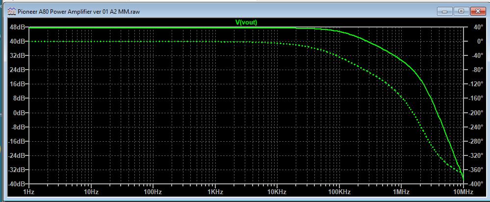

It's more common in an AC plot to set the Y-axis to display in decibels instead of volts. Right-click on the vertical axis and this will bring up a dialog box where you can set the Y-axis units. Choose "Decibel" instead of "Linear" or "Logarithmic." The value will still reflect the gain of the stage referenced to whatever AC signal level is applied to the input, but in decibels instead of volts.
Of course, there is no right or wrong way to display the results. LTspice gives you the choice.

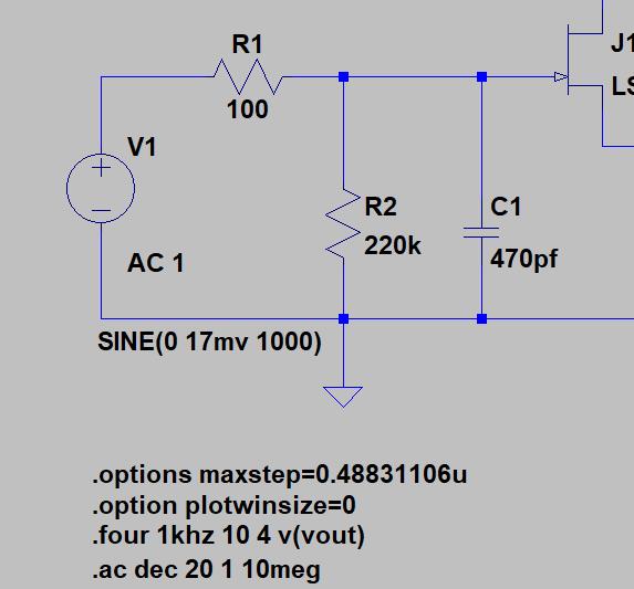

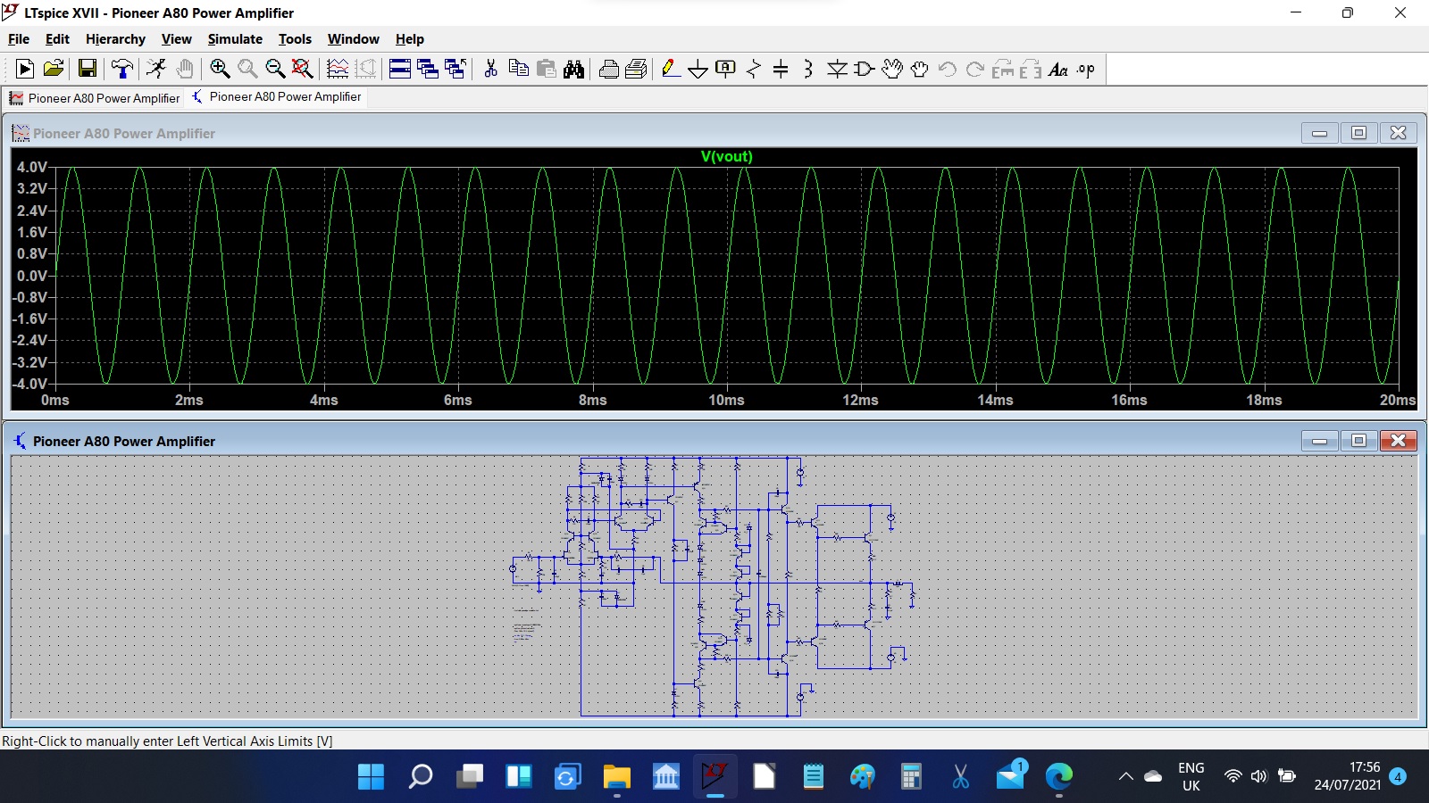

If you set the Analysis sim to show voltage and set the 'Small Signal AC Analysis' amplitude input to 0.017v then you should see 4v just as on the Transient run of the sim. The other setting of 17mv doesn't now apply for the AC analysis run. You can set the input to a million volts and it will still give the correct figure of 4 volts output as it uses the other entry for this function.
