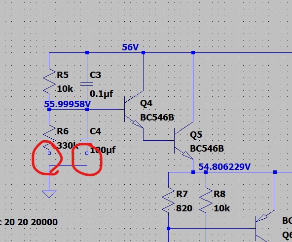

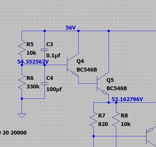

And calculating the old fashioned way...
R total equals 10k + 330k which is 340k.
I =V/R which is 56/340,000 giving 0.165 milliamps flowing in the series chain of the two resistors.
Voltage across the 10k is 0.165E-3 * 10,000 giving 1.65 volts.
Voltage across the 330k is 0.165E-3 * 330,000 giving 54.45 volts.
Total of the two equals 56 volts.
NOTE... the actual circuit also has Q4 drawing a tiny base current from the 10k resistor but in this case the value is microscopic and so can be ignored for a manual calculation. It doesn't really alter the practical result.
yes i get it, classic,i used '164' in my calculation but not in microamps
so where the resistor goes to ground is there a reason why there is no voltage the other side of it?
i did a simulation without it in place(i saved a different copy) and the current is alot higher so i guess its there to dissipate some of that current away from the base??
Do you mean R6?
It has 54.3 on one end and nothing on the other because that is ground. Maybe I'm not following you on that
What current is a lot higher? The current in R5 should fall to almost nothing (42 nano amps) because that is the tiny base current of Q4.
yes so that answers my question.is that the effect everytime you put one to ground?

So another puzzle though, the voltage on Q5 emitter should not change much if you remove R6 and C4.
How are you removing them or isolating them. Use the 'scissors' on the top line. Compare the three attached images. You can use 'Edit' and 'Undo' and 'Redo' to put them back.,

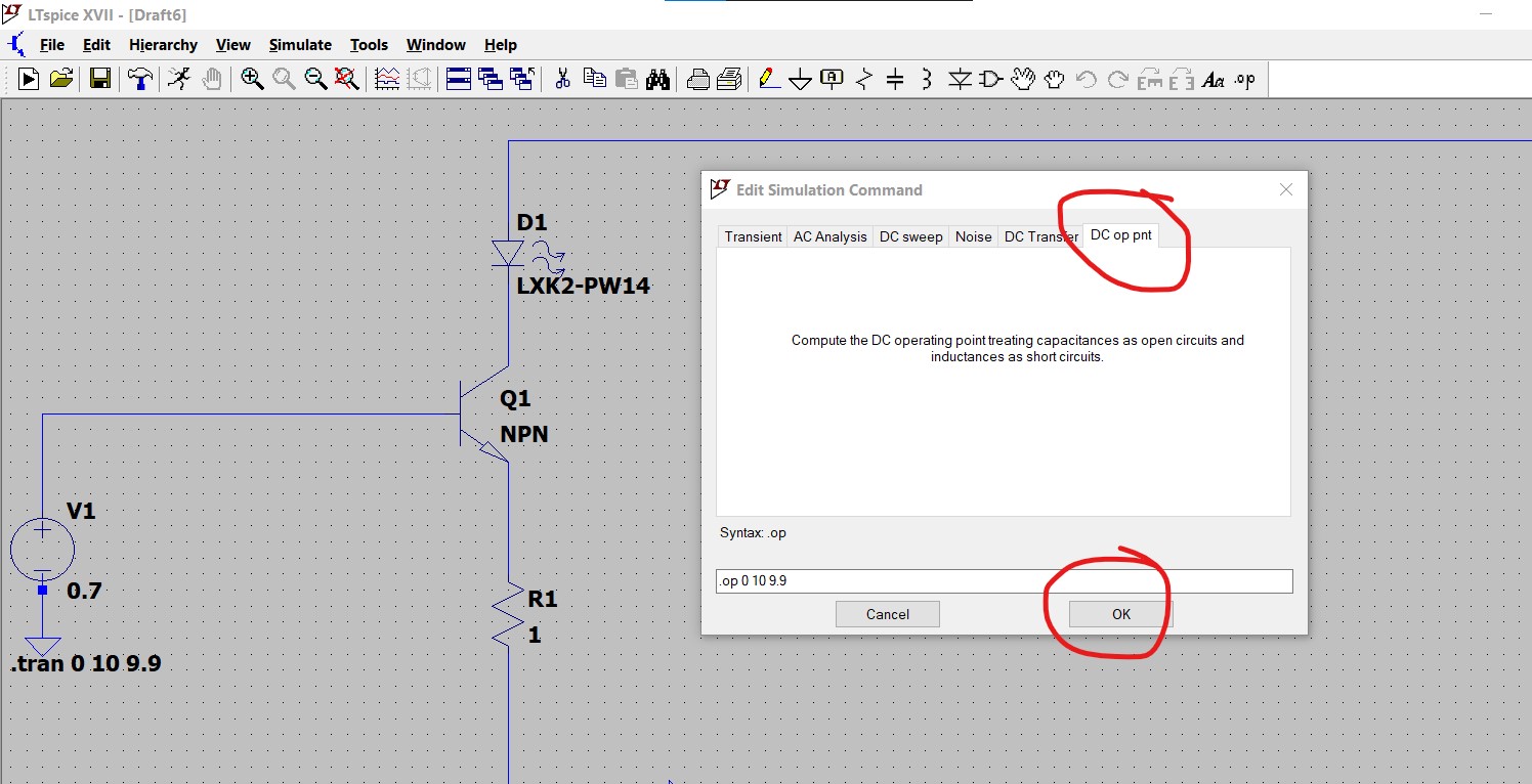

Well it is a valid circuit up to a point. When you set any sim up using the 'Transient' tab you are running what you would see with an oscilloscope, in other words voltage over time.
For a DC analysis we don't need to do that. Try altering your sim by selecting DC opt point as shown here. When you click OK you must then place the new command on the worksheet. So click OK once and then you will find the command attached to the cursor for you to drop anywhere on the page.
Now run the sim and you get a window showing voltages and currents at all nodes. Close that little window and just move the cursor onto any part of the sim to read the voltage etc.
Your circuit as it stands is applying 700mv to the base of an NPN transistor. That is not quite enough to turn the default NPN model on. So you have no current flowing anywhere.
If you make the input 0.8 volts you will get a little LED current flowing.
Make it 1 volt and see what happens.

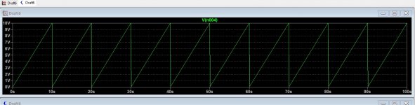

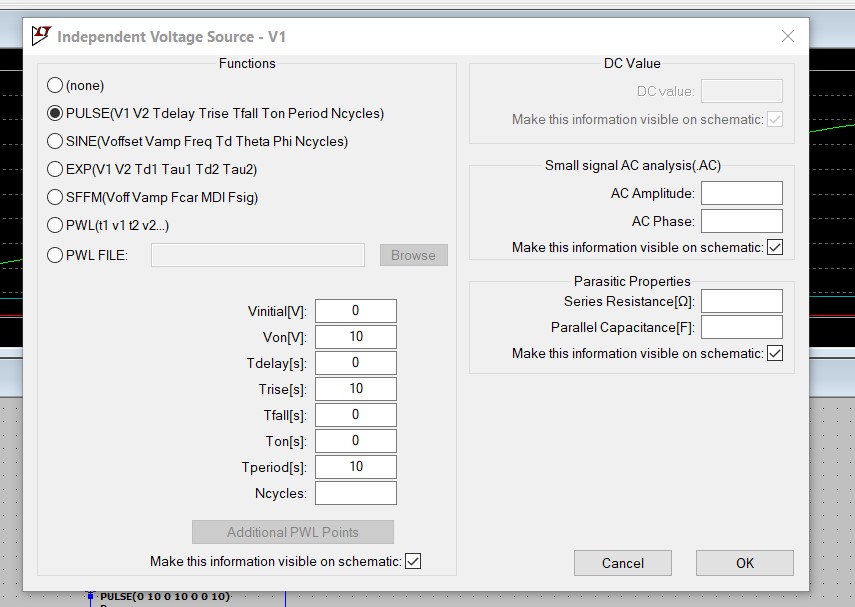

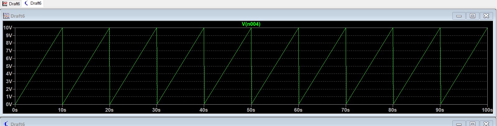

Let us now make the voltage source V1 a slowly rising voltage. Right click the V1 and select 'Advanced' and then select 'Pulse'.
Set it as shown.
The initial voltage is zero. This is the voltage it starts from.
The 'on' voltage is 10. This is the voltage it finishes at.
We have 0 for a time delay. This means it starts instantly.
Trise we set to 10. This is 10 seconds to go from 0 to 10 volts.
Tfall we set to 0. The voltage falls back to zero instantly after 10 seconds.
Ton we set to 0. This is 'on' time. How would be how long it stays at 10 volts.
Tperiod we set to 10. This is the time for 1 cycle.
Ncycles we leave blank. It runs for ever.
All of that has created a sawtooth voltage as shown.

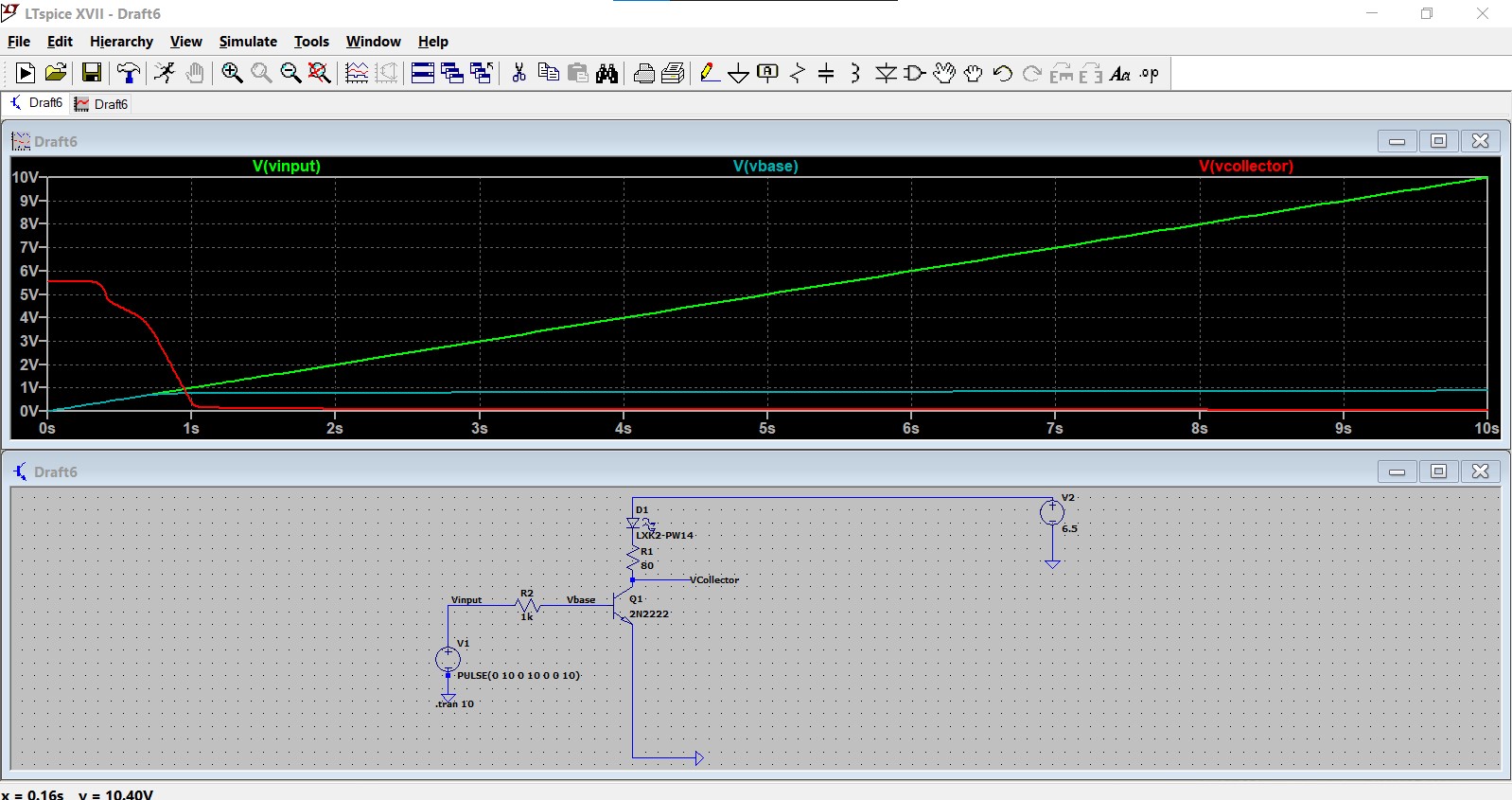

We need an additional resistor to limit base current, otherwise the transistor would be destroyed (real ones, not simulated ones ) We will pick 1k.
Set the sim to run for 10 seconds to cover the time of one cycle and lets see what happens.
Plotting the three voltages shows the input voltage rising. The base voltage limits at about 800 millivolts. This is the Vbe of the transistor (the B-E junction behaves like a diode remember).
The collector volts fall to almost zero as the transistor turns fully on.

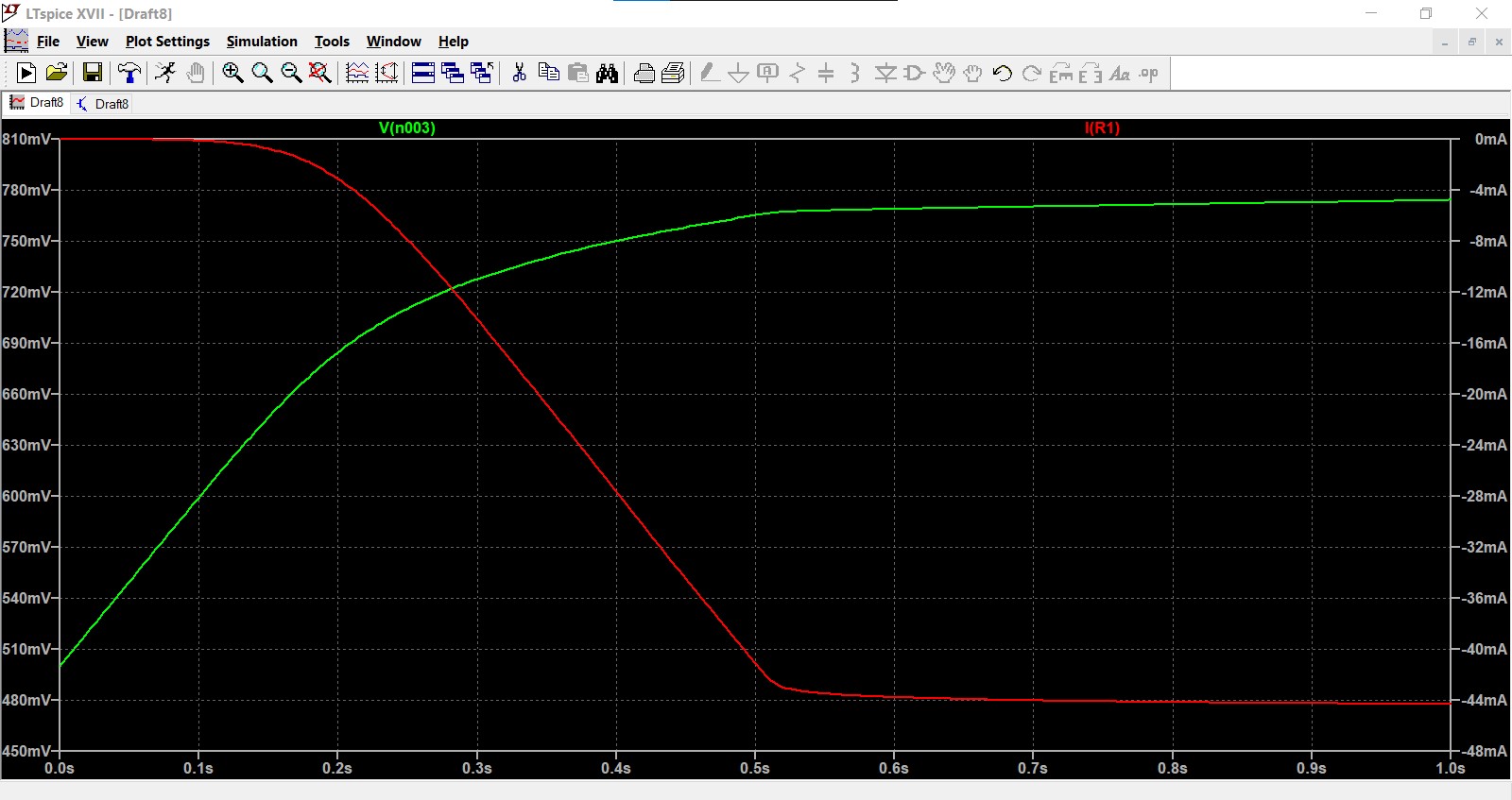

It is not wrong, but it doesn't quite do what we want.
Run the sim and look at the time scale on the bottom of the graph. It runs from 0 to 100 milliseconds. It is doing exactly what you have told it to do. We really want to see the full 10 seconds of the complete input cycle.
Can you see why? Open the 'Edit Simulation Cmd' Window. You need to alter one thing.
Also try this when you have it figured out Set the simulation to run over the critical turn on point of the transistor. This is where the rising base voltage begins to turn the transistor on.
Look at the base voltage and the LED current. It should look like this. The current goes from zero to a maximum over a very small change in applied base voltage. Current scale on the right of the graph.

ill try this out tomorrow now im back from my holsIt is not wrong, but it doesn't quite do what we want.
like this?It is not wrong, but it doesn't quite do what we want.
Yes but run the sim from 0 seconds and not 1 seconds. The transistor B-E voltage clamps at around 800 millivolts.
In fact look at the first 2 seconds only. Set the sim to run from 0 to 2 seconds and look at the voltage source and the base volts.
