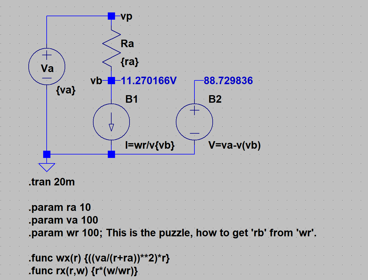

And yes jou found the problem, the value of R2 or the current in R2 or the voltage across R2 needs to be calculated. It is a simple iteration, and it is easy to do in excel or comparable, even spice can doe it, but I do not know how to do it.
This all should be calculatable from the fact the R2 needs to dissipate 100 Watt's.

Interesting question. I probably do a guestimate and then a bunch of .step commends around that value and .meas the power to find the 100W point. But you probably want something smarter ;-)
Jan

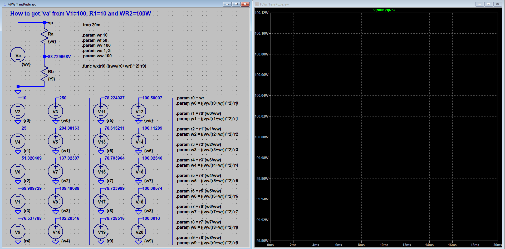

Ohhh Jan you are so right, I did do that 'manually' for the post and that works, I am working on a sample like that, I will post later today, and yes smarter will be better 🙂
Actually, the iteration method works, but for me it looks... ugly? I think there must be something smart.

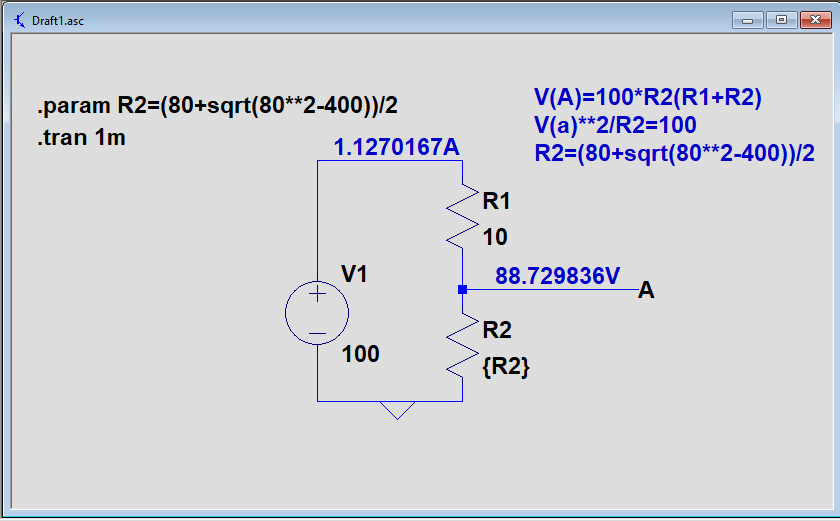

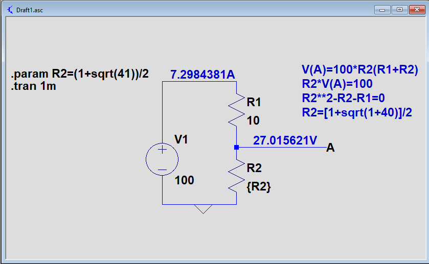

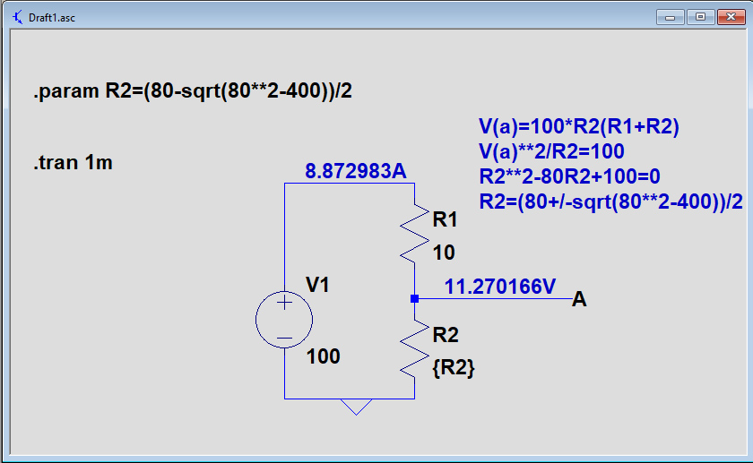

There are 2 solutions, I gave you the answers to both.
The comment on the right in Blue was just to confirm your premises, resp 100V, 10R and 100Watt for R2.
Solving these equations gives R2^2-80R2+100=0
Look here how to solve a quadratic equation:
Quadratic Equation Solver
Using this gives
.param R2=(80+sqrt(80^2-400))/2 and
.param R2=(80-sqrt(80^2-400))/2
This the non iterating way of solving your problem.
Hans
