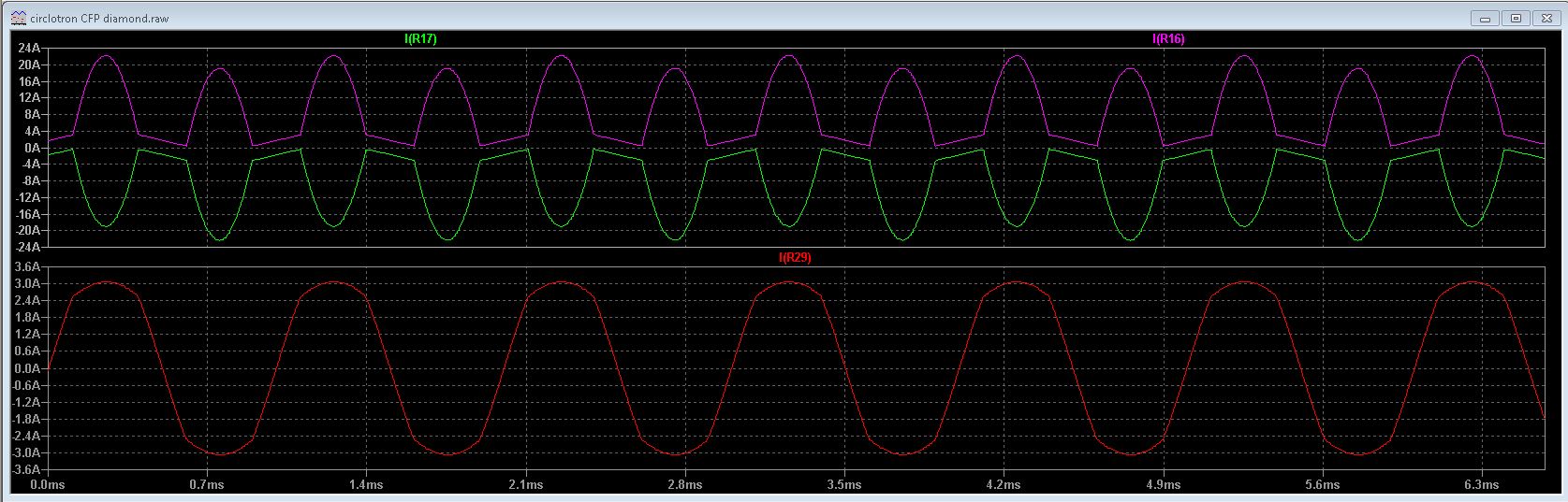

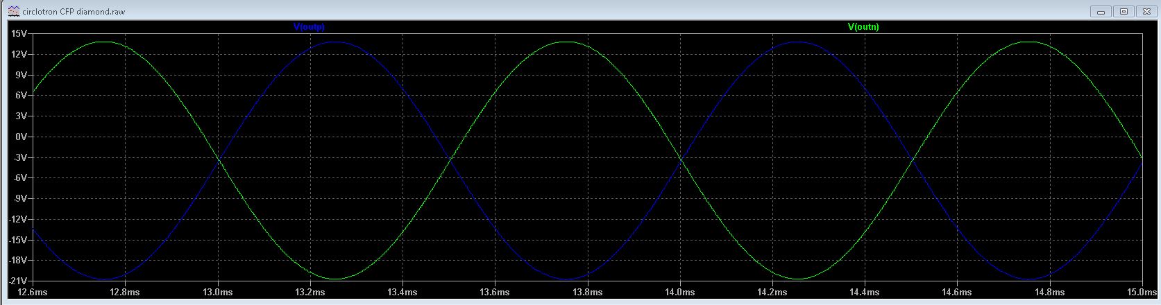

But nu ik je toch heb, I was busy with the circlotron sims, and did discover that extra high output drive did not well, the signal get,s clipped. I did search and searchm what is wrong.
It is the irf mosfet model library I have, the mosfet model was the cause of that and I do not now why, but it did clip, I have now choose a other mosfet from a other model and this one is oke.
see the pics, the one with the nice sinusoidal is the diamond driver, a nice 180 degree signals, 32 volts. the clipped one the output, supply is way higher so is not the cause, it just clip because of the model.
You see there are also a lot bad models.

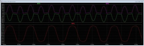

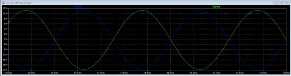

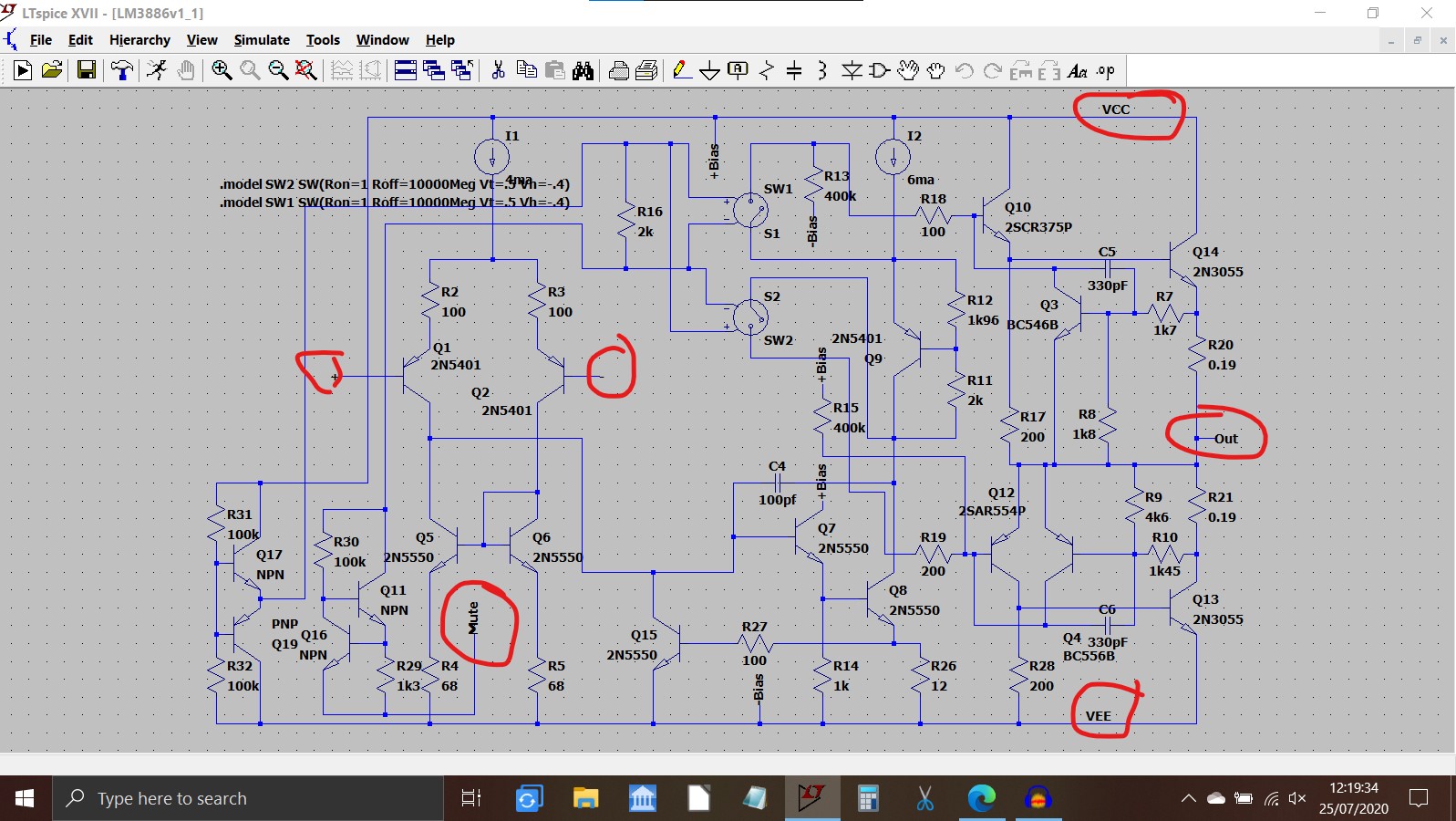

I made some notes when figuring this out and which I haven't used since (lol) but they might help. This relates to a model I created for the LM3886 which I will attach in case you want a go at creating a symbol for it. It uses all default models.
1/ Create .asc file of subcircuit. Label all nodes and ensure no individual ground connections remain within the .asc
2/ Create and name a unique folder for the subcircuit and save it in the user LTspice files within the 'lib' folder.
3/ Place the .asc within this newly created folder.
4/ Open the .asc and select 'view' and then 'Spice Netlist'. Note the name of the subcircuit netlist, for example xyz.net where xyz is the name of the subciruit.
5/ Copy the netlist contents and paste into notepad.
6/ Add the name of the subcircuit directly under the first line of the file, for example on the line below * C:\Users\Karl\Documents\LTspiceXVII\lib\LM3886v1_1\LM3886v1_1.asc.
The added line should read .Subckt xyz foloowed by the nodes of the subcircuit.
For example .Subckt LM3886v1_1 + - Mute Out Vcc+ Vcc-
7/ Replace the last two lines of the netlist with .ends xyz
8/ Highlight the top line of (for example) .Subckt LM3886v1_1 + - Mute Out Vcc+ Vcc- and right click and select 'Create Symbol'.
9/ Save the symbol which should now appear in the 'Auto Generated' folder.
10/ Save the complete file as xyz.net (select all file types in notepad).
11/ Change the saved files attributes to read only. This is because LTspice seems to auto delete these once LT has been open, run and closed.
