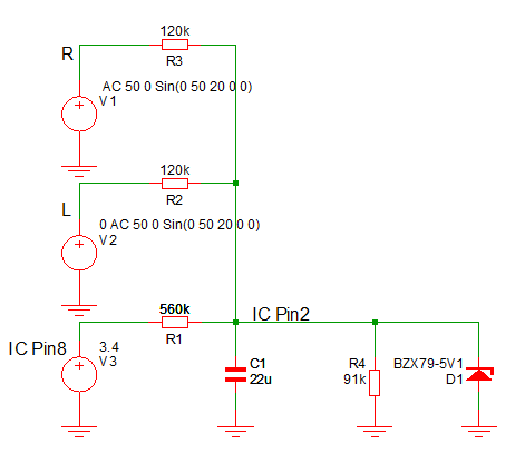

You got it wrong, the effective R is 120k paralleled with 120k and 91k =36k

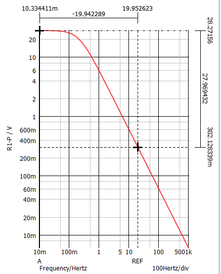

-3dB at 0.2Hz. when playing a 20Hz tone at 60V the level is 40dB down at 0.6V, this is well below you 2V trigger.
But when you have 2Hz, 6V will trigger your DC protection.
Still trying to understand this...
So, with 2 x 120k and 91 k resistors, I believe the thresholds are set at about 2Volts as per the datasheet calculations.
For this to work, it should resemble a highly exaggerated low pass filter, which basically raises pin 2 when dc or a very low frequency is detected (high frequencies should not trigger and hence need to be attenuated, which makes it a low pass filter).
The series resistors are 120k in parallel giving 60k. I do not understand the purpose of the 91k parallel to the capacitor from a filtering point of view. So to me, it looks like 60k in series with a capacitor. Therefore f = 1/(2.pi.R.C). So picking f as close to 0 (dc) say 2 Hz, should yield, C = 1(2. pi. 60000. 2), which is 1.32 uFarads.
Is that not the case ?
Try to simulate it, not the IC, but just the cap and resistors.
Then I looked at the data sheet and saw that the positive and negative threshold are quite different, +620mV and -170mV, so with the 91k attenuator it would be +2V and -0.55V treshold.
Now a single resistor of 560k to the 3.4V ref voltage pin8 will center to +/- 1.47V.
The 22u is a good value.
I added the Zener so when there is some cathastrophic failure and the output voltage hangs on a rail the IC and cap don't get fried.
Also with the Zener you do not need a bipolar cap, a normal 10V Tantal 22u is perfect.
