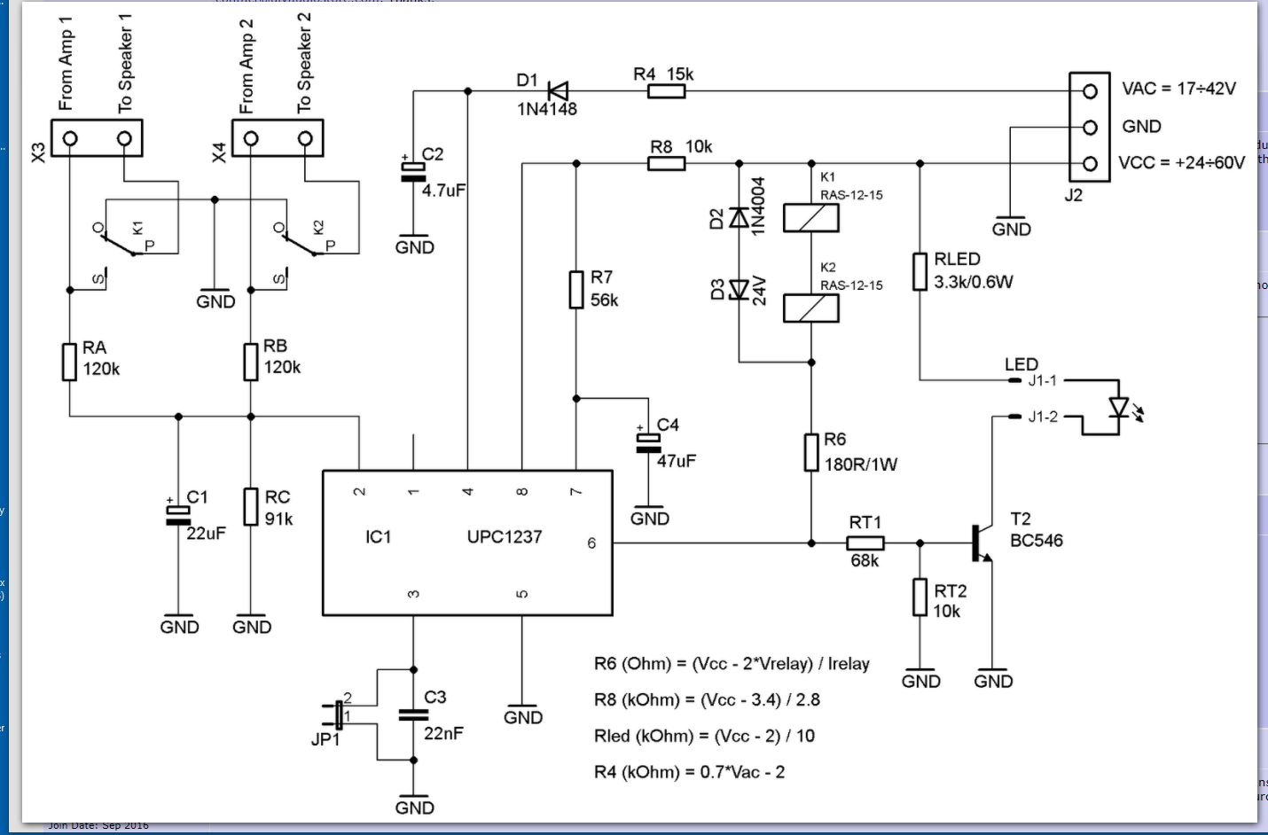

I also have another question on 1237 based protectors.
Pin 2, which detects the DC offset, have wildly varying capacitor values based on different designs, altho most of the other components are pretty similar.
What should that value ideally be ?
In my estimate, if it is too large, it seems like it will trigger prematurely at lower frequencies. So, to allow a 10 Hz signal to go thru without firing, what should the approximate value be ?
I have seen values ranging from 22uF all the way to 68uF.
Has anyone actually experimented with it ?

Cakyol, the value of that cap will be chosen by the RC time constant, where f = 1/(2piRC)

do not look at the cap values alone but the resistor associated with it and the time constants it makes..
I mentioned this in post #135, but it might have been buried. The RC time constant is what counts. The cutoff frequency is given by f_c = 1/(2piRC). Knowing this you can size the values of R and C such that it will only trigger the protection circuit at frequencies below 10 Hz or whatever you choose. Do keep in mind, however, that while you could configure it to pass a 1 Hz sine wave without triggering the protect circuit, there is Zero reason for it to pass anything below 20 Hz, and the protection circuit needs to be fast enough to avoid damaging the woofers of whatever speaker is connected when the amp fails. Speakers really don't like DC, so a fast protection circuit is a good thing.
Also, the cap needs to be a bipolar electrolytic. This is very important, since an amp can go DC to either rail.
So, in the schematic below, Ra, Rb & Rc are calculated so that the DC voltage threshold is about +/- 2 volts. So, is the frequency of trigger given by:
1/ (2 x pi x 120,000 x (C1) 22u), which translates to 0.06 hertz ?
Unless I made the calculations wrong, this is too close to danger. I would rather have it 4 or 5 hertz.
So for 5 Hz, the cap value C1 should be 0.265 uF. Does that sound right ?
