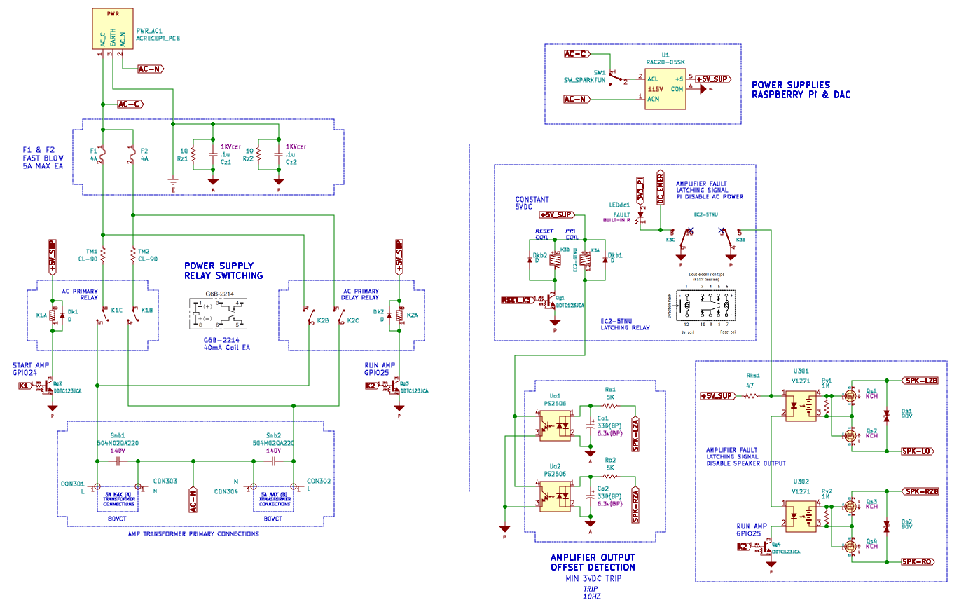

This is one feature that I was able to include into my recent design
Splitting the power at entry, fusing each trafo independently, soft starting both trafos simultaneously with CL-90's. I even have the process reversed for poweroff for in the event of a short or other fault so that the shorting relay can release in the event of an overload. Then the relay with the CL-90 can release, being current limited.
Included in the image is the protection circuit that I use. Simple and effective. Uses a latching relay and on it's own, does not need anything other than 5vdc in my case. Other changes could possibly make it work for another voltage. Standalone, when tripped, the relay will short out the enable SSR for the speakers, effectively disabling it and the speakers.
My system uses a Raspberry Pi for controlling the power cycling and additionally will kill the AC to the amps in the event of a DC fault. I had to design my own DAC (not shown) to fit my requirements in the same project. When I get the final finished, I will post photos and info. An engineer over at the RPi foundation has developed a custom device tree overlay specifically for my project and apparently has also created a new functionality for the Pi device at the same time in the process. If successful, I also intend to alter some of the functionality of my own personal design into something for the community that will perform all of the same functions - minus the amp of my own. Essentially, what you would see on this device is the RPi for receiving and playing music data, all of the power cycling functions and speaker protections that I use. This way, what a DIYer could do is connect their power, input and speakers to my device, then the speakers to the device as well. Essentially, this will control soft start, amp and speaker protection all in one, with an added streaming media capability. I don't want to get too deep into talking about it all just yet because there is still some ways to go following my most recent model, so don't hold your breath ever.
