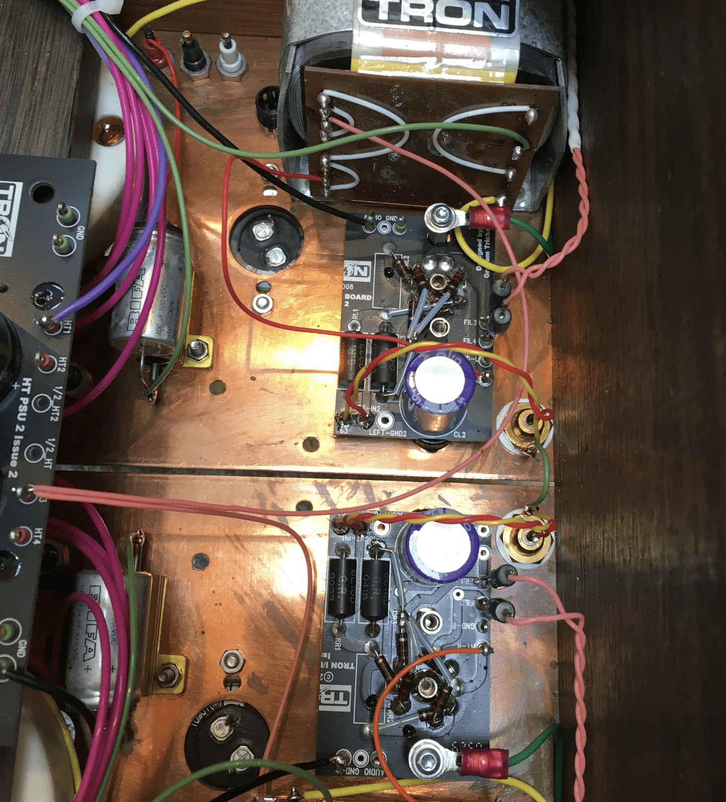

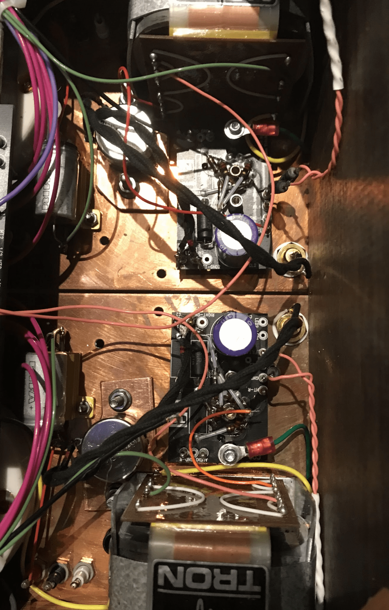

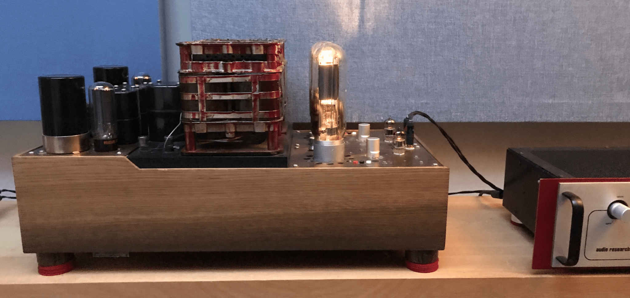

Thanks for the feedback, I took my time focusing on other activities outside the 211 - mainly due to the physical effort of moving the amplifier off it's shelf with its ridiculous weight, and various covid restrictions on having anybody come in and help move it with me.

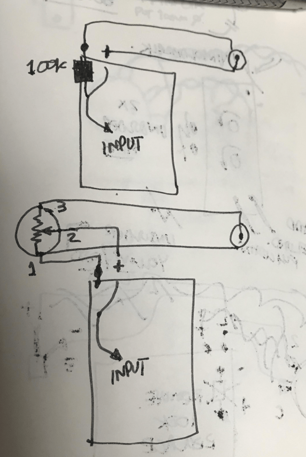

My friend also has a potentiometer on his power amplifier, and has been persuading me of the benefits this has in matching a high gain pre-amp. So I thought why not, as I had a perfect location on the amp to fit this in aesthetically and conveniently. I put in 2 x 100K pots, but no grid leak resistor yet, as I was confused on the advice on the size it should be with my 6c45 Pi input valve.
So the question is related to a ZZZZZ at relatively high frequency that I now have when using the pot turned down (not on full volume, where it is not evident).
I can't see why this would happen, unless it's the annoyingly close proximity to the interstage transformers, and stray fields to the new 100k mono pots see images that hopefully are clear, attached showing the before and after, with a circuit layout. I removed the original 100K to ground and this could work as the location for the grid leak resistor.
Any ideas?

I've found that adding a pot to the input of a power amp can cause oscillation at mid pot settings (in my case caused by RF/SMPS noise). Running shielded wire instead of twisted helped dramatically.

I suggest you set the pot where you want the level, measure it, and replace it with a 2 resistor voltage divider at the input (the opposite end from the RCA jack).

What I do get confused about is the effective input impedance of a potentiometer in the classic format I have used during its use over a range of positions. Just measuring DC resistance to earth of course it remains at 100K, but how does this correlate to input impedance?Well, you still want the constant resistor of some sort in this place.
Like I said earlier, 220-270k is high enough for not loading the pot output too much under normal operational conditions, and at the same time low enough to keep the 6C45P more or less sane should the pot wiper fail.
In the classic format where the pot slider is connected directly to the grid, the input impedance is equal to the value of the pot. This is because the grid is effectively open circuit.What I do get confused about is the effective input impedance of a potentiometer in the classic format I have used during its use over a range of positions. Just measuring DC resistance to earth of course it remains at 100K, but how does this correlate to input impedance?

You mean the two parts of the pot track. The top-to-wiper part is the series resistor,so the series element of the pot + the shunt left to earth together always = 100K, irrespective of the position of the slider?
and the wiper-to-ground part is the shunt resistor. Then regardless of the wiper position,
the series plus shunt sum remains at 100k, which is the input impedance.
If we neglect the tube's input capacitance, then the 100k resistance is the input impedance.
However, including the tube capacitance, the input impedance is not just resistive.
It becomes a complex impedance, which varies with the wiper position and forms a low pass filter.
The lowest frequency of the filter corresponds with the 50k+ 50k (-6dB) wiper position.
