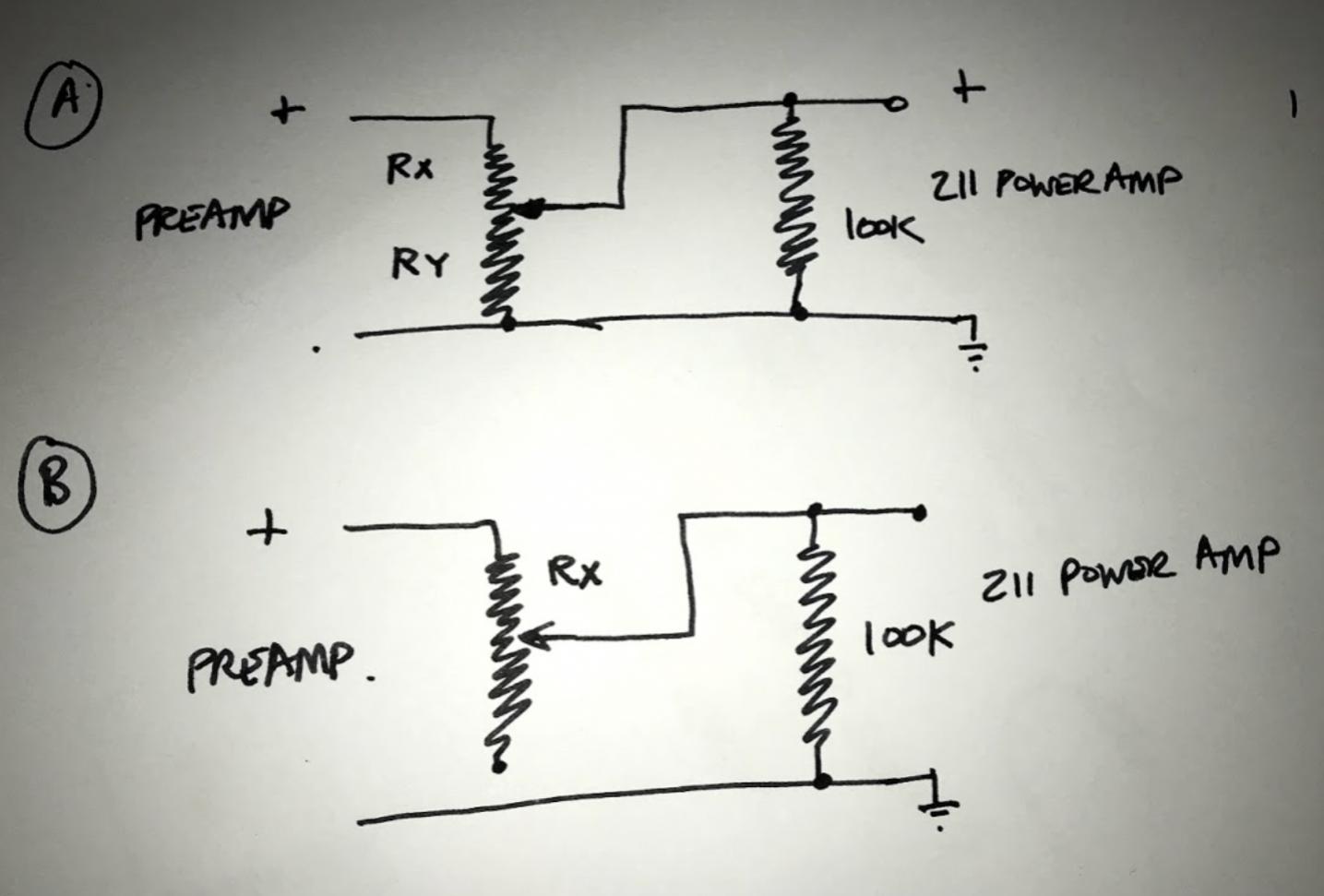

So a bit more thinking and some questions on the logic of input impedance.
If a 100K pot is put across the input in a conventional manner like this https://hfc-fs.s3-eu-west-1.amazonaws.com/s3fs-public/tkd_2cp25_datasheet_0.pdf
with top of pot connecting to input signal, bottom to ground/common and wiper to signal out. Then is the input impedance the sum of the resistance in the signal path and the resistance to (ie the whole pot 100K) or does is change according to the attenuation.
The reason I am asking is related to my set up where I have a fixed 100k to ground from the signal-in on the power amp (211 valve amp) and I want to add a 50K pot in before this (because I have one to try). I have 2 options as I see it, just take a part of the pot as a variable resistor and don't take the bottom of the pot to earth (option B in my sketch) and to take the pot to ground, effectively making the bottom of the pot in parallel with the 100k (option A).
So my question really is what is the input impedance in each case A and B.
Is A = Rx+Ry in parallel with 100k, and B Rx + 100k.
Probably really dumb questions but I think I am about to learn something!!

For case A, the input impedance at the maximum level setting of the 50k pot is 50k // 100k = 33k.
The Zin approaches 50k for larger attenuation settings, and there is an infinite range of attenuation.
For case B, the Zin varies from 100k at the maximum level setting to 150k at the minimum level.
The range of attenuation of the 50k pot is very limited, only about -3.5dB.
Only use case A.

you know what, i repaired a Realistic 6V6 SE amp, the main volume control looked like B...worked fine...
yes, and yes....i actually liked B, my reasoning is that the grid leak is fixed to 100k, plus loading the preamp is better in the case of B, because in A there is a 50k loading, in B 200k...
just be mindful of the noise....

Hey thanks everyone for some clear thinking 🙂
I have this 50K pot, and I can of course connect it in mode A and mode B. What I guess I will find out if I try them both is the influence of input impedance AND attenuation on the sound.
It all sounds good as it is now BUT the volume wheel on the SP8 preamp is a little bunched and sensitive. My friend who has an ARC SP10 and a Yoshiba 50 power amp with an included volume pot says he really likes the ability to play with the influence of how the pre and power amps contribute to the sound character to get to a good 'balance' should it sound more 'ARC' or 'Yosh'.......interesting concept I guess, I've never thought of it like this before.
I use this website to determine how much gain loss I will experience when playing with the pot, so agreed with case B I am pretty limited, just not sure yet if 3.5 dB is enough (probably not!)
