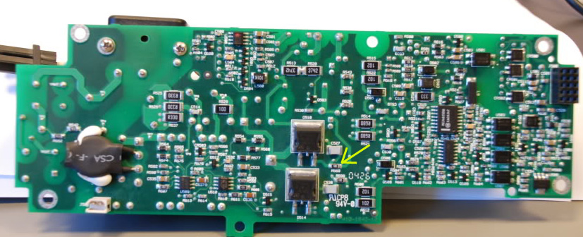

I have a Infocus LP600 in the shop for repair. Pulled out C1 and C5 to replace once new stock of caps arrived. Unfortunatly I'v misplaced them and have no idea what value they are.
Does anyone have a schematic and can tell me what value the caps are? They should be just startup caps so suspecting nothing over 47uf and would assume around 25V as they were small caps.

I do not seem to have this C3 that I'm supposed to replace. Can someone point out which one(s) should be replaced? (Picture URL below)
http://dl.dropbox.com/u/3236554/100_0526.JPG
I'm thinking the ones at C16 might need to be replaced since they seem to be bulging a bit.

Hello all. After much searching I'm still having trouble with my LP600. I have replaced the 5 caps shown in jeffn2001 picture. After replacing the caps it will now power on but hang at"Powering up, Please wait" and a #. It's random on how far it will get. Sometimes it will hang immediately at 7 and other times it will make to searching for input but it will always hang at some point. Could someone please give me some advice to repair? Thanks.
Sorry for posting again so soon but I forgot to mention that I was experiencing the power supply cap problem (fans would come on when plugged in, no display at all, and wouldn't power on when pressing the power button) before replacing the 5 caps. The projector was always in stand by mode and hardly ever used so I figured it would be a fairly easy fix.
Are you sure the caps are the write way round? I mean the polarity? Also the caps replaced are new I take it? There are 2 types of power board, are you sure it is the same type as what jeffn2001 posted?
Hi Gizmotech! Yes, I have the board that jeffn2001 photographed, at least it looks identical. The caps were new. I will double check that I have the polarity correct and I will also confirm the board part #. Do you think that it is still a caps issue? I did use 470uf 35v caps. I didn't think that would be a problem. Thanks for your help!
Sorry for taking so long. It's been a busy summer. The polarity of the caps seem to be correct. I am going to try re-soldering them though. After looking it over again I'm not too happy with how a couple came out. I'm not the greatest solderer yet. The part # for the board is 510-1842-20. Thanks again.
