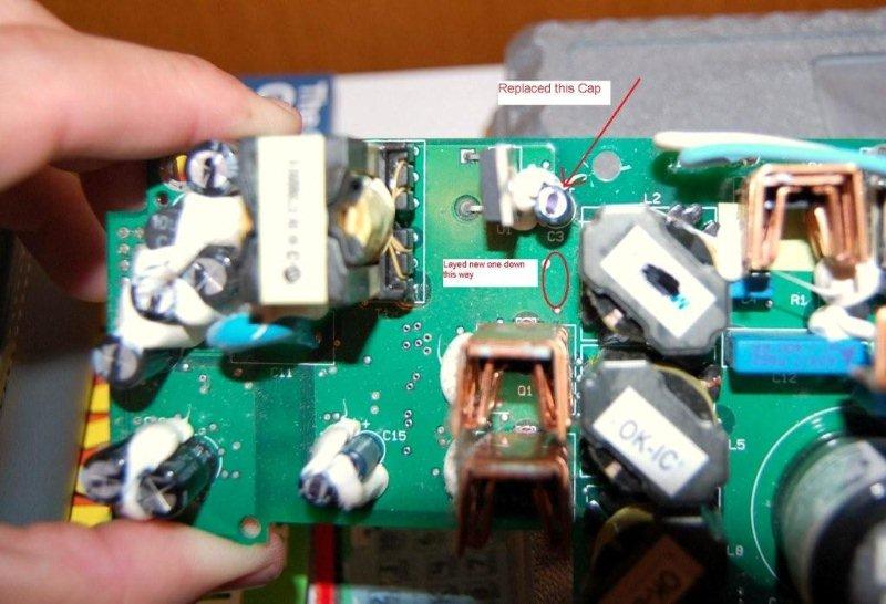

You are correct to some extent, but your analysis is wrong.
there IS a design flaw to the infocus magnatek power supply.
If you look, the only cap that actually goes bad is the 100uf cap right behind the chopper controller output IC.
Why? if you look, for one, this chip has no heatsink, and 2, the capacitor is right behind it directly against it. this allows the heat to transfer from the chip streight into the capacitor, almost like they did this directly on purpose so it will fail soon.
remedy for that is to put the new capacitor in, but only push it in a little bit, soldering it in. which will have super long leads. then bend the capacitor over, away from the heat of the IC.
problem solved.

question for mbates
Not sure if you can answer this mbates, but are you referring to the capacitor at location C3 on that board? Thanks!

mbates14 said:You are correct to some extent, but your analysis is wrong.
problem solved.
Followed these directions, replaced that one cap, back up and running. Also took your advice and left some leads on the top and moved it away from the IC. See attached pic..
