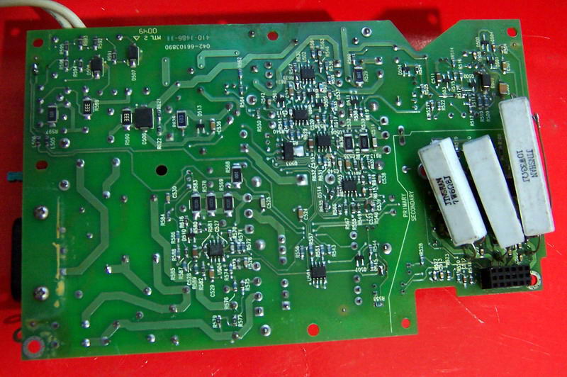

It appears that the power board on my LP600 is toast. Nothing appears "burnt" but there are no lights or LCD when it is powered up. The fuse on the board is OK and I'm scratching my head trying to figure out next speps. The board assembly number is 510-1842-16. Every search engine I'[ve tried gets me right back to this forum which does not appear to have a LP600 thread. Any advise from anyone will be much appreciated.
Hi, i have the exact same power here. I will supply some pics soon, just gotta get a hold of a camera.
I did some measurements, but im not sure what to expect where (i only got the power board, not the rest as im trying to fix this for a friend)
Im getting around 2V on the lamp connector and 5ish V on the square connector on the underside of the board. Mate says it doesnt work tho, he tried changing bulb etc and reconned that the power was bad.
Was not able to edit last post (possibly due to me being a new member) so here is the pictures i promised.
Hope this is what you were looking for!

on the mains section of the power supply board you have 4 100uF/16v and 1 4,7uF/35V electrolyt condenser of a 85 degree type. that means it will work 2000 hours at 85 degree (celsius). since the power supply only switch off the lamp in standby with no fan the power supply get hot- i think about 70 degree. so after two years in stanby it is evident that this condensers loose halve of their capacity - after switch off no new start. changing this condensers with new ones of 105 degree type will solve tis problem. and for the future - no more stanby.

I managed to buy old working power board quite cheap and made few measeures on that one.
DaGimp were right. I needed to replace only 3 of those 85 C condensers and now power board works nicely. I finally replaced all 5 of them to be certain that it will work longer...
