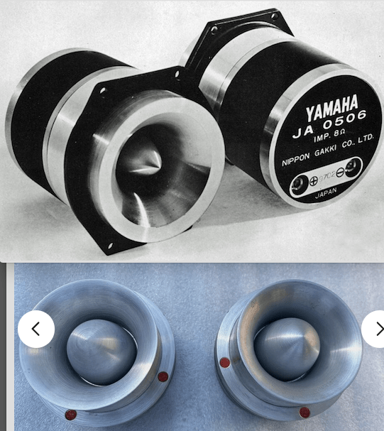

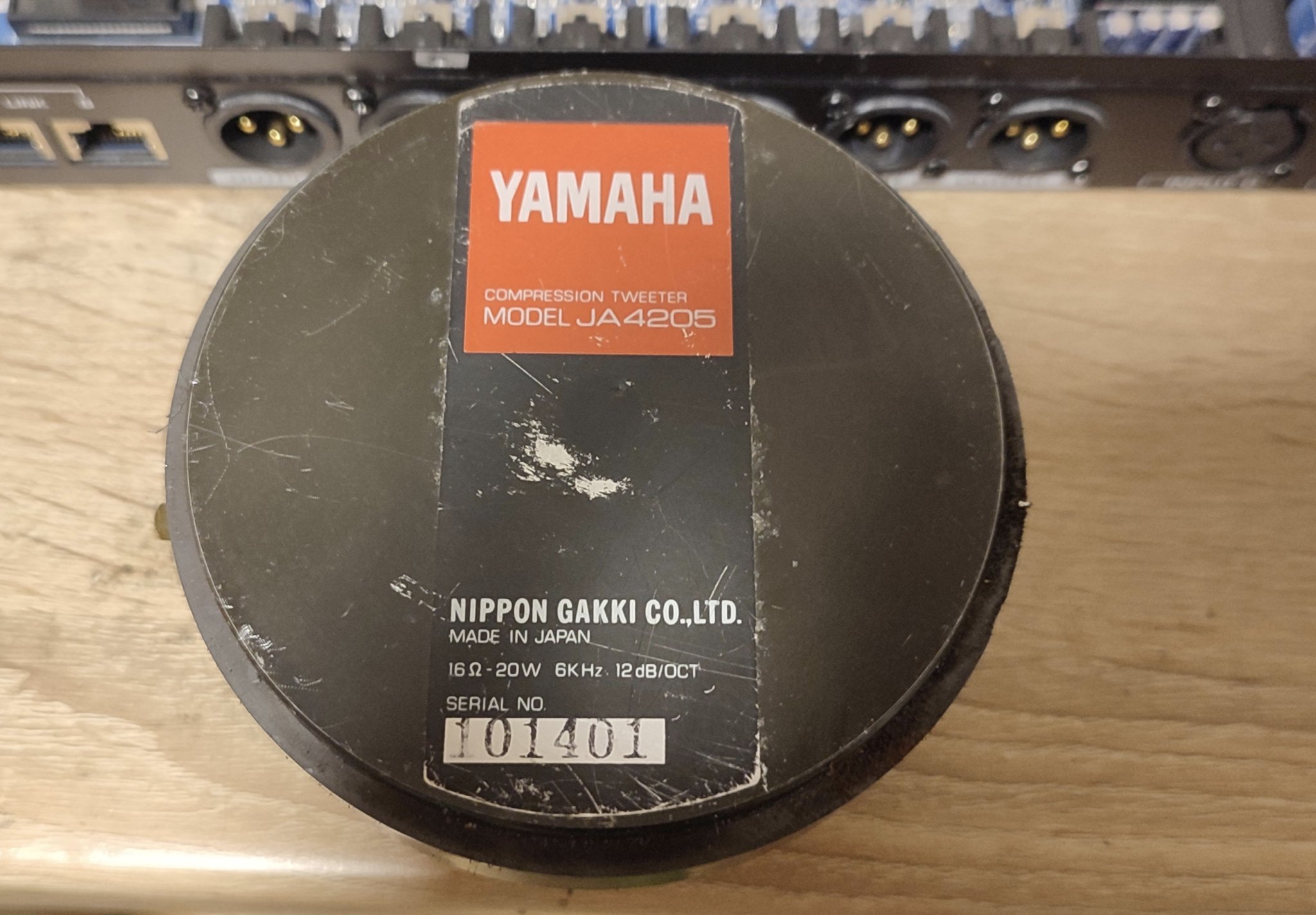

Yes you are right it was not the S4115 where I got my JA6603 out of.
Mine looked like it but had a bullet tweeter
next to the mid horn (JA4205) I think.
Do you know which monitor this was?
Bass speaker and horn was black not white.
Yamaha introduced the JA-0506 "bullet tweeter" in 1973, they may have been used in some form of "NS" (Natural Sound) monitors, none of which I've ever seen in real life or on line.
Other than Meyer Sound floor monitors using some variant of the JA6681, never have seen any cabinets using them.

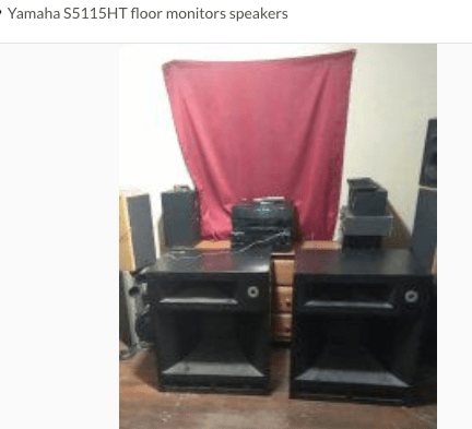

I really want to know which cabinet it was, as I
need another phenolic diaphragm to
experiment with.
Back then I didn't pay attention what model
monitor I purchased. I salvaged the
components and dumped the cabinets.
My cabinets where originals that's for sure because you can't run the JA6603 without a
tweeter as it only reaches to 8khz.
All I know is that I had seen a few of the same
cabs on a Canadian listing.

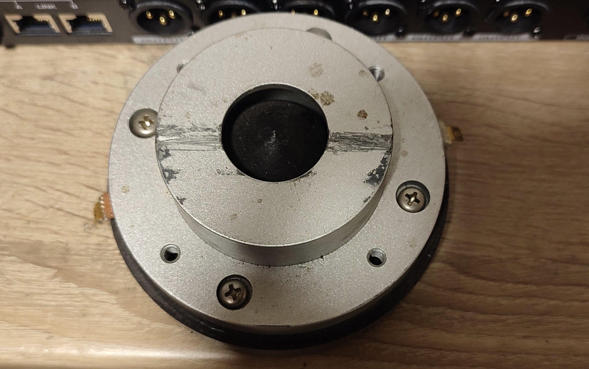

Here is a picture of the tweeter that I have just taken this morning. Same sonic signature as a EV T350 but not as detailed and refined as my Fane.

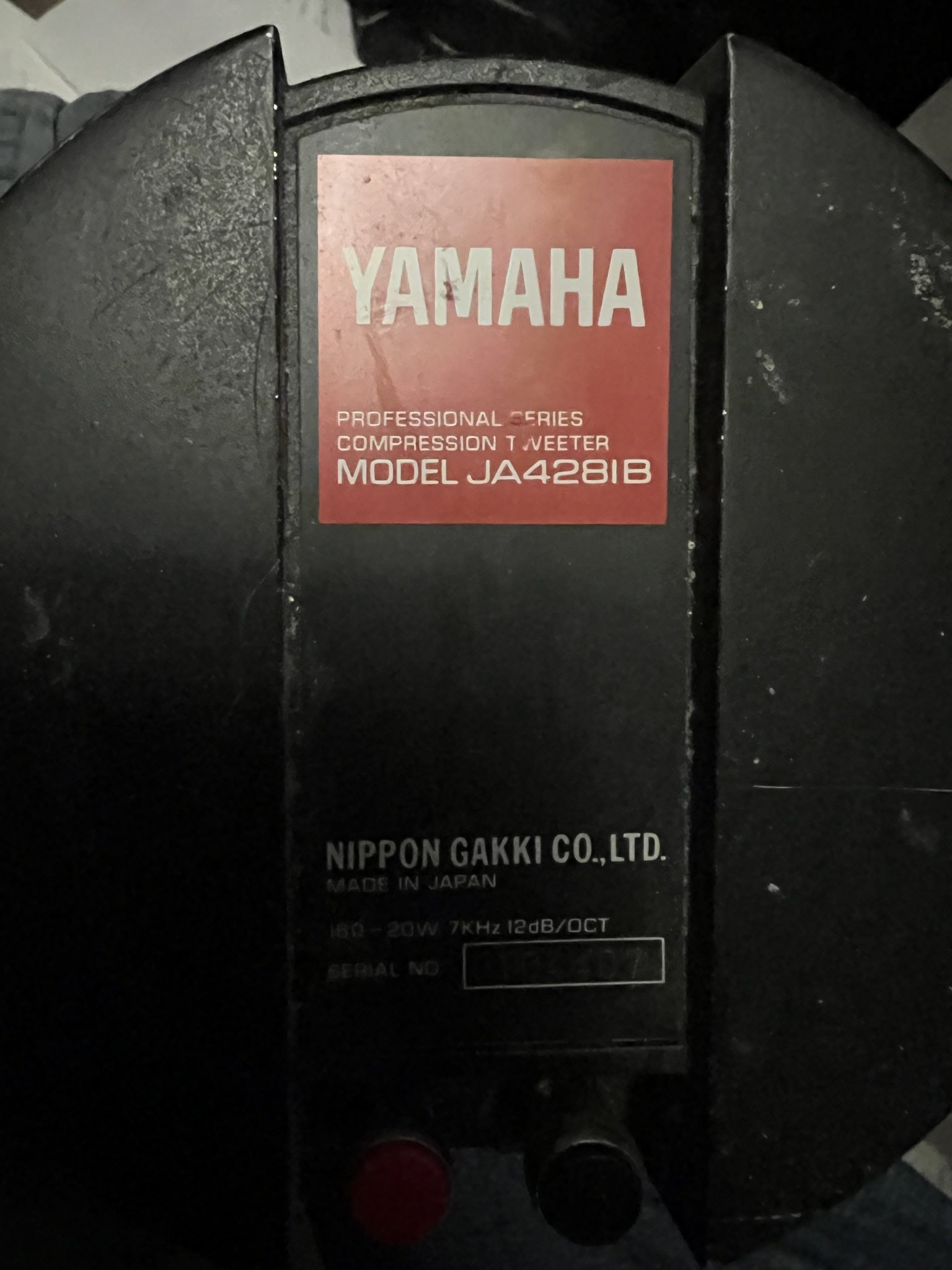

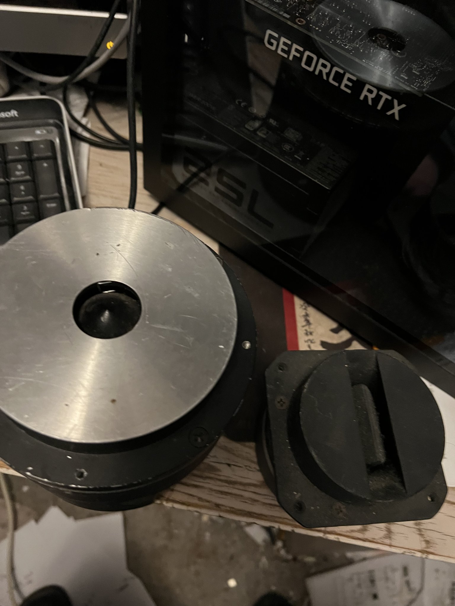

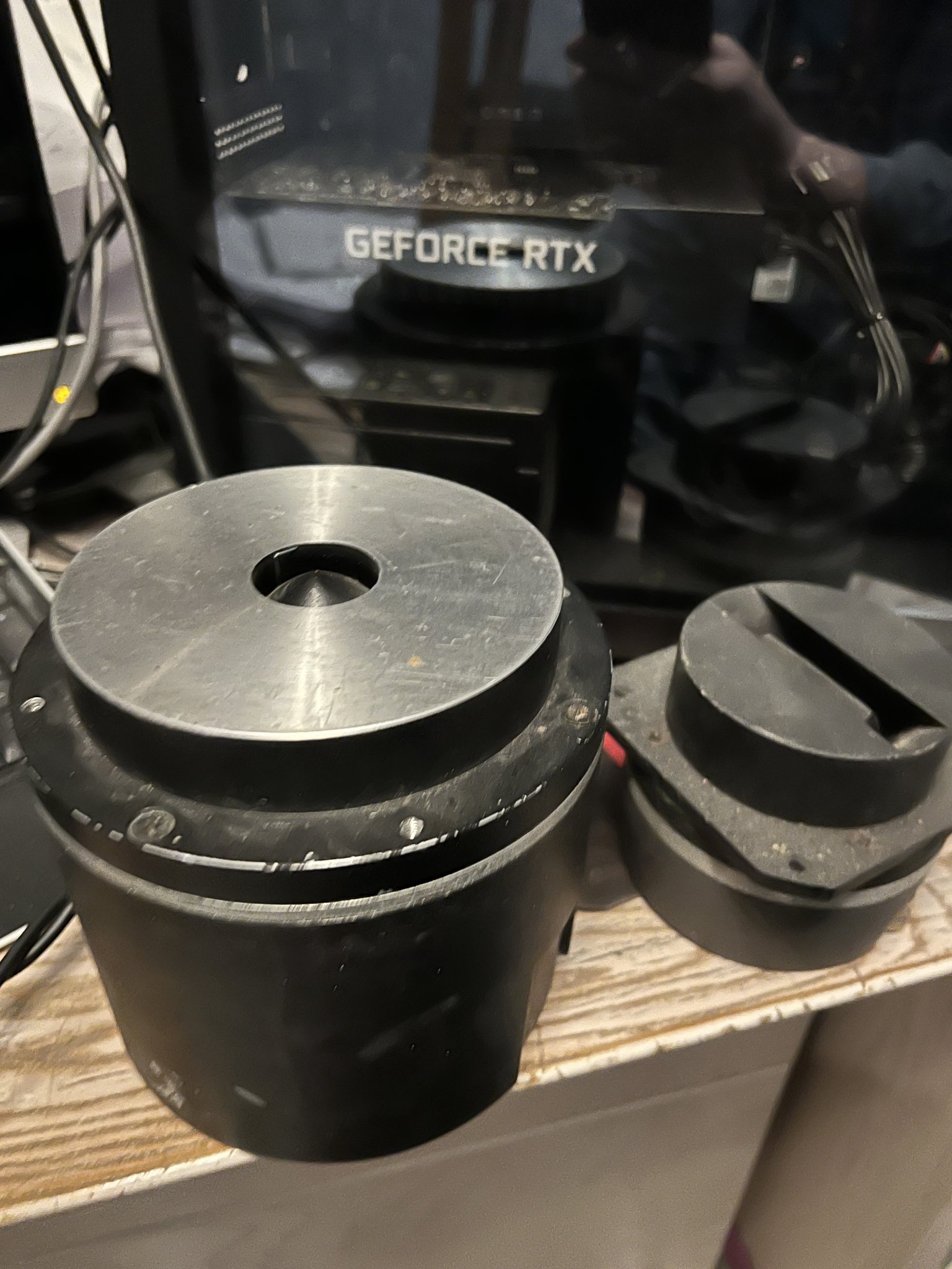

The Yamaha JA4281b Alnico Tweeter. I have a pair to sell.
Fair condition. JBL 2405 shown for size comparison. $300 USD plus shipping.for the pair.
Big , heavy , and nice.

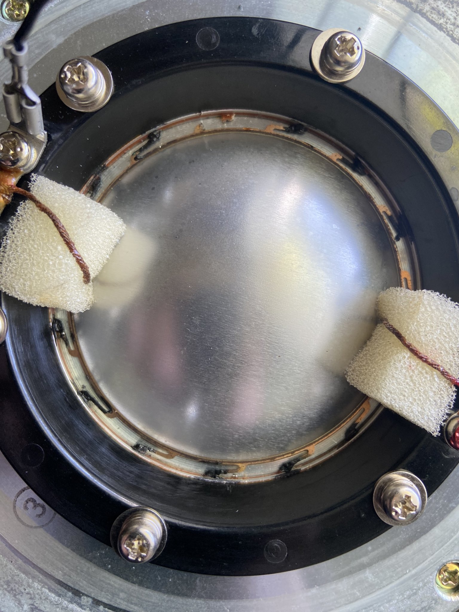

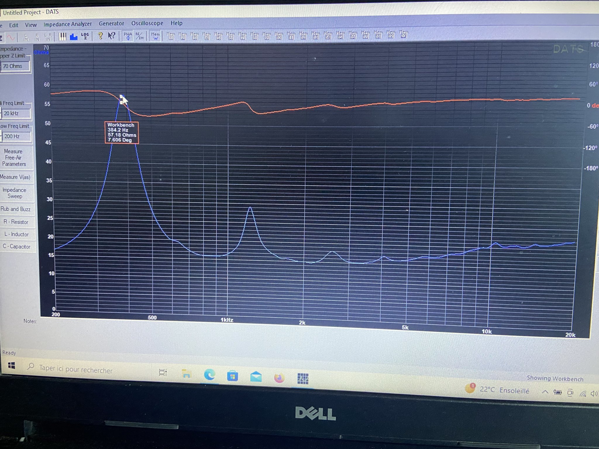

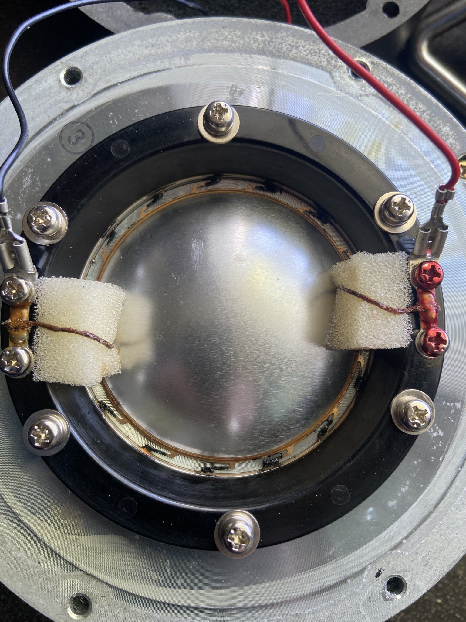

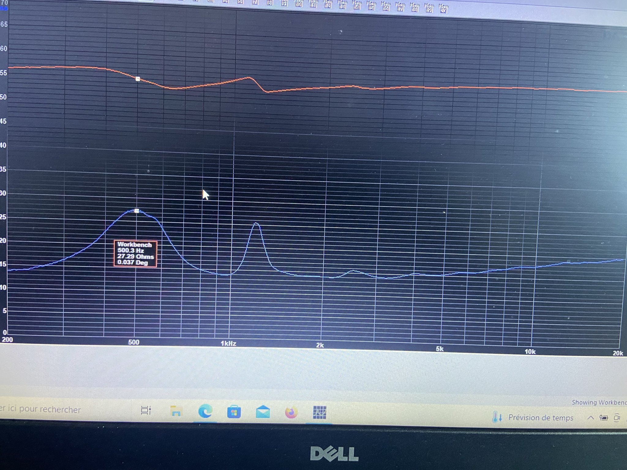

Hi
I have two MS1401A drivers and they have an unleven Z response : the fisrt has a high Q response at about 400 Hz 60 ohms and the second has a very low Q reponse : only 20 ohms at 600 Hz.
I have have genuine JA6681B drivers and their responses are about 60ohm@400Hz
Do you have any idea what could be causing this? I tested the sound response of the TH4001 horn: the bad one seems to be less good.
Attached photos of diaphragms and Z response with DATS.
Pascal

Align the voice coil by loosing the screws and adjusting the position of the VC while playing a lowish tone from a tone generator jntil you get a clean sound.
One of them could be blown and have a deformed VC. If so, try to replace.
