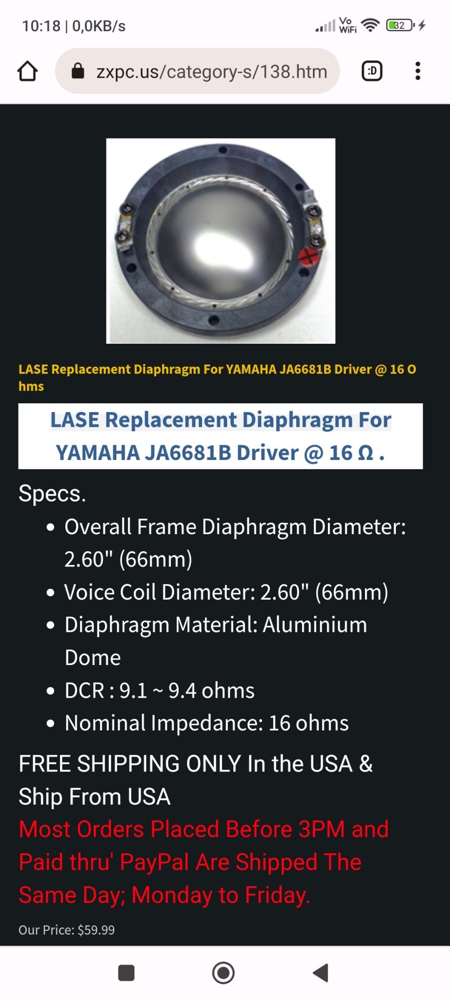

Rewind, would you evaluate these diaphragms?
I assume they will suck but we might get a voice coil and a frame for little money. It might even have a decent aluminum dome who knows. For the price it's worth a try.

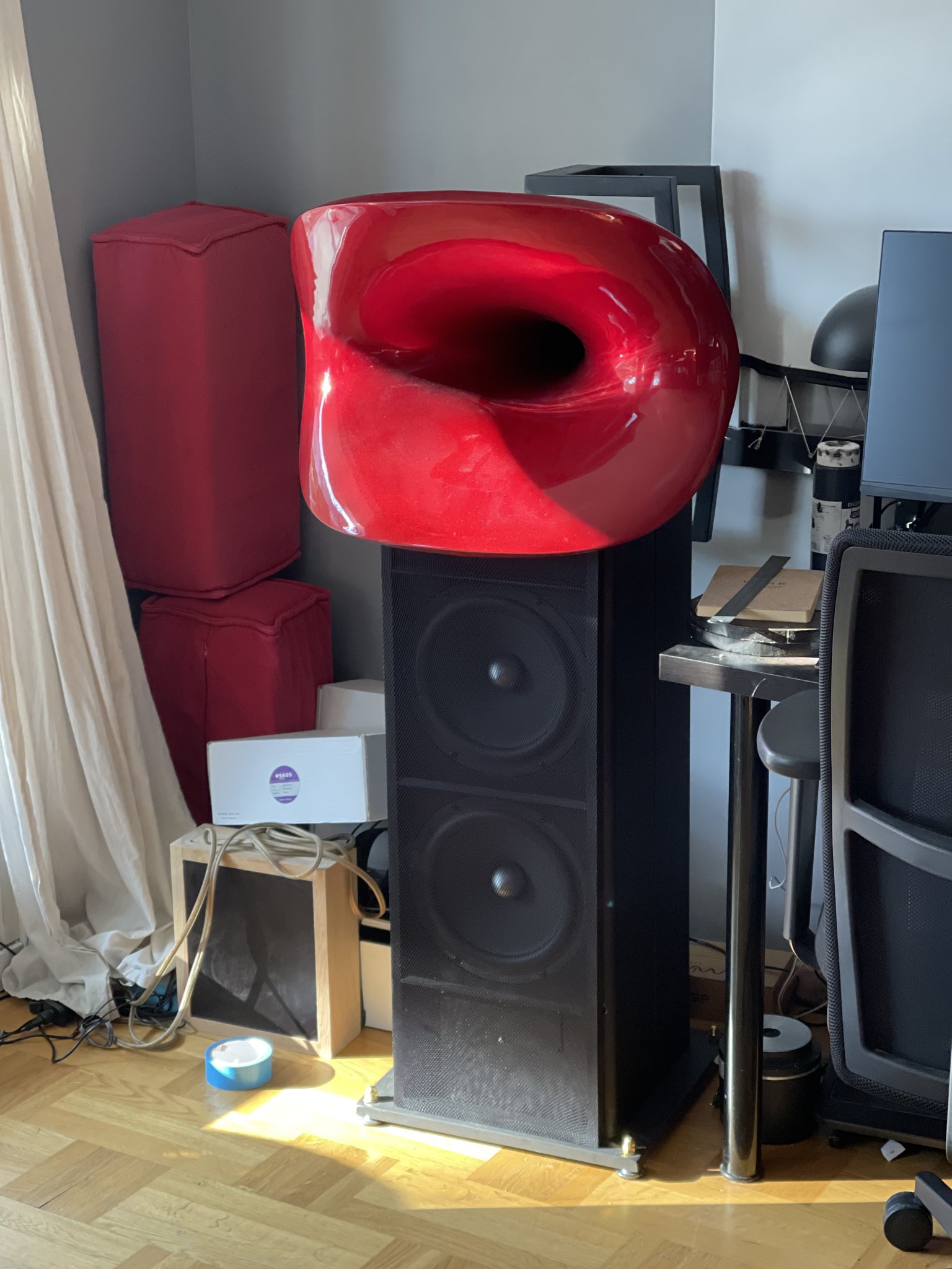

Yes, the Raal was nice, but JA6681B is much better without any autotransformer, L-pad or even series resistor, which was be required when playing JA6681B with the Raal tweeter on the same amplifier. I will try the HF10AK more soon. My first impressions are that HF10AK is smooth and clear, while Raal is a bit timid, but possibly more detailed. Maybe I can hear a slight roughness with the HF10AK, due to some breakup, or whatnot.
I have the regular round JMLC-1000 horns. I also tried JMLC iwata 600 with the HF10AK and the JMLC-1000 sounds better with the HF10AK. I use JA6681B in Iwata 300 and possibly 600. We will see. Right now this 2-way is playing the socks of anything I have heard: JA6681B in iwata 300 and four W26FX002. The woofers are surpsingly articulate for being slow home hifi bass woofers. View attachment 1179675

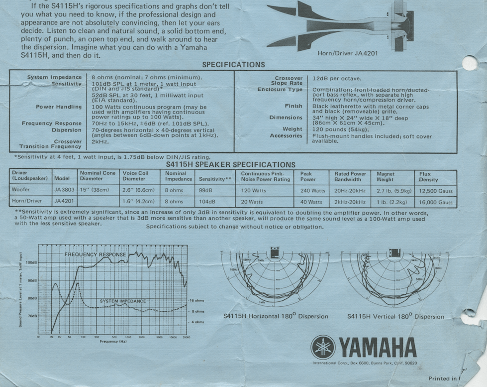

While it is unfortunate that 66.6mm voice coil aluminum diaphragms for the Yamaha JA-6681 using the 15 tiny copper beryllium arms for suspension are not available, there was nothing in the original design that I thought was particularly compelling.
In case anybody is starting the thread from scratch, one correction should be noted: In post #10 Radian wrote:
"If you got the 6115H or the 6215H Monitor then there is the JA-6681b in it. If you got
the 4115H then there is the JA-6603 in it."
The Yamaha S4115H and the floor monitor (S2115H?) used the JA4201 Horn/Driver, a much smaller 42mm (1.6") diaphragm, crossed at 2000Hz.
