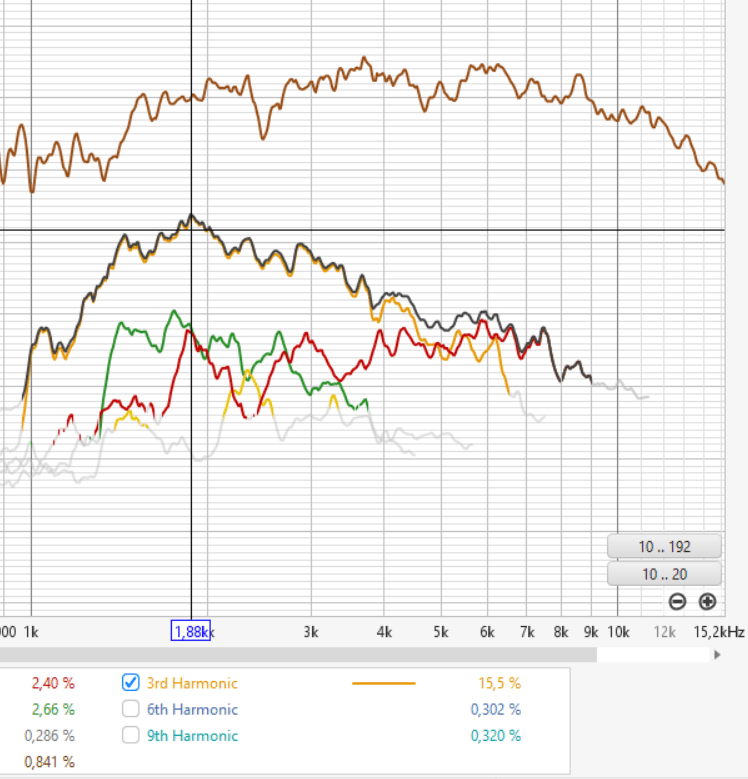

I bought one for a compression whose diaphragm had been "repaired" by soldering copper wires to the broken fingers. The "Lase" diaphragm rubs in the air gap, I have 15% distortion...Hey since you have the ja6681b do you think this is for real or fake

1) Is there any play in diaphragm placement when you tighten the screws? If there is, try moving the diaphragm up, then to one side, and finally to the other side. It is a trial and error process while you measure with REW. Loosen screws, push diaphragm, retighten screws, measure and repeat.
2) If this does not succeed, you could try massaging the suspension to reposition the coil where it belongs. I’ve done this on cone drivers and I suspect it might work on a compression drivers too - but have not tried. If you wish to, give the diaphragm a mini workout with your fingers by pushing it in and out in a pistonic movement. Place fingers around the dome, just inside the suspension.
3) I think the screw holes and wire design allow this: remove and rotate the diaphragm X degrees before screwing it back in.
4) Triple check that the gap is clean. I suppose you have already.
5) In last resort, take the diaphragm off and verify with a calliper that the coil is perfectly circular. Beware of damaging the coil.
You are supposed to run a low-ish frequency with a tone generator and fasten the diaphragm where you here the least amount of distortion. It can also be measured in realtime.

Sorry for the late reply...

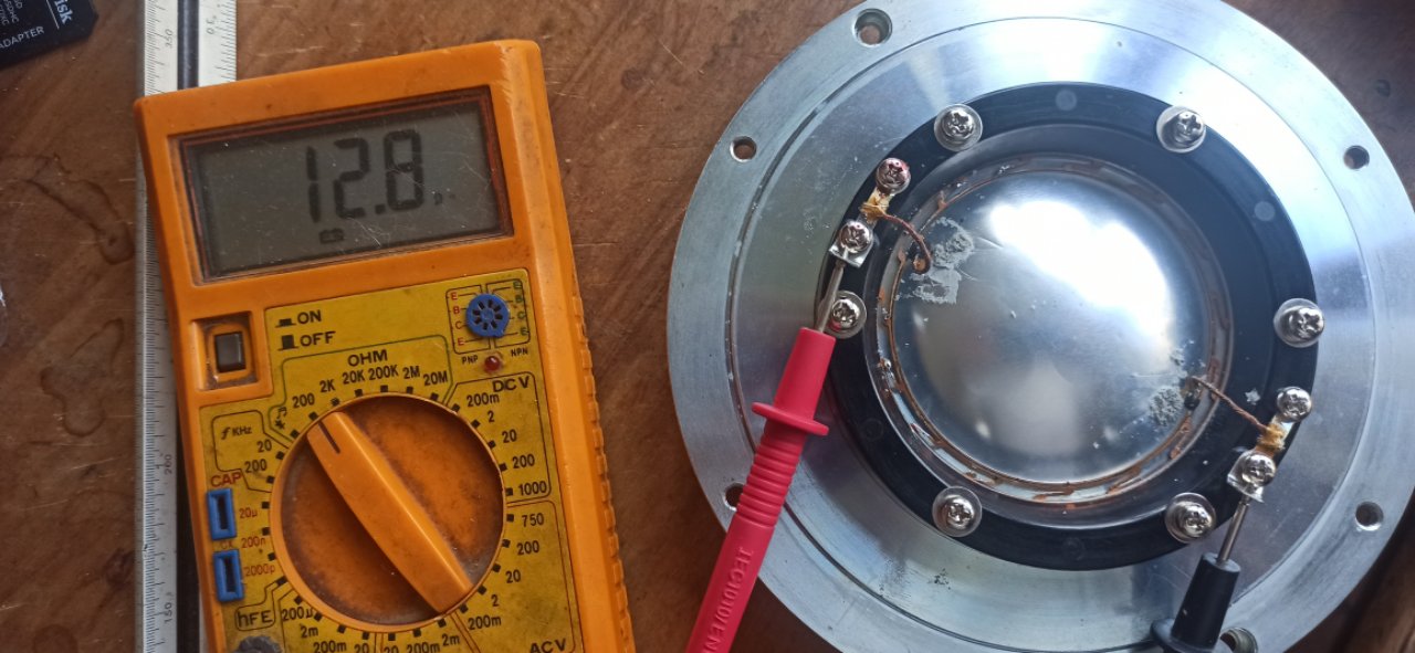

The inner edge of the diaphragm was rubbing on the inside of the air gap. No way to adjust in any way: clearly the coil diameter is too small...I returned the diaphragm and am still looking for a solution...

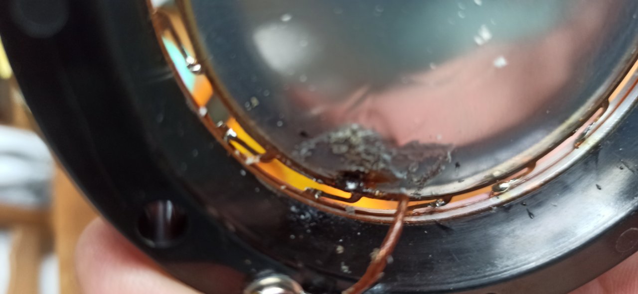

Here is the last compression, with the original "repaired" diaphragm.
I removed the two damping foams (transformation by Meyer Sound) and resoldered one of the coil wires...
I'm going to try to unsolder the soldered copper wires and replace them... I saw that there could be sheets of copper-beryllium alloy, but that seems complicated to me... I'll perhaps try with a material that remains quite flexible, like silicone...

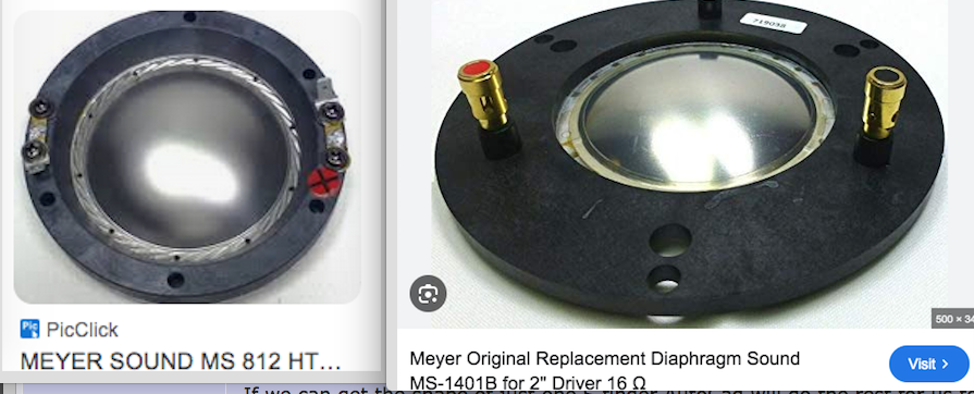

I just send this message to Lase:
Hello,
Many audio enthusiasts and professional public address sound system companies are in need of the Meyer Sound MS 1401a diaphragms but unfortunately the Lase diaphragms voice coil is a tiny bit to small and therefore not usable.
Would you be willing to contact the manufacturer to let him know the issue?
We are gladly sending in a MS 1401a compression driver for manufacturing purposes if needed.
Klaus Freis
Hello,
Klaus Freis
