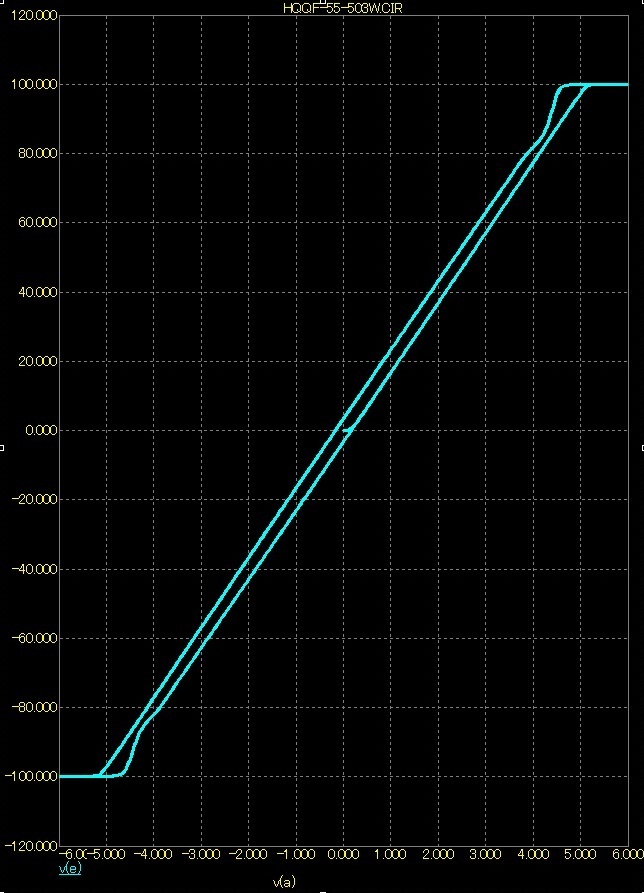

Graf is too small for accurate analysis.
It is seen that the output phase is over 10 °, a large shape distortion, the difference between positive and negative half wave, the difference between boarding and descending edge. Lots of local feedback, charging and discharging capacitors the not same current, so lateral tilt. Some of the PNP transistors is too slow because of the wide upper and lower narrow.
I could go, what you can read ...

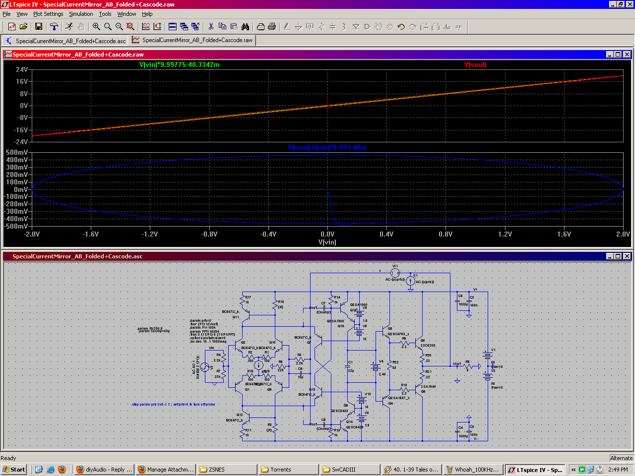

How about this... Phase shift is 1.3@100KHz. I threw together this one with drive and BW in mind... If the load ever drops below 1 ohm, god help those Toshibas... Same thing if it oscillates. Lord!
Unfortunately it has some issues which place it in the hall of shame, it's not currently a practical design.
- keantoken

Strong "sticking" in limitation in post 493, caused by heavy saturation.
It is obvious, VAS probably haven't antisaturation circuit....
Driver HQQF-55-502D, a large input signal 10V! Large capacity in the overall feedback. Sample inappropriateness overcompensation feedback. Capacity may be neither large nor small.
- keantoken

Interesting and very quick engagement, large bandwidth, more than 3.5 MHz. What are they doing to end cross-currents of transistors?
