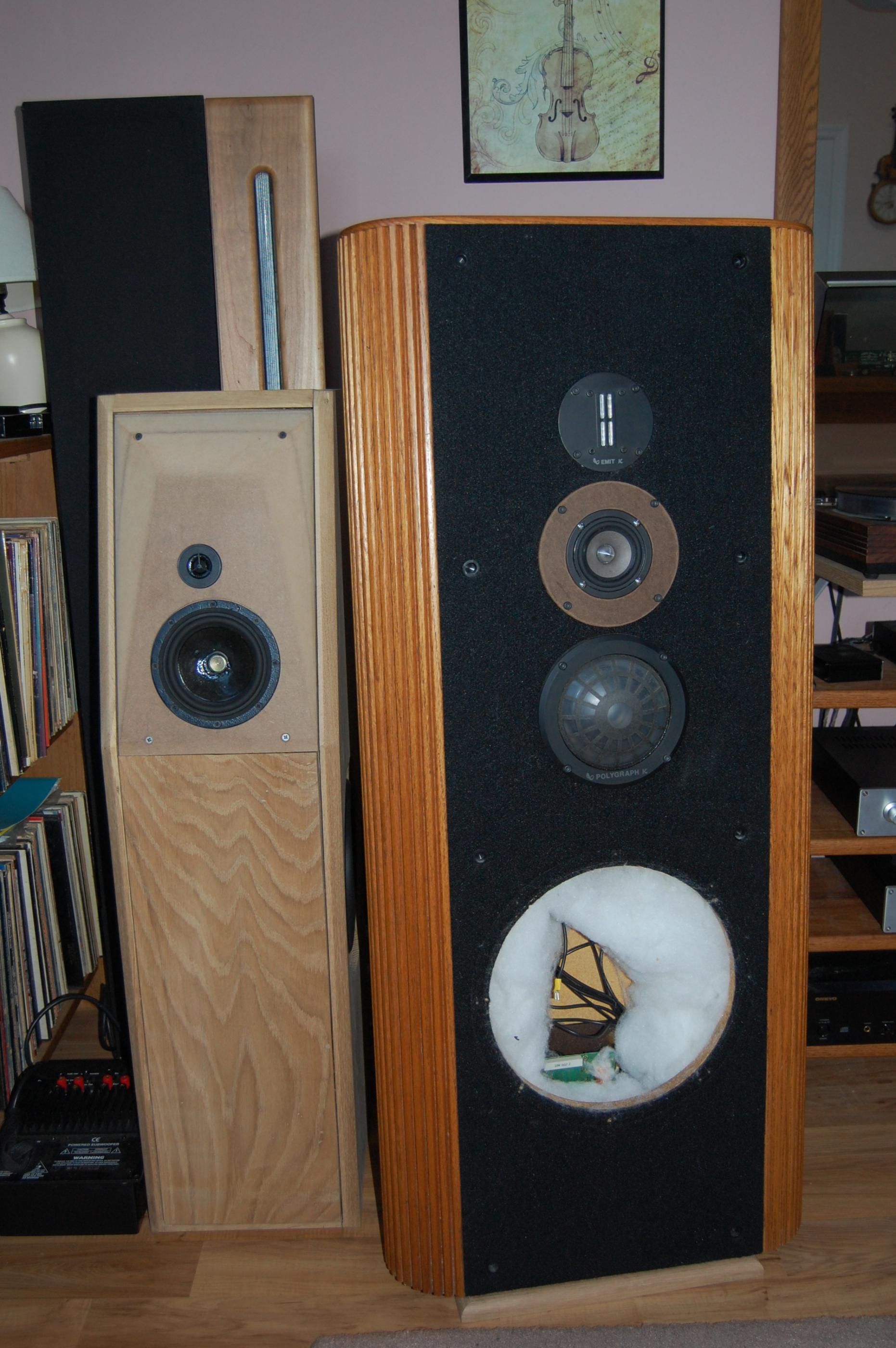

Here is a pic of the wooferless enclosure and alongside is my home made 3 way using Royd 5" woofer and 3/4" vifa tweeter with a side mounted 10" Dayton sub(being used right now for the Kappa bass). Behind that is my highly modified Apogee Centaurs that has been my reference for 22 years(sublime from 500HZ up). I built some 38 ltr ported enclosures for the 8" Vifa woofer, biamped - made a huge difference and are still my reference. The problem areas with the Centaurs that remain are the vertical dispersion and "head in the vice requirements". I don't like it anymore when a piano wanders around between the speakers. But that silky midrange is beguiling.
Oh, and there is a Frugelhorn hiding behind but - not visible that has wonderful imaging but doesn't provide the low end weight to say, a double bass that a 10 or 12" woofer does.
As you can probably surmise, I am a DIY addict!
Cheers
Peter

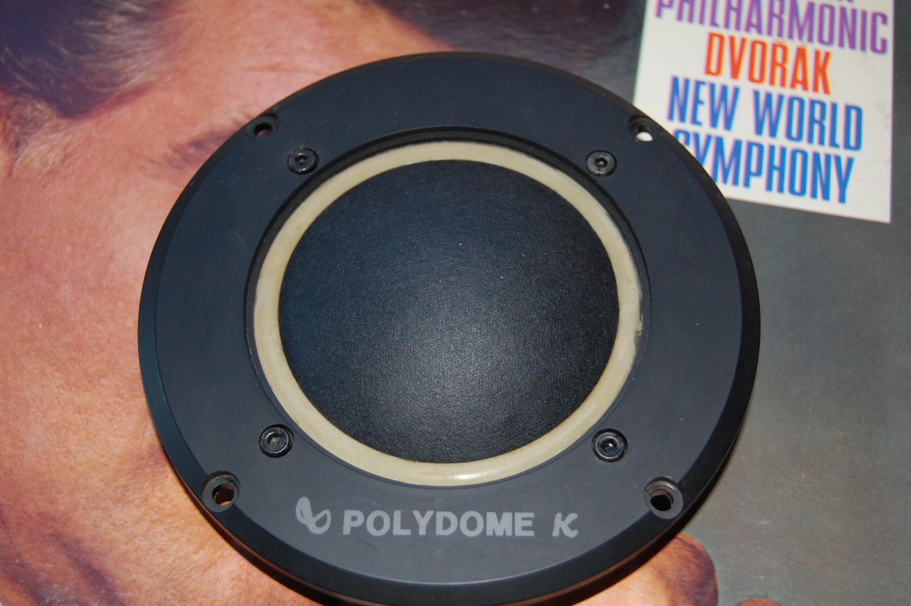

In an attempt to salvage the broken polydomes, for $4.00 apiece, I purchased a couple of 3" paper dustcaps from Simplyspeakers.com and after cleaning the good surrounds, attached the caps with Aleene's tacky glue and let them sit overnight with a ring shaped weight to provide slight pressure while the adhesive set.
I haven't had time to listen extensively, but initial take is measured frequency response through the stock crossover is good - very similar loudness to the Tang Bands, but maybe a little less "edge" .
I'll install both modded polydomes after the weekend and give them a good shakeout.

The redomed Polydomes are playing very nicely, the woofers arrived early and the refoam kits should be here this week.

The paper dome polydomes have been replaced once again by the 3" tang bands.
I could live with either one, but after my better half auditioned them "blind" with some solo piano music,she said, not knowing which was playing, that the poly sounded like a recording of a piano and the TB sounded like a piano. I have to agree.

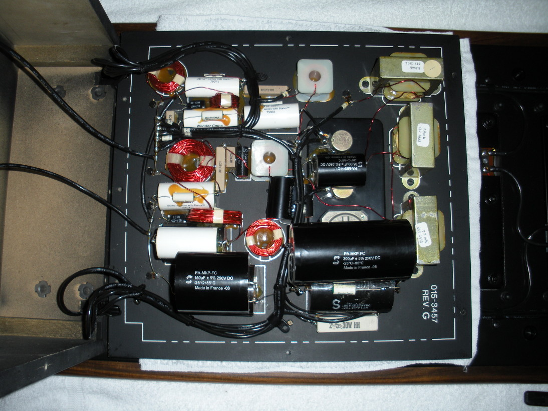

I had previously upgraded the caps in my IRS Betas to new non polarized caps, and gave them plenty of time to break in.
A week ago I removed those and replaced them with Solen PA Series Polypropylene Fastcaps that I had already been broken in.
I am convinced that the Solens are definitely worth upgrading to.
Next on my list is to replace the 3 iron core coils with Solen air core units, and also considering a cap (or at least bypass cap) upgrade from the oem Wondercaps to something like the Jantzen Superior caps.

Be careful disassembling the emits, they have powerful & brittle magnets that can easily be damaged or shatter if they come together too quickly.

I have played with polydome alternatives though and found that the 3" Tang Band bamboo driver suits my tastes better than Dayton 2" mid dome. The Dayton has more detail but gave a strange touch to some acoustic recordings, xylophone in particular. They sound a bit like wind chimes!
