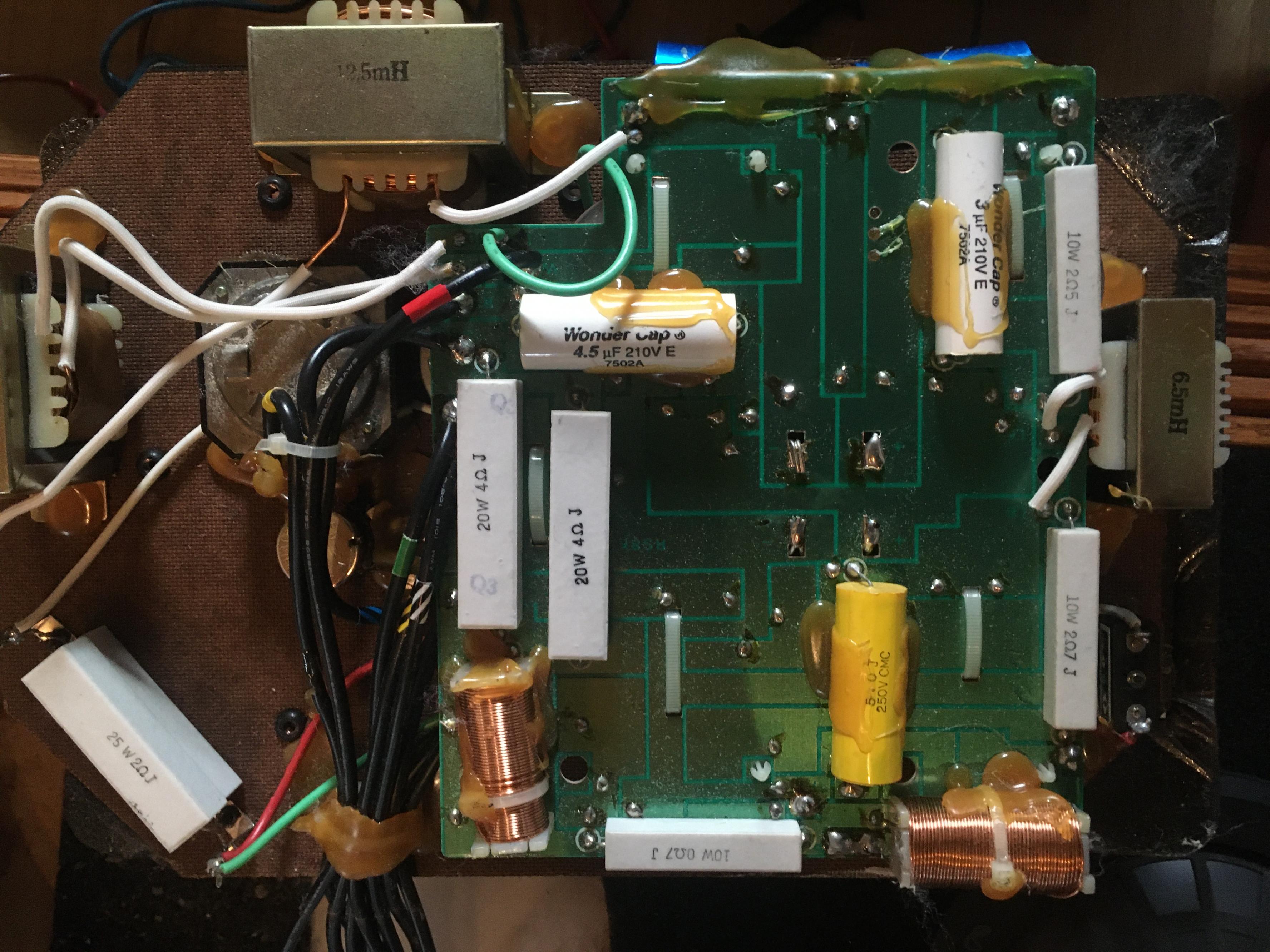

I´m trying to rescue my Kappa 8 too.
Infinity Reference Standart Series RS-8 Kappa

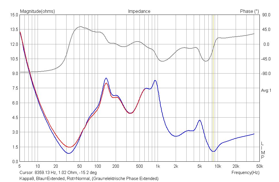

Because high distortion and weak bass transmission of most amplifiers I have check the schematic from low pass section of the crossover network - go to the attachment.
I can't understand how to choose such a design.
1.400µF NP capacitor (composed of two blue 700µF ones in very small sizes) and inductors in transformer design. A desaster for most amplifier models, extremly low impedance minimun - go to attachment and post #4 under
https://www.diyaudio.com/forums/full-range/207548-infinity-kappa-8-modification.html#post6108665
and often exploded caps is the consequence.

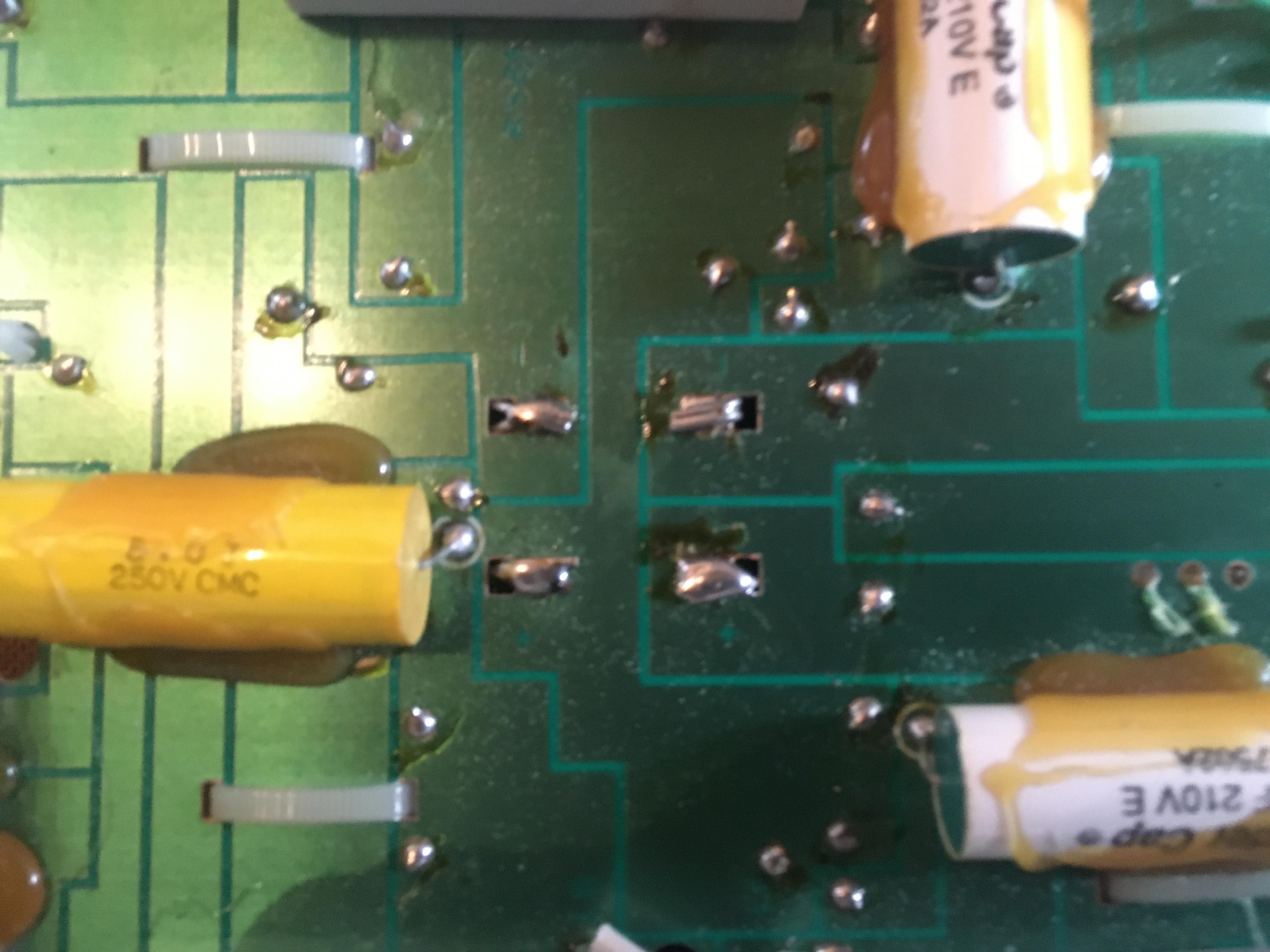

I cut the rail between the "+" input terminal and the input of low pass filter (pins of 2x700µF) and desolder the "+" cable of bass transducer from low pass filter output for connection directly to the "+" terminal
Because a bi-amping mode was already present only an active crossover was introduced. I choose this version from Behringer (cut-off range between 90-900Hz):
Behringer CX2300 replace caps (values change)
Together with NAD's power amplifier 208 under
Spezialanfertigung für meine Neue NAD 208 THX, Verstärker/Receiver - HIFI-FORUM
and
NAD 208 POWER AMPLIFIER Service Manual download, schematics, eeprom, repair info for electronics experts
now excellent sonic results.

in the attachment the associated images:I cut the rail between the "+" input terminal and the input of low pass filter (pins of 2x700µF) and desolder the "+" cable of bass transducer from low pass filter output for connection directly to the "+" terminal.
RS-8 Kappa crossover network - before cutting rail to positive input terminal for bass.jpg994 KB · Views: 272
RS-8 Kappa crossover network - before cutting rail to positive input terminal for bass-II.jpg714.6 KB · Views: 318
RS-8 Kappa crossover network - after cutting rail to positive input terminal for bass.jpg980.9 KB · Views: 262
I know this is an old thread, but I’m curious did this work for you? I’m purchasing a used pair of K8’s in a couple weeks and this is a concern of mine. Many up years ago I had a pair of K9’s, brand new and I had a rough time driving them. In fact, they were a total pia to set up as well. Do to the headaches, I traded them shortly after. It may have been the equipment but if this mod worked, I may do it right off the bat. Also, if it worked, did it affect bass performance at all?
I wanted to do it, but just dont have time at the moment. Can you please install VituixCAD or another XO sim software and make the speaker XO in there. After you do that can you please post the filter gain curves here. We can suggest you how to do something with the XO without altering the response to much, but hopefully can help to improve the impedance. You can of course can play with the simulations yourself and see what you can come up with.
Yikes! I was hoping for an easy solution. This is way over my head vs unsoldering a wire and relocating it like mentioned above. I’m curious if bi-amping would help the impedance the amp see’s
