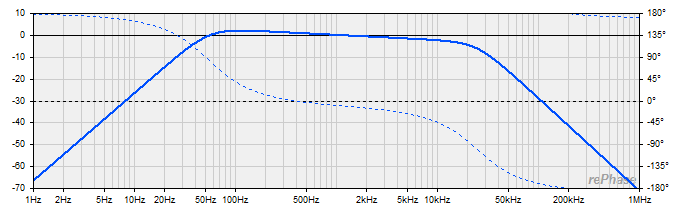

This is a good test, also of absolute phase of the membrane's direction and all the elements arriving at the same time. I'm not sure what you mean by "in their particular phase" thoughI mean, in nature, if you whack a kick drum, all the frequency components, all the harmonics, arrive in time, in their particular phase. How can a speaker replicate that without linear phase?

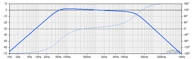

If phase doesn't matter this one should sound perfect shouldn't it 😀 but case is rhythm falls total apart and foot really stops tapping, suggest try it yourself 😉:
This is better than above but still rhythm is not right and foot tapping is not very often because one sense bass attacks comes a micro bit too early, but it works very well and sounds natural for the case where one listen from outside the room via a open door 😛:

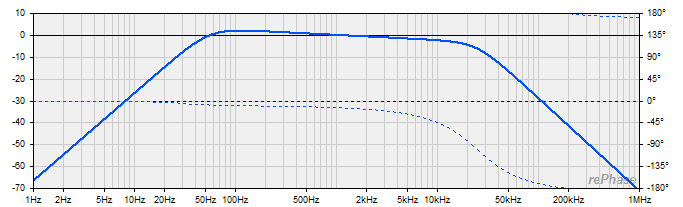

Think this one is much better than the two above in phase follow amplitude for system band-pass and FIR DSP help discuise where XO point finds place:
I guess what I meant, is picture the striker hitting the kick, the membrane moves, waves start originating, but don't further waves keep originating in all kinds of ways apart from the primal membrane movement ...? Each with their own continued mag and phase?
And aren't harmonics originating off that primal movement...? Not to mention the further movements......all with their own mag phase relationship to the primal movement?
And how about internal reflections bouncing out of the kick? And their harmonics? Again, all with their own mag/phase relationship back to primal
All these waves have both a mag and phase relationship with each other., don't they?
Sure we all agree on the importance of mag, but how can they possibly be accurately reproduced without phase also?
Linear phase.....a desirable goal I think.....
