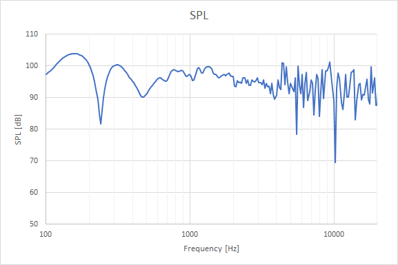

I made a small tool (excel-sheet) to help myself grasp some things regarding line arrays and thought that maybe someone else could use it as well.
It assumes discrete (monopole) sources and lets you play with
So if we set the following:
and if we increase distance to 4 m:
a reduction of 12 dB (as expected). Let's add floor and ceiling reflections (2.4 m room height, mic at 1 m above floor):
Looks like a normal indoor measurement of a low directivity speaker.
How about a 10 driver array with 0.1 m spacing with centre 0.8 m above the floor:
How about a floor-to-ceiling array with 25 drivers (9.5 cm spacing):
Follows the theoretical -3dB/octave line up to about 3.5 kHz.
And if we increase distance to 8 m:
a reduction of 3 dB (as expected). Follows the theoretical line up to about 5 kHz.
It's a simple tool, but helped me understand line arrays better. I hope someone else will find it useful. It's attached as "line array calc v1.mp4", just rename it to *.zip and and unzip.
If you find any errors, please tell me! Or if you have any suggestions on how to improve it. I'm trying to figure out how to add directivity to each driver
/Anton

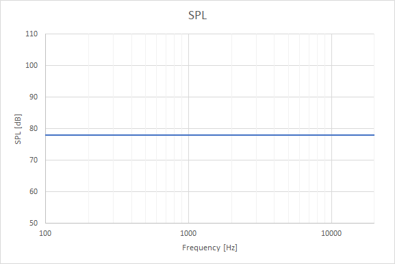

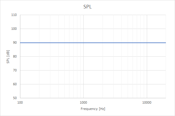

- 1 driver
- 1 m distance to mic
- no reflections
- 90 dB output

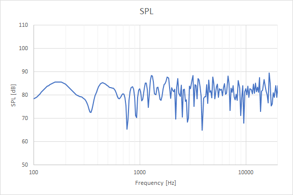

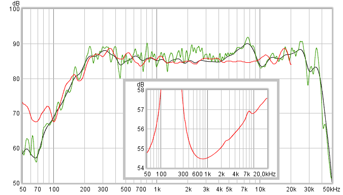

Great tool! It even shows the 7khz dip I am measuring with a floor to ceiling LA using the SB65WBAC25-4 at 66mm spacing.

I can confirm this behaviour for my arrays. If I stand up, the perceived stage moves up with me. It's a bit weird the first time. No changes in the perceived tonal balance..
That is the nicest thing with arrays, and used in nearfield. I hate when the tonal balance change when i stand up, i never hear such tonal changes when listening to live music and where listening distance is much larger then at home

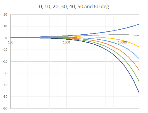

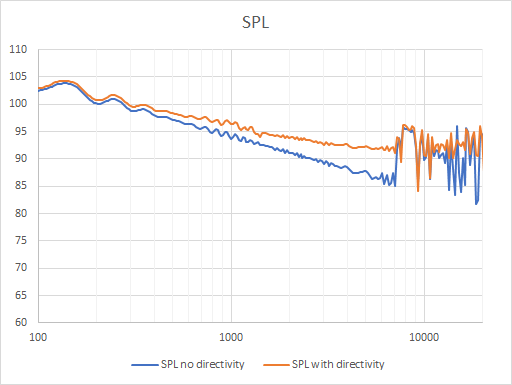

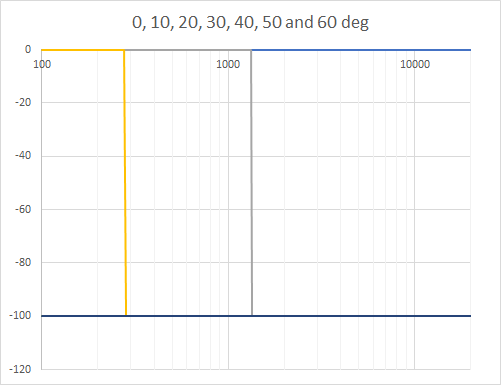

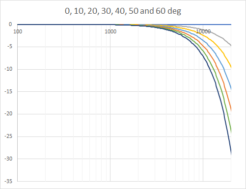

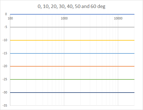

Directivity modelling
Directivity is modeled by a frequency dependent response as function of off-axis angle. So on axis the frequency response is typically 0 dB from 100-20000 Hz. The at increasing angles the response decreases. You can either make your own curves in the Directivity tab (0-90 deg) or use the included assumption that the curves can be described using the formula:
on_axis_response-separation*(frequency/max_frequency)^slope*off_axis_angle
with this formula you can get
- constant directivity by setting slope = 0
- something resembling normal tweeter behavior by setting slope = ~1 and appropriate separation (0.5?)
Input it
- separation, which sets the separation between lines at 20 kHz multiplied by angle (so separation = 1 gives -45 dB at 45 deg).
- slope, which sets shape of curve
On-axis response
I also added a simple way to choose an on-axis response to counteract the downward slope with the formula
(frequency/max_frequency)^slope_0deg*elev_20
where
slope_0deg sets the shape of the curve and elev_20 sets hos much output is increased at 20 kHz.
Note that increasing on-axis output also increases off-axis output.

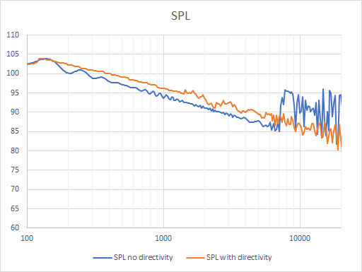

Examples

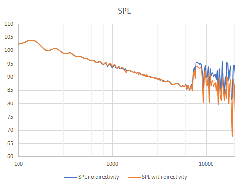

With FTC-array of 42 drivers at 4 m and parameters slope = 2 and separation = 0.5:
No huge difference to monopole behavior.

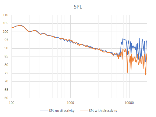

What if we increase directivity (waveguide?) and set parameters slope = 1 and separation = 1:
Looks a little better, more even response above 7 kHz (less to fix with DSP).
What if we add that output increases with frequency by setting slope_0deg =0.6 and elev_20 = 12 dB:
Note that all curves are modified.
Not bad! (Note also that the "Without directivity"-curve is unaffected).

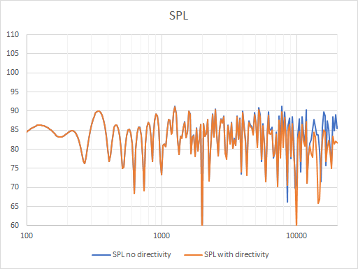

Let's take it to the extreme, what if we magically can make an array where the directivity only allows positive summing. So that when the off-axis angle causes negative summation (phase angle of more than 90 deg) the output drops to -100 dB:
Increased output all the way and a lot more even frequency response 😀 Not possible to physically make though 🙁
File
The spread-sheet is attached, just rename to *.zip and unpack.
/Anton

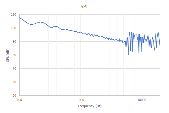

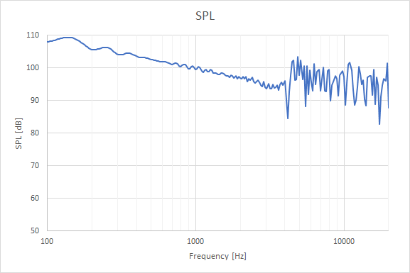

Error for "bottom driver" in last excel-sheet
I found an error in the excel-sheet in the previous post. It only affected the "bottom driver" so long array behavior was almost unaffected. But when I tried simulating a single driver the error became apparent. Attached is an updated version.
I was experimenting with constant directivity vs traditional speakers. A highly directional constant directivity speaker seems to behave well:
Compared to a traditional (non-directional up to a few kHz and then narrowing):
Might be quite difficult to achieve that level of directivity though.
/Anton

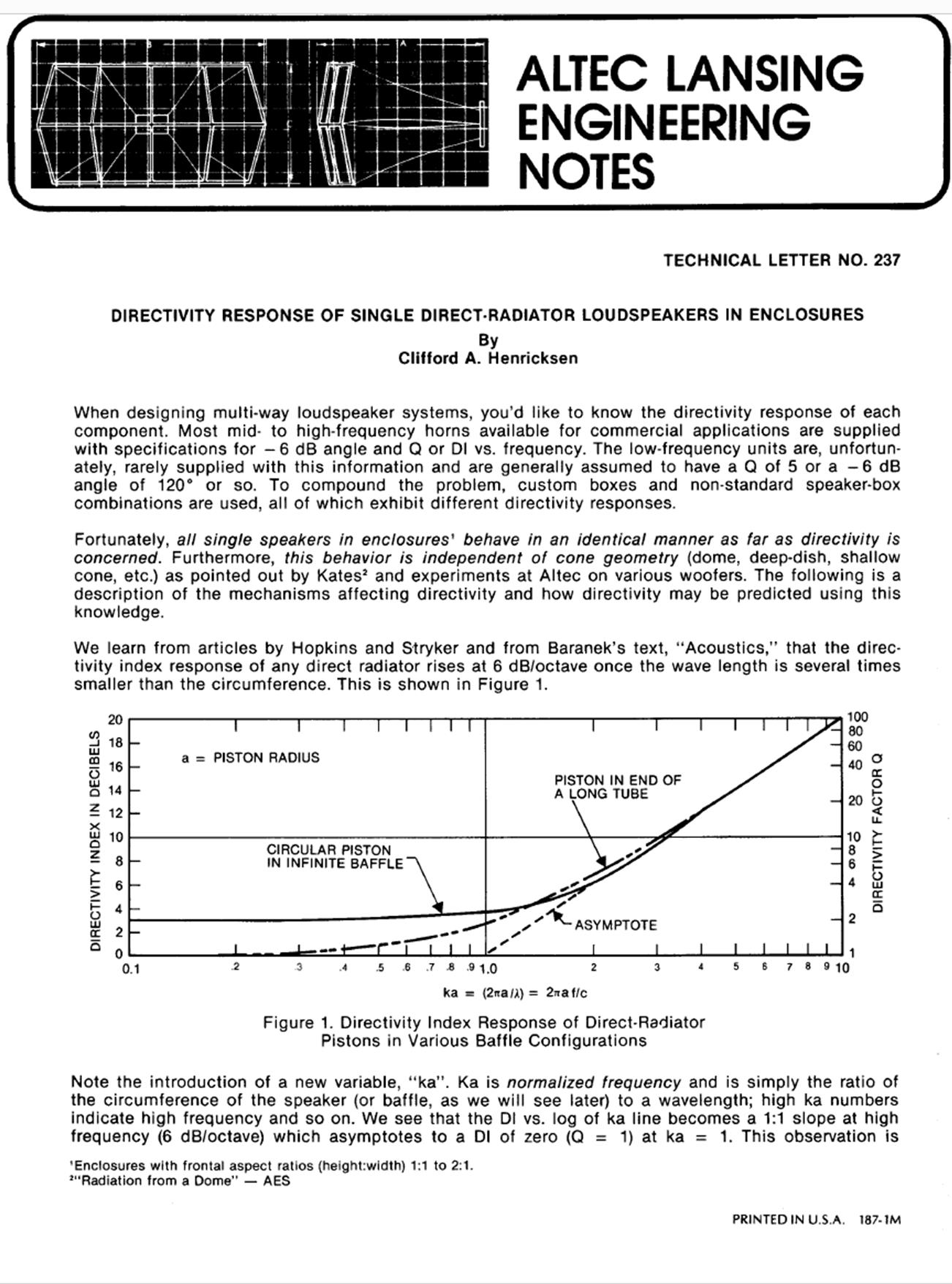

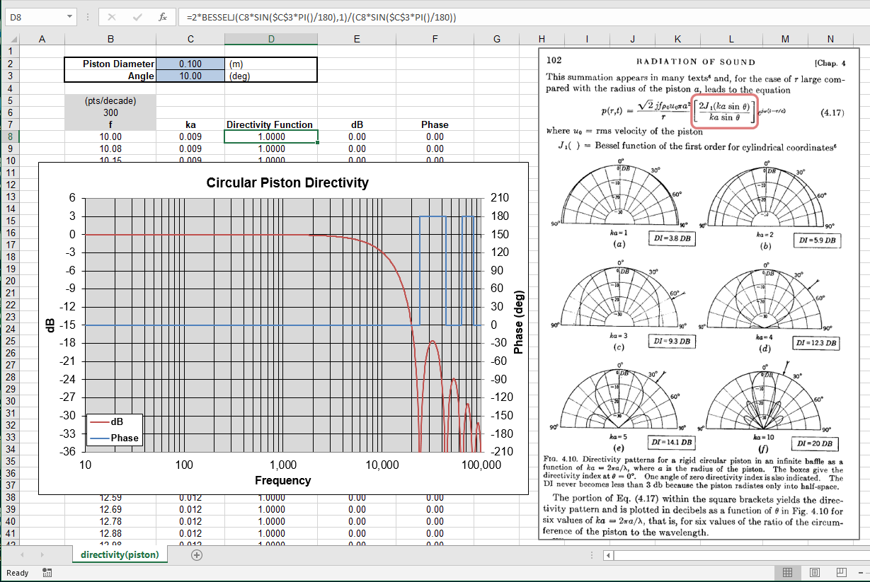

Hi Onni:
I love this spreadsheet. Its very timely as I'm building/experimenting with line arrays now. You might find it interesting to compare your results with those produced in Vituix, which can also model line arrays taking driver directivity into account, although with fewer maximum drivers.
A suggestion re' directivity: it would be "nice" to just enter a piston diameter and then have you compute the directivity roll off from that.
Thanks for doing this.
Jack
Jack

Good suggestion, not sure how to do it though... Is there an easy formula?
/Anton

a little more than a formula perhaps, but not that much more:
Great that it is appreciated 🙂
/Anton
member InOtIn share a spreadsheet here: https://www.diyaudio.com/forums/mul...ctivity-dispersion-beamwidth.html#post4656518
The directivity equation for a circular piston uses Bessel functions, which fortunately Excel has as a built in intrinsic function.... Is there an easy formula?
In the attached screen grab, you can see the required equation in the Excel formula bar.
Note that the polarity inverts at each off-axis lobe as you go up in frequency
The spreadsheet is also attached in *.zip file for those who happen to have Excel and want to play around.
The “ka” parameter is the ratio of the piston circumference to the wavelength.
ka = (2*pi*f/c) * (d/2) = (pi*d) / (c/f)
where:
f = frequency (hz)
c = speed of sound = 343 (m/s)
d = diameter of piston (m)
