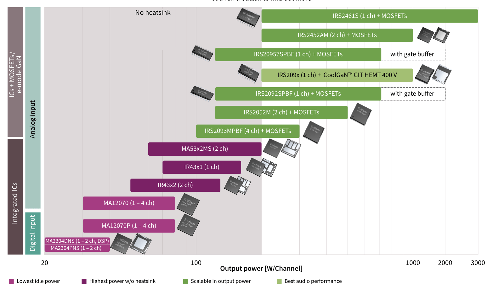

Also changed to MA5332MS. A bit more sturdy compared to MA12070 I hope. IC is less developed and slightly more noisy so the wait is for new multilevel class D chips. There are some new versions but these have no analog inputs. Possibly Infineon and their main customers see digital inputs as the way to go. Truely skips DACs, opamps, coupling caps, DC servos and transformers too 🙂

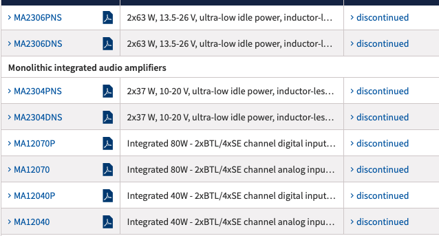

The 2 x 63W MA2306xxx (datasheet February 2024) are already discontinued just like MA2304xxx, MA12070x and MA12040x. In short all multilevel class D chips by Infineon are discontinued. Mmmm...real pity! Maybe they abandoned low power multilevel class D chip technology in favor of the higher power MA5332MS etc. as discontinuing new ICs after only a few months is odd.
Instant TDA1541A status for MA12070 🙂

Possibly because they subjectively don't sound a good as the multilevel* class D chips and one also does not need the ridiculous output power. Another reason could be that these are not integrated solutions but have a need for many external parts. Large board area, hard to obtain MOSFETs, complexity, choices to make, higher costs....
*Do you want a sophisticated low noise fine sounding maximum of 2 Watts (that is very loud) flowing through the speakers or a device with higher noise, higher costs and able to deliver 200W that you'll never use?
