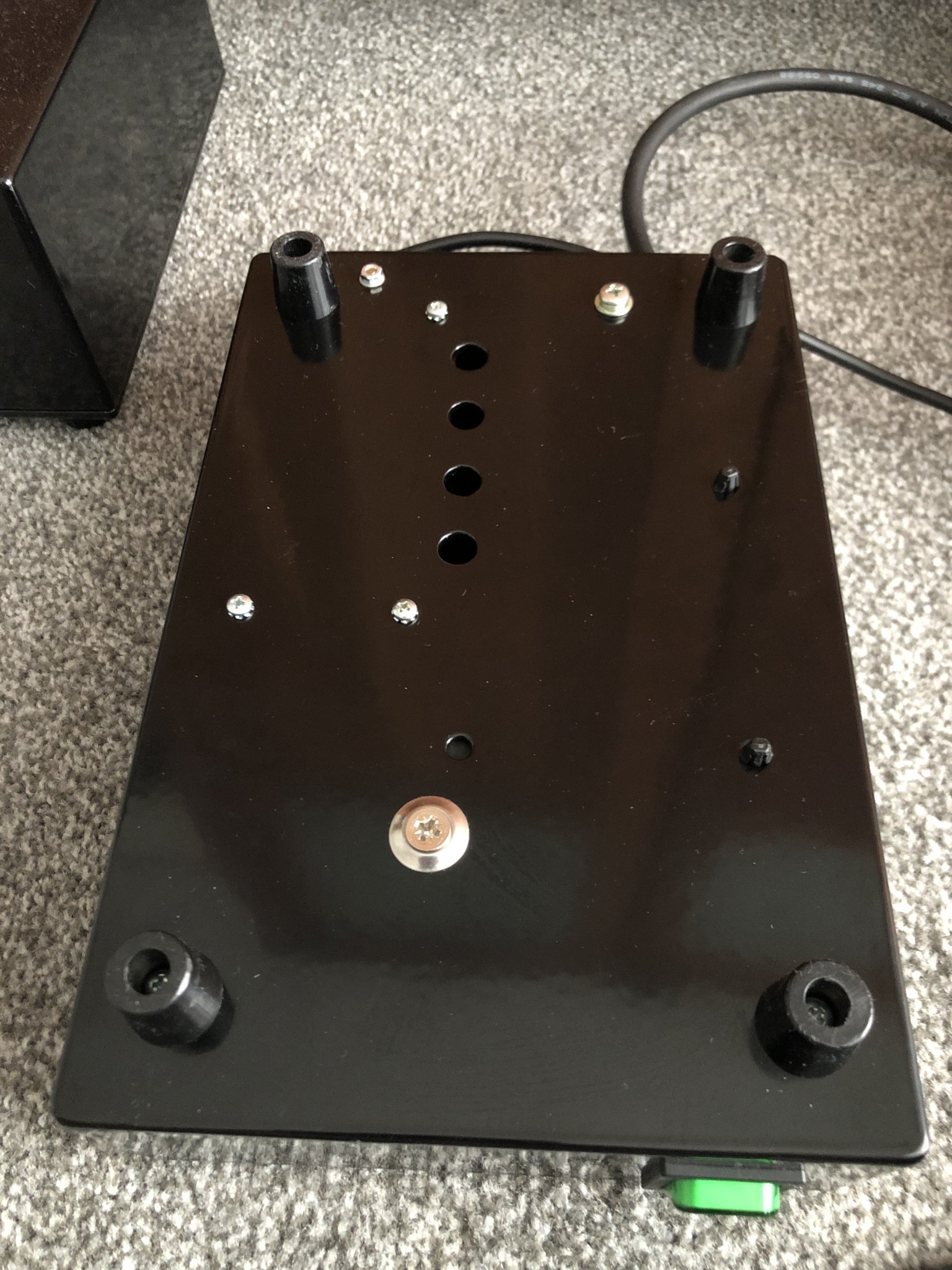

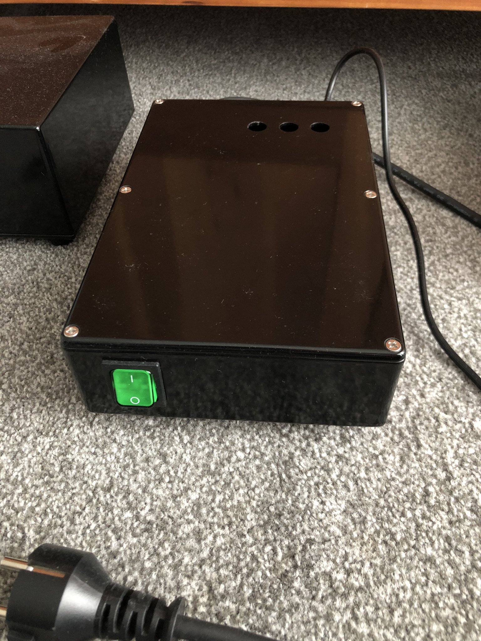

Btw, any thoughts about trying D class with linear power supply ?
Made a final one (well, a few) but haven’t tried this particular one yet. Based on a 5.6A toroid, a LT4320 rectifier, 15000 uF cap and LT1084. The test version was already better than the switcher.

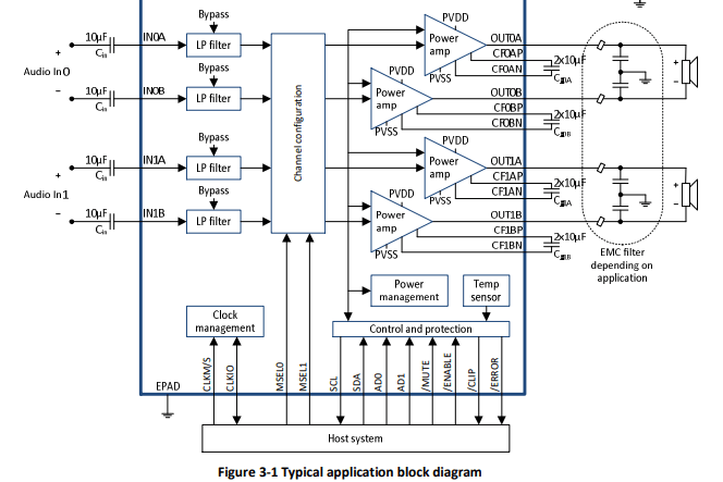

On the poard with the yellow RCA and copper coils + dual ma12070, vol + LF/HF adjustment, the voltage before the 7805 is 12 Volts.
That 12 volt go also to ne5532 opamps. They have 6 volts DC out. That 6V DC goes to blocking caps. It is 1.4 Volts DC on ma12070signal inputs.

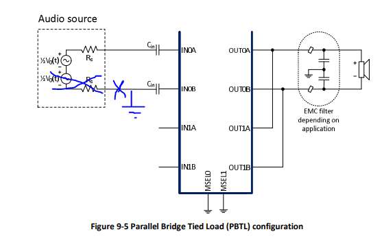

To me it looks like the ma12070 is only driven on one input. So no differential. Thats a pity. I would also prefer diff. But I need the volume pot.
YES...
That's why you have to remove the input resistors...And wire them symmetrically...
You absolutely have to bypass the input stage!👍
It would have been surprising if with RCA inputs... that the amp was driven in balanced mode... 😂
Unlike the tpa chip, there is no OP amp systematically to balance the signal.
The MA chip seems to adapt if in- is to ground = unbalanced mode.
Yes but since there is 1.4V DC on the inputs of the chips, they can't be grounded. (on this amp) There must be a cap and prefferably a resistor in series between in- and ground.

Guess you get 26 dB gain driven balanced, but also 3 dB more output noice. (If source are main noise source)

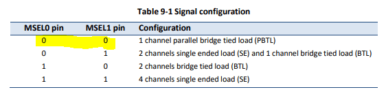

Would like to see some measurements. Of course I agree that there are less noise with 26dB gain than 32 dB gain. But is it also less distortion?
Lokking at the documentation somewhere there has to be done some balancing if all the bridges in the chip is used in single ended mode
