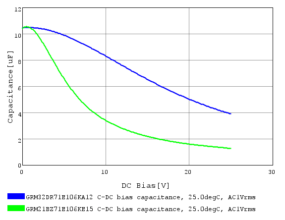

I've also not seen a commercial implementation that follows datahseet recommendations. For example, the flying capacitors are critical in setting the voltage for the various power steps. The datahseet dedicates a few pages to them, so it must be important. The specs are 20uF/25v minimum and the common MLCC size for that is 1206/1210. Every Chinese amp has I've seen has 0806 or smaller caps. I think they are all under specced, except for the Shenzhen Pillor one, which seem to have decent sized MLCCs

Datasheet says to use 10 µF 25V (or higher) for the flying capacitors. The recommended part is GRM21BZ71E106KE15L which is a 10 µF 25V X7R 0805 cap. Some amplifiers have 2 x 10 µF X5R 0805 in parallel to compensate for the capacitance loss with DC bias applied. The minimum value is 4 µF at 0.5 x PVDD. In the first edition of Aiyima A8 these caps made noise, something they solved in the second revision. I use one every day and it is dead silent except when it is supposed to make noise. It also has an IC for the PMP modes FWIW.

I've always questioned why the 0806 GRM21BZ71E106KE15L was recommended. 0805 10uf X7R MLCCs are rare and expensive compared to more common 1206/1210 ones.
I did a sim when I designed my amp and the 0806 capacitance falls significantly (green line) to about 2.5uF @13v (1/2 PVDD), that's why 2 are required to make the minimum 4uF. Just a size up, (1210 - blue line), the performance is much better that you need only one unit.
My concern is the quality of the 0805 capacitors used in Chinese boards, especially when X7R is relatively expensive. Probably X5R substituted, where capacitance peaks at about 80c, and probably only marginally reaching 4uF at 25-30c normal working temps, even when 2 x 10uF are used.

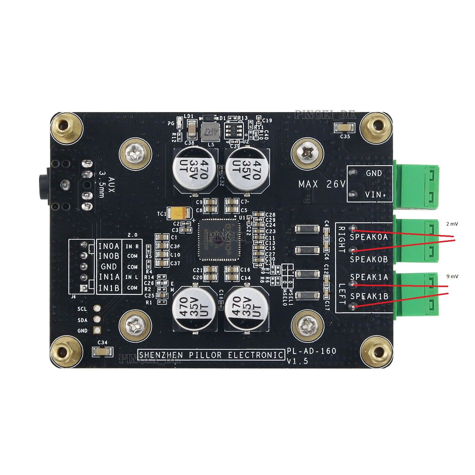

Anybody else have this DC offset?
Yes I switched every L+R I could and speakers output.
Not a big thing just wonder.
Also check if you have one inverted output, I had one but havent double checked it all the way.
Balanced input.

2 and 9 millVolt or 0.002 and 0.009 Volt can be ignored as it can be called zero offset. Probably will be even less with better filtering. I wouldn't even worry till about 20 mV just for the sake of desired "perfection" as even 50 mV won't harm a loudspeaker.
Speak0A and Speak1A should both be + AFAIK. I have the 1.3 so judgement from your 1.5 picture.
