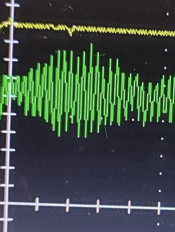

You should probe the frequency of Bluetooth board's BCLK and MCLK. The DAC of the MA12070 is not as versatile as stand alone DACs. Quite a few things need to be set manually.I am giving up on this China Board.
I connected BCLK from the Bluetooth board to the MA12070 BCLK and MCLK.
Still full blast with distortion although music is much more recognisable now.
Slider on zero no sound
Slider on 1of 20 full blast
Android Phone with LDAC Codec.
Once you know what your Bluetooth board is outputting, we can figure out how to set the MA12070's registers. Since you have already attached the ATTiny, it's a few more lines of code.
Why don't you want to split the 5V supply line into two lines - one digital and one analog? It is possible to feed both lines with separate linear power supplies. The consumption of MA12070 is very low.I've made some minor changes to the MA12070 PCB from my experience after building 4 MA12070 digital boards. I've soldered up one analog one, but not tested yet. Here are the gerbers, schematic and BOM if anyone is interested.
But first we need to see some test of your analog version and compere it with brzhifi and tweaked brzhifi
That's a very high sample rate, but valid.While youtube was running I got LRCK = about 184 khz and BCK = about 6,2 Mhz.
My scope does not go below 1micro second, so no MCK reading.
The accurate sample rate of your LRCK is probably 192khz. Close enough to 184khz. And your BCK is 6.144mhz based on the assumption of a 32bit framesize (192khz x 32 = 6.144mhz). 6.144 mhz is a valid MCLK frequency for the MA12070, so you can use your LRCK output to feed MA12070's MCLK as well.
The issue is probably a framesize mismatch. The default framesize is 64 bits per sample but your Bluetooth is outputting 32bits. You need to tell the MA12070 this by adding the additional lines to your ATTiny code.
