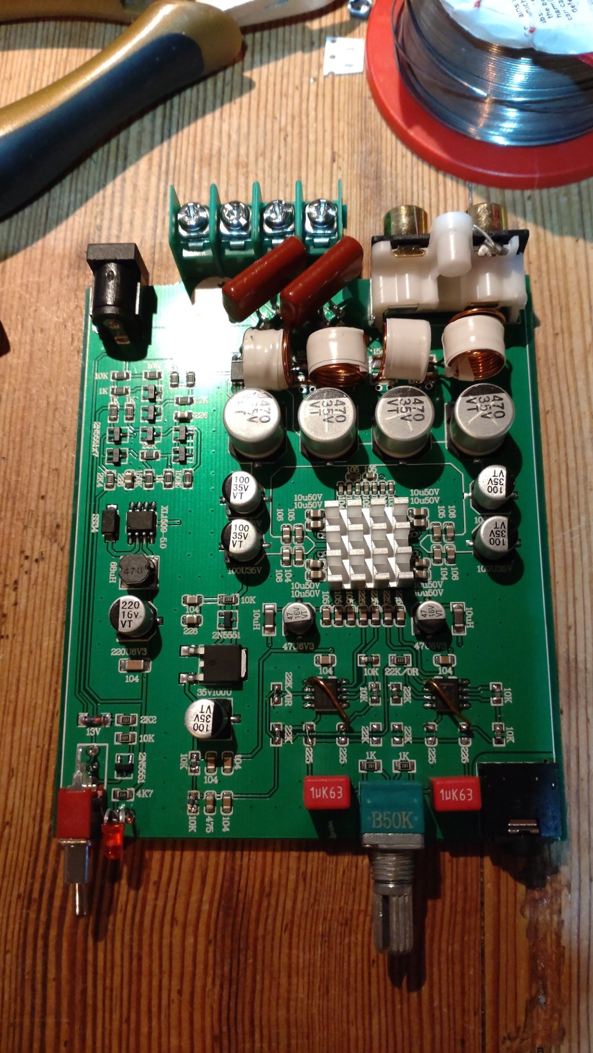

  • If I would first like to not change the op-amps and keep the pot - what would you do?
  • in a second stage, remove the pot all together - what to do then? Losing 10 dB gain no problem - rather, its desired...
Is it possible to short out the pot? The mechanical implications of removing it seems bothersome.
Also, I'm on DSP EQ so a dB here or there, if the quality is still good, don't matter in the end. Using EQ makes pure FR "problems" irrelevant.
I hesitated a bit yesterday as I was ready to dig in to it. I felt I didn't really had a good plan... better not heat up the iron before one do...

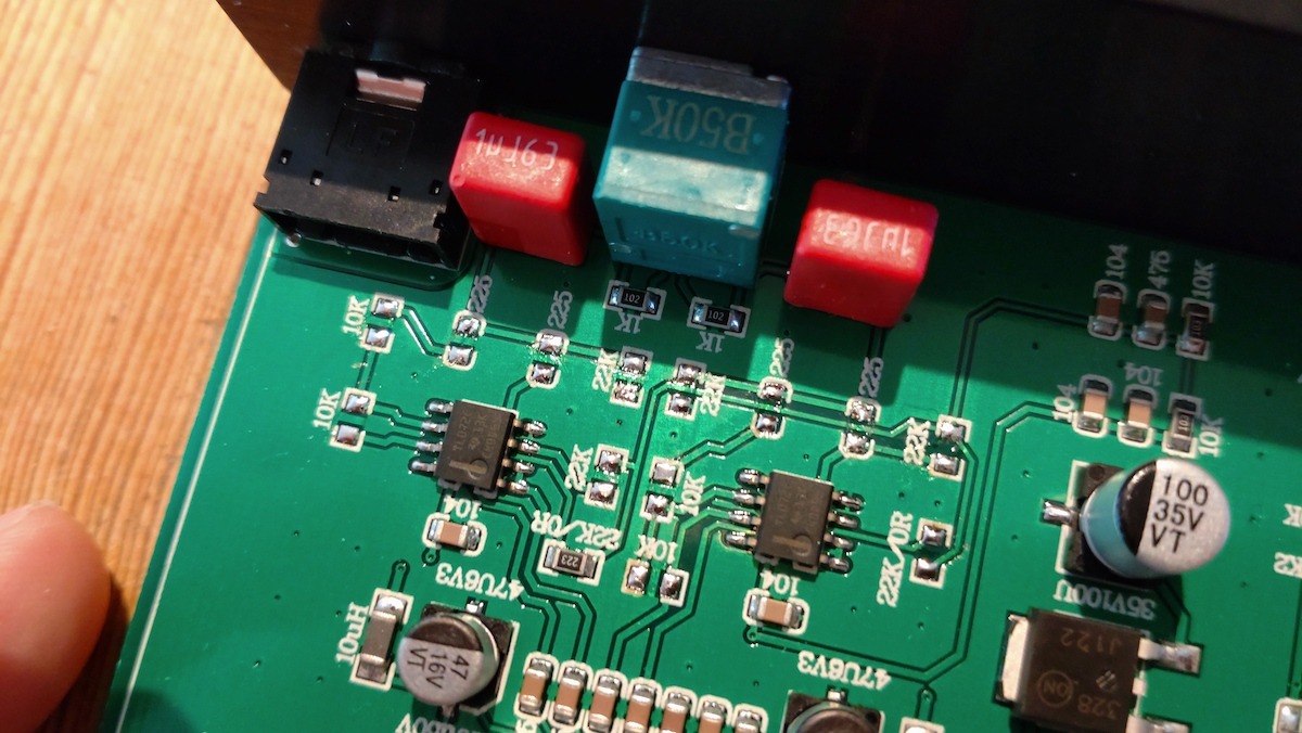

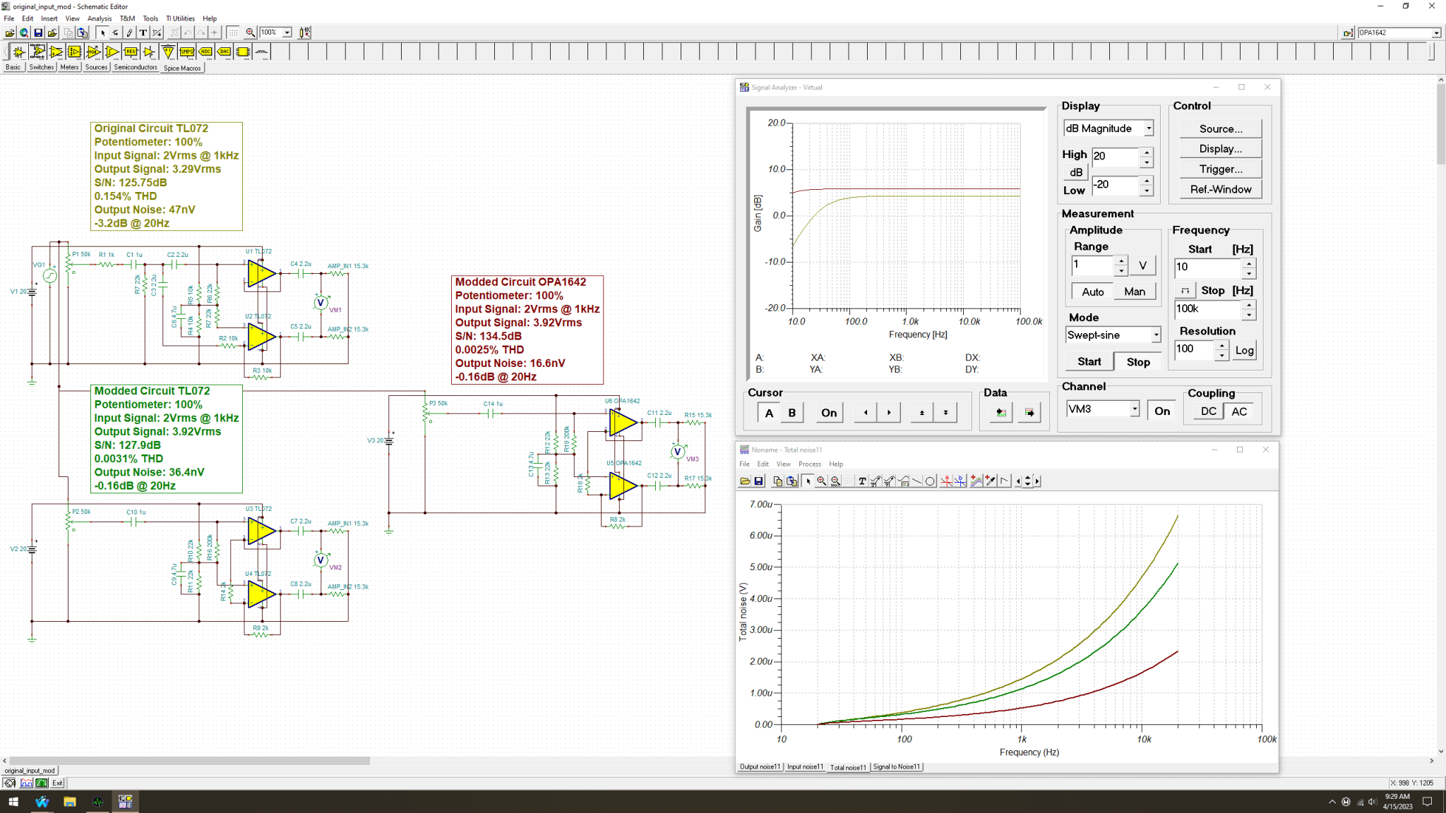

@TNT In the proposed mods picture, do what is shown and also remove the blue 22k resistor and short the 1k resistors near the red input caps. There is no way to bypass the pot without removing it, but that's not a deal breaker. It will act like a linear level control instead of a volume control, which I think is what you're after anyway?
The attached picture shows the original circuit, the proposed mods with TL072, and proposed mods with OPA1642.

I did the mods. Felt good about it. Looked clean except one resistor that wasn't perfectly lined up but measured fine. But.... nope - I heard already when power on without the "hood". I heard a very faint short noise burst every second. AVO on the output confirmed - there was sometime coming out of the amp every second. Not so much so I briefly hooked up one compression driver - there was like a klick every second. Fail.
