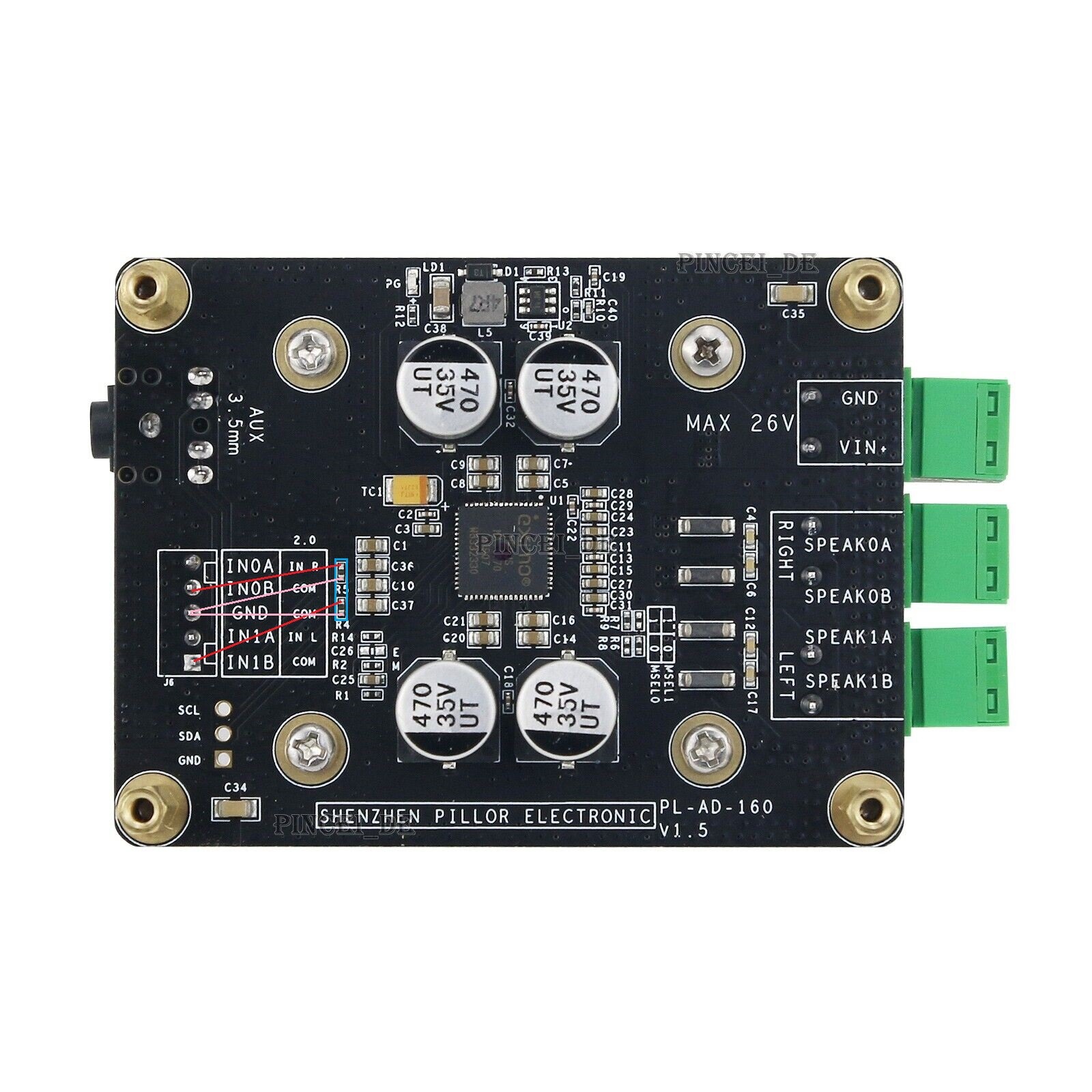

Two questions about the PL-AD-160 board:
  • I see that V1.5 has doubled the electrolytics and added a tantalum cap, probably an improvement (though hard to tell by just looking). But it dropped the switches for changing operating mode. Is it still possible to use V1.5 in a 2.1 configuration? Are those solder jumpers I see?
  • From the MA12070 Application note on output filters, it looks like THD+N can drop by a couple orders of magnitude by using a lower DC resistance ferrite bead, like Murata BLE32PN300SN1L. Has anyone gotten good results with output filter modifications?

Thanks for the 1.5 update/warning. Replacing the mode switch with solder jumpers is big problem for me. Those resistors are super tiny and are going to be a real problem for me to change. From what I can tell you’re correct: The amp is set for 2.0 BTL operation. I need the 1.0 PBTL configuration which means I’ll need to remove the MSEL0 resistor and then re-install it in the other position. I wonder if any vendors are still selling the 1.4 version. Sigh…
I noticed they also removed the I2C address switch and replaced the I2C connector with through holes for soldering.
PS - For 2.1 operation I think you'll need to remove and re-install both resistors to their alternate locations. This would change from the default (1, 0) to the 2.1 mode (0, 1).
I've found vendors with V1.3, as well. No obvious differences from V1.4. I'd risk some delicate soldering if the V1.5 is a better sounding board. But I've looked through this thread and others without finding anything about the differences between V1.4 and V1.5. Another change is they removed the connector with /MUTE and /ENABLE. It sounds like that was a factor in problems another person was having.
From a designer's perspective, I can relate to wanting to remove users' options if too many of them are going to misuse and break things. If there's a switch, people will flip it to see what happens. If you change this board to 2.1 or 4.0 without decoupling caps, bad things will happen. So is V1.5 is about idiot-proofing, or does it also sound better?
The vendor sent me documentation for the Ver. 1.5 PCB which I translated from Chinese to English. They recommend using a 10K resistor even when tying MSEL0 and/or MSEL1 to ground. In my case I'm just going to use a solder bridge to tie it directly to ground. Much simpler (for me) than soldering in a tiny 10K resistor.

The other changes I see in the circuit diagram:
  • /MUTE and /ENABLE now have 5 second and 0.1 second delays at power-on, had been 1/2 second for both.
  • I2C address is fixed at 0x20.
  • Removed clock option for synch with another MA12070
I don't know if anybody already mension this but the PL-AD-160 board don't work with balalanced input if you don't remove R5 and R4.
It's not an resistor just an bridge to GND.😳
I just was confused when I at last bought an DAC with balanced output.
I still need GND, the middle pin to ground to my DAC but now it works without massive noise and hum.

So MSEL0 is already set high and MSEL1 is set low? It's configured BTL but running single-ended unless your remove the bridges and supply an inverted signal?
I dont know about MSEL but sure it just for single ended as default.
Edit:Ofcourse it set to BTL also as default, no switches as the early versions.
